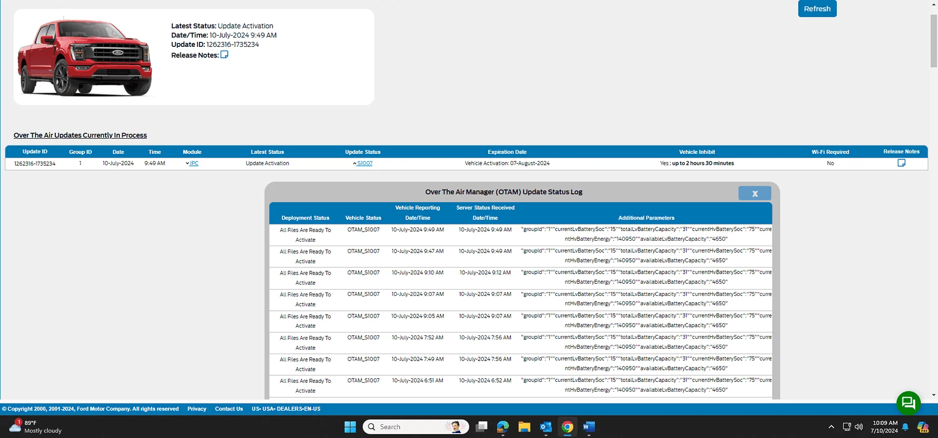

I've been trying to install 6.8.0 for the last almost 24 hours. When it's supposed to be installing, I get this message on fordpass that says, "Update Scheduled, vehicle cannot be driven", but after an hour or so, it still says the same thing. When I get in the truck, it says that Update was postponed due to some other process, or something to that affect. When I manually set a time, it acts like it's going to install but it doesn't. I tried turning truck off, closing doors, setting parking brake. This is very frustrating.

@Lightning Rod I got your message, but am responding here (with your VIN not shown) so the info is out for others as this is the reason most OTA's that require the vehicle to be inhibited fail. The reason the OTA is failing to install is your 12b battery is VERY low. As someone with an upgraded audio system as well, I also upgraded my battery (as opposed to adding another battery).
"groupId":"1""currentLvBatterySoc":"15""totalLvBatteryCapacity":"31""currentHvBatterySoc":"75""currentHvBatteryEnergy":"140950""availableLvBatteryCapacity":"4650"
Ford F-150 Lightning Update 6.8 update problem 1720620615261-xl
I would definitely throw a charger on it. You still have 28 days before the OTA trigger expires unless it gets canceled on the server side, so you have time. I would recommend taking it for a nice 20-30 minute drive, with the a/c speed set on at least 5 as that triggers the system to charge your 12v automatically. As soon as you park it, try to install it manually when the 12v is topped off. Or, put it on a good charger overnight and try to install it in the morning.
Please note that the 1am auto-updates schedule is not recommended. It allows time for the vehicle to sit and the 12v battery to drain by the time the update tries to install.

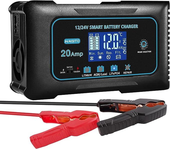

I'm weary of using that old charger that I swore by for decades... I keep having visions of something bad happening to my batteries, so I bought this 20 Amp Lithium "Smart" Battery Charger. Amazon will deliver it overnight. Do you guys this this will work ok? I just don't trust that old charger anymore.
Not familiar with it. I use a clore 2320 20amp. It's $82 on amazon.
