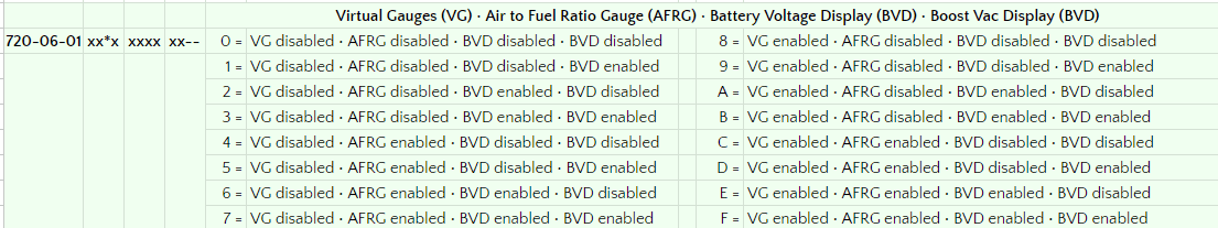

He's not alone. Others have reported getting 6.8.0 and no SoC displays after. Once a truck has 6.8.0, if is it just a matter of config, it should be able to be enabled with FORScan. All I see in the spreadsheet that can possibly pertain to it is this. I'll see what I can find out.

Ok, so what I posted above has nothing to do with the subject at hand. I need the VIN of a Lightning that got the SoC back with 6.8.0 and the VIN of one that got 6.8.0 and did NOT get the SoC displayed.
Edit: Preferably (but not limited to) someone with FORScan. The as-built data we can see from Ford may not be accurate if the IPC has not synced up with the mothership in some time.
