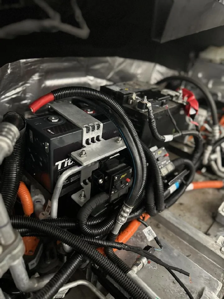

I've been trying to install 6.8.0 for the last almost 24 hours. When it's supposed to be installing, I get this message on fordpass that says, "Update Scheduled, vehicle cannot be driven", but after an hour or so, it still says the same thing. When I get in the truck, it says that Update was postponed due to some other process, or something to that affect. When I manually set a time, it acts like it's going to install but it doesn't. I tried turning truck off, closing doors, setting parking brake. This is very frustrating.

Possibly the LVB isn't up to snuff?
I thought about that after reading through the thread but it looks like that charging it up didn't solve some people's problem either. I also had an extra 12 volt lithium battery added in parallel to accommodate the current draw that my advanced audio system demands. Hopefully they are up-to-snuff, I haven't seen any evidence that the batteries are struggling in any way since being installed about a year ago. I will call the dealer in the morning if I get the same result... it's set to install at 1 AM. Maybe it's that inexpensive battery module that may need replacing that others spoke about.
