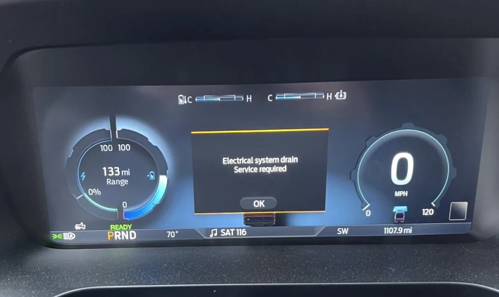

gj00101
Gerald
Jul 7, 2023
Wisconsin
2023 Ford Lightning
Got this message yesterday.
“Electrical System Drain Service Required”

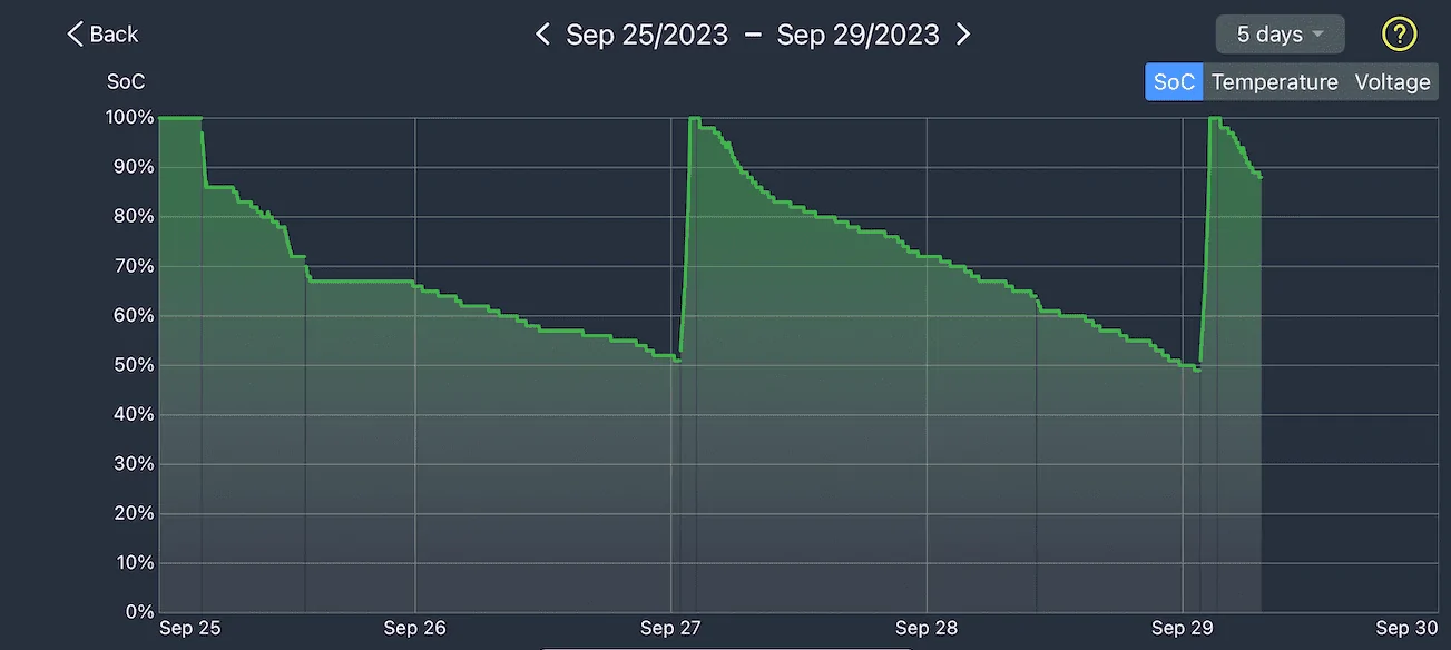

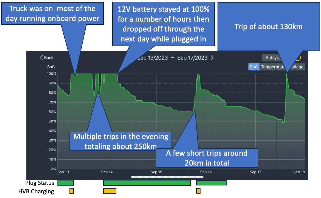

In case anyone is interested, I tracked my 12V battery for several days and I only saw it charge in 2 scenarios:
1) While the truck in "ON"
2) While the HVB is being charged on Level 2 station.
Even with the truck plugged in, the 12V battery would drop once the HVB charge cycle ended. From Sept. 14th-15th the truck was plugged in however the 12v battery drained to 60% in about 30 hours. from Sept. 16th-17th it drained to less than 50% in about 36 hours and it was plugged in for the first 12 hours of that. There was a notable drop right about the time the truck was unplugged.
The graph is from the battery monitor, the Plug and HVB chaging status are from my charge logs in FordPass.
Ford F-150 Lightning UPDATE: Failed 12v Battery.... 1695412517810
What did I learn? If the truck is not used for two days, the 12v Battery will deplete itself to catastrphic levels for the AGM even if plugged in. My next test (when able) I will let the truck sit for 2-3 days plugged in and for 2-3 days not plugged in to see if there is a safety mechanism built into our smart trucks when the 12v AGM drops below 50%. My challenge will be to find 3 days in a row where I won't need the truck so it could take a while for the results.
I concur with those findings.

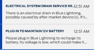

Update to above. My truck has been unplugged for 2 days now. In less than 48 hours, the 12V battery dropped to 50%. I got two messages on my FordPass, and shortly thereafter, the truck charged the 12V battery to full.
Ford F-150 Lightning UPDATE: Failed 12v Battery.... 1695821524617
Some notable items:
1) HVB climbed from 85% (my set charge level) to 86% while not plugged in. Magic power I guess. I expect this is because the truck has shut down modules and it is taking a best guess just before shutting down connected services. It will be interesting to see what it says in the truck when I drive later today.
2) FordPass is not able to connect to the truck. Lock/unlock functions are not working and my last SOC update in FordPass was at the time of the message above. I can only guess that the truck has shut down the associated modules for a long-term deep sleep nap.
So it appears that Ford has some parameters to charge the 12V battery from the HVB when necessary even when unplugged. This is really good news.
The messages could be better, however, it could be that Ford simply hasn't gotten to that part yet, and due to the apparent shutdown of the communications modules, the truck isn't able to send messages until they are reactivated by vehicle entry. If not plugged in, it would be good a message before shutting down to say something like "Your 12-volt accessory battery has low voltage. It will be charged using your HVB and the truck will enter deep sleep mode to preserve energy" - at least then you would know not to expect FordPass to work.
I will try a similar 3-day scenario with it plugged in to see how it reacts.
I hope Ford is keeping an eye on the forums for continuous improvement ;-)
[Edit] One day later, FordPass is still not working. I went out and touched the door to unlock it (PAAK worked). Waited a few minutes and still no FordPass connectivity. I entered the truck and turned on the Accessories and a few seconds later, FordPass lit up. I expect it will stay active until the 12V battery runs down to 50% again.

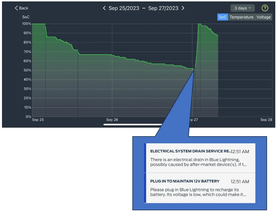

Final Unplugged results:
Ford F-150 Lightning UPDATE: Failed 12v Battery.... 1695990504350
Summary: The truck charges the 12V battery from the HVB when it falls to 50% and goes into deep sleep mode. Once it enters deep sleep mode, the truck will no longer respond to FordPass as I expect it shuts down the modem module among others. The first time it did this after being unplugged, it sent two messages before shutting down the modem.
Ford F-150 Lightning UPDATE: Failed 12v Battery.... 1695990623675
The second time (and I suspect subsequent charges) it did not send any messages but rather just went quietly into deep sleep. I suppose it can keep this up for months (maybe years) with a decent SOC to start with. My charge was set to 85% SOC at the beginning of this test and on the first 12v charge cycle, Fordpass reported 86% after being unplugged for 2 days just before it went into deep sleep. I activated the truck by turning on accessories for a few seconds so Fordpass was active for days 3-4 and after 4 days (just before deep sleep) it reported 85% SOC.
In my case, I get 2 days on the cycle before it enters deep sleep. I'm hoping it is because my 12v AGM is weak and it would normally be 5-7 days with a healthy battery. I also think the "Electrical System Drain Service Required" message is a result of the battery draining faster than expected due to its weak state and not due to an aftermarket device (which I do not have).
Recommendation to Ford: update the messages to indicate the truck is going into deep sleep mode so folks will know Fordpass won't work instead of getting frustrated and blaming it on glitches in the software.
In short: The truck protects the 12v battery. Communication with Fordpass users could be better.
I will try again plugged in when I can and see if the result is the same.
