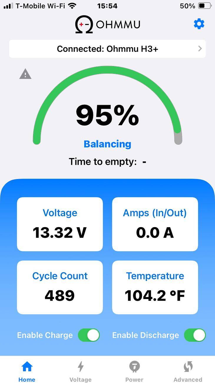

About 4 months ago my OEM LVB was also acting “weird”, particularly with OTA updates. Had it checked at Quick Lane 30% SOC and cranking amps within specs with a suggestion to get a trickle charger. On an $80k truck?? no thanks.
Decided to replace with Ohmmu Li $425, factory batteries were scarce and I wanted something better. They delivered to Florida in a few days and I installed it with a few minor glitches. Flawless performance, OTA installed next try and every try since.
No more “weird” or worry about being stranded.
I don't know about better, but I suppose it's an option.
Personally it's not an alternative for me (in Michigan) as it doesn't offer any real benefits over an AGM battery plus the lack of thermal management means that - best case - it throttles the charging current in the cold (since it doesn't have a heater) and in that case it'll take forever to charge and you're most likely end up with a depleted battery. Worst case, and it doesn't (throttle charging), and you'll end up with a destroyed battery.
