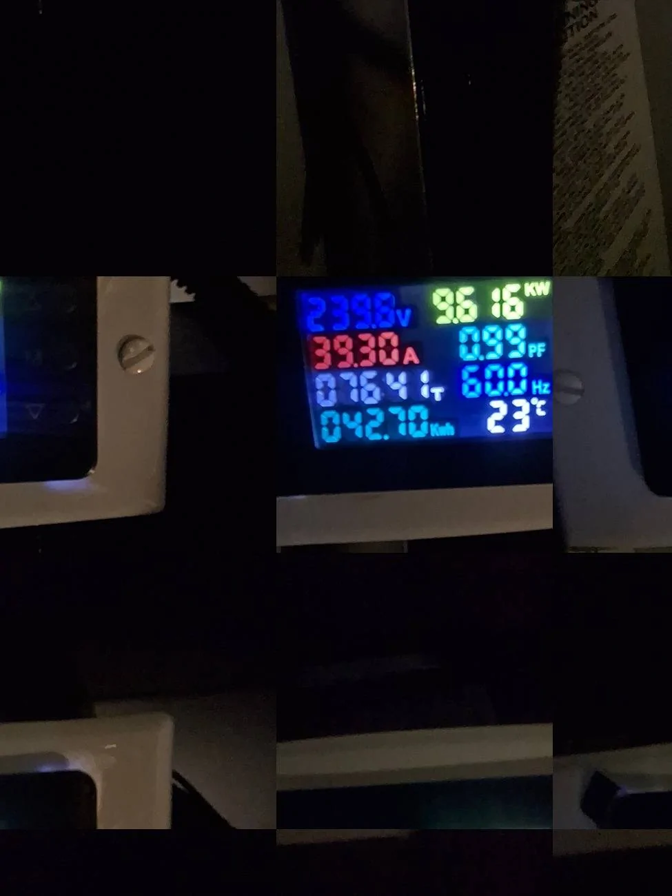

Plumbing Contractor
10 gauge is rated at 30 amps, but not continuously. So you would really need a 8 gauge cord to carry he load and heat.
Plenty of less expensive 8 gauge cords on Amazon and eBay designed for welding extension cords. Once again, a 30 amp breaker draw has to be derated to 80% so set your charger to 24 amps.
My 50 amp setup draws just under 40 amps.

Rick, what am I looking at (your digital display)?
