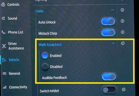

Dealer is wrong. 2024's came with WAL. Go to Settings - Vehicle - Locks, You should see these toggles:
Ford F-150 Lightning Walk away lock after update 1741923247941-3a
FYI - my 2022 only has it because my dealer updated my BCM and I enabled the toggles using FORScan.
Also - you need to update your Account Detail - Vehicles. Doesn't show you own a 2024.

This option has never existed on my truck. I am wondering if they shipped without the correct module

Here are the walk away lock As build
With Audible Feedback option
APIM7D0-09-05xxxxCxxxxx--
Without Audible Feedback Option
APIM7D0-09-05xxxx8xxxxx--

Yes, I updated doors, frunk, and BCM in addition to APIM.

You can disable that with FORScan.
