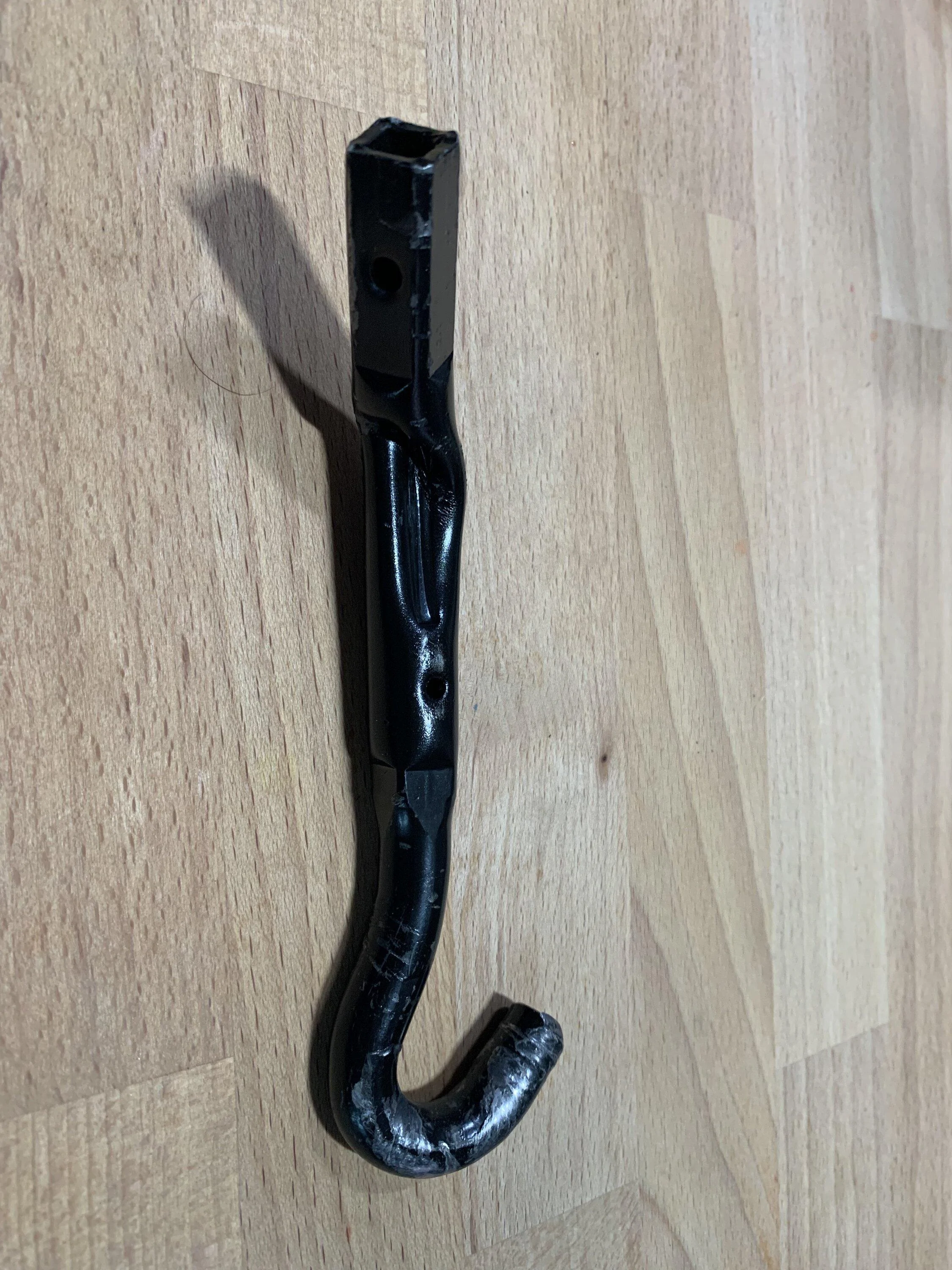

My wife had to change out a flat tire and managed to twist this part of the jack.
No, she is not super human.
Anyone else able to twist this thing?
Thanx,
Jeff

The only thing I will say is that scissor jacks need a LOT of torque at the early part of their travel--i.e. when they are mostly closed. I used to put a 2x6 under mine so that I could lift it farther up, until I bent the hook part on my jack (on a previous Ford). If she did not have the jack more than 1/3 open when it got loaded, then I can understand how she ended up with twisted metal. The mechanical advantage improves dramatically the more the jack is opened.

Mine was bent "out of the box"
Not that badly, but enough for it to be annoying. That whole contraption (crank assy) is a joke.

Result from showing the dealer: Not our problem.
Took the truck to Les Schwab and they gave here a replacement.
We both know the issues with sissor jacks, but still. If it wasn't for a Subaru stopping and sharing a part of their jack, she would still be stuck out there.

She was way up in the forest. Guessing a couple of hours before someone might show up.
Easier to just solve the problem with the tools at hand.
