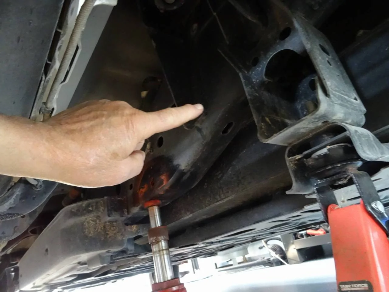

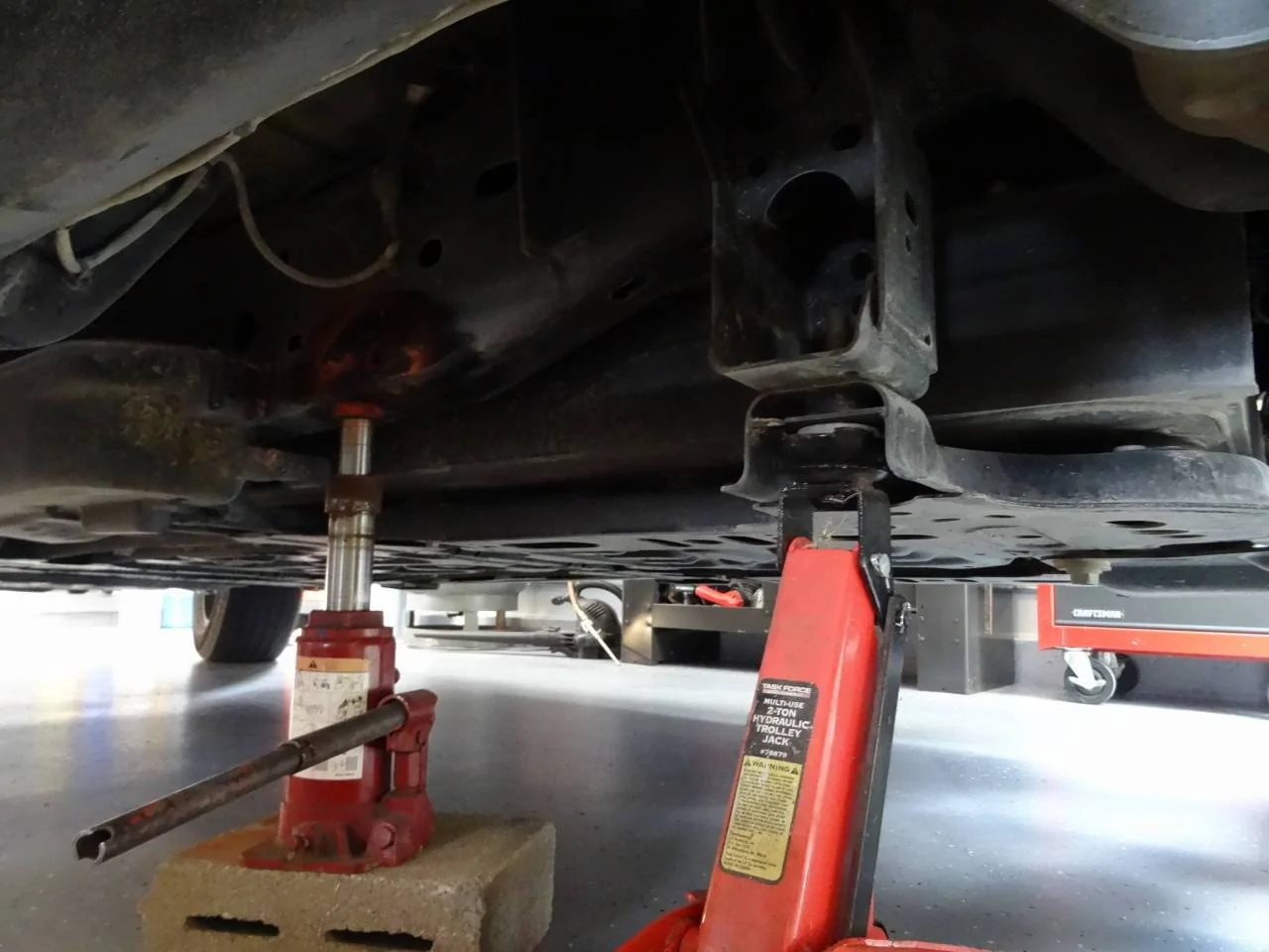

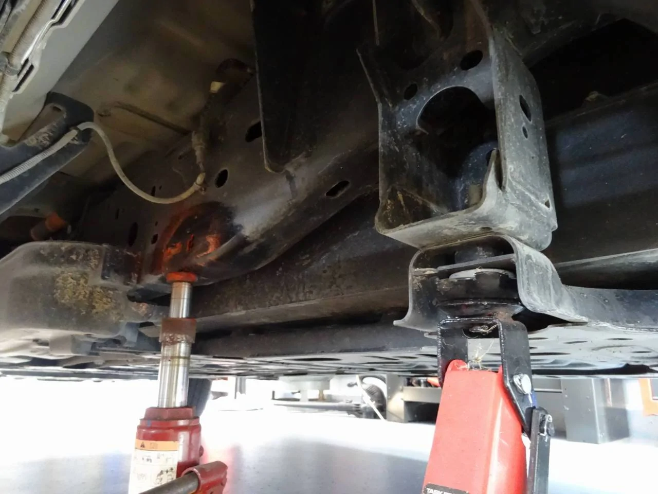

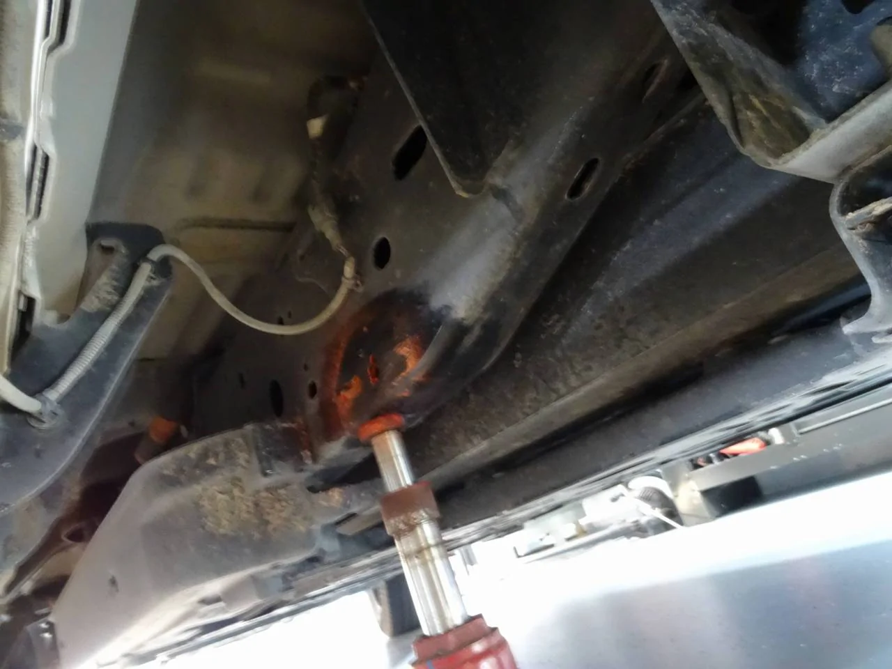

I am not saying this will work but there is a frame member directly connected to the jack point frame member that you might be able to use. I am not a stress analysis engineer so it may not be a good idea considering all the rules about jacking up an electric vehicle. But I think I would try it. I work alone so I never work on a car without some kind of safety block under the vehicle when it is jacked up. I add some kind of safety. It may not work as a 7000lb falling object may go wherever it wants to go, but it is an added safety. See photos. I just changed the two back tires one at a time. My local tire shop charges $15 to mount and balance a tire so I buy used/take off tires. (the orange paint is so that I can find the jack point easier next time)
