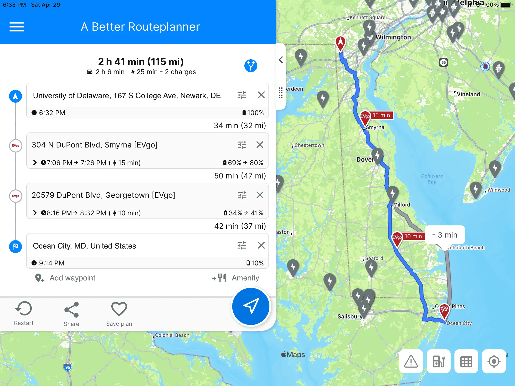

So if I put 1.0 m/kWh into ABRP, it recommends 2 quick stops on the trip down and you end up at 10%. Annoying, but can be done.

Both of those stops, the chargers are broken, apparently they aren’t fixing them either. So I have to make it all in one shot or not at all.
1.0mi/kWh unfortunately won’t cut it. I do have a lot of slower driving and it’s all flat but still very very risky.
