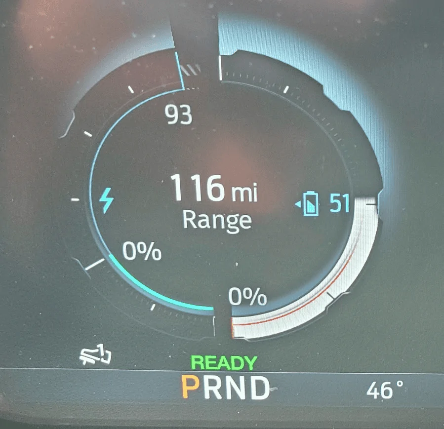

Last week Friday 3/29 afternoon, mine showed 93% motor power when my SOC was 51%

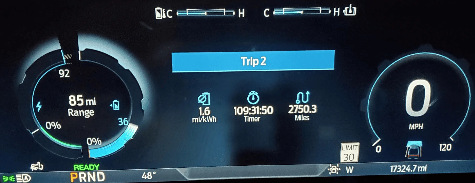

Ford F-150 Lightning What SOC level does the Lightning start limiting throttle? 1712016123611-kl
By Saturday evening it was 92% with the SOC at 38%
Ford F-150 Lightning What SOC level does the Lightning start limiting throttle? 1712015997957-y
