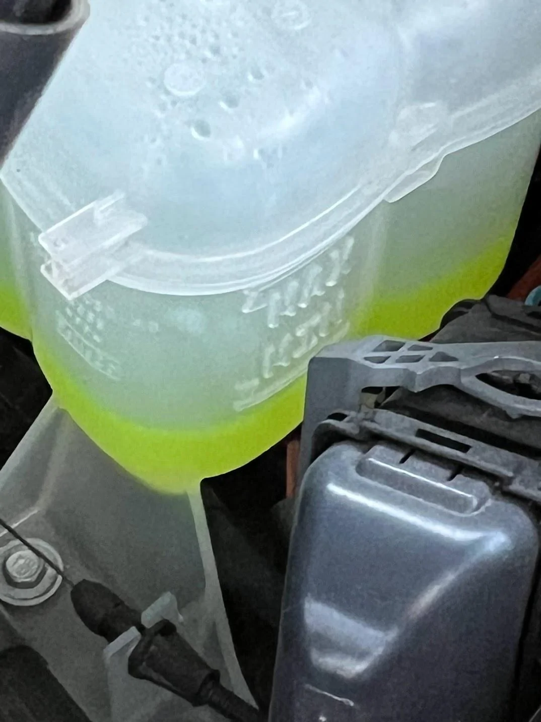

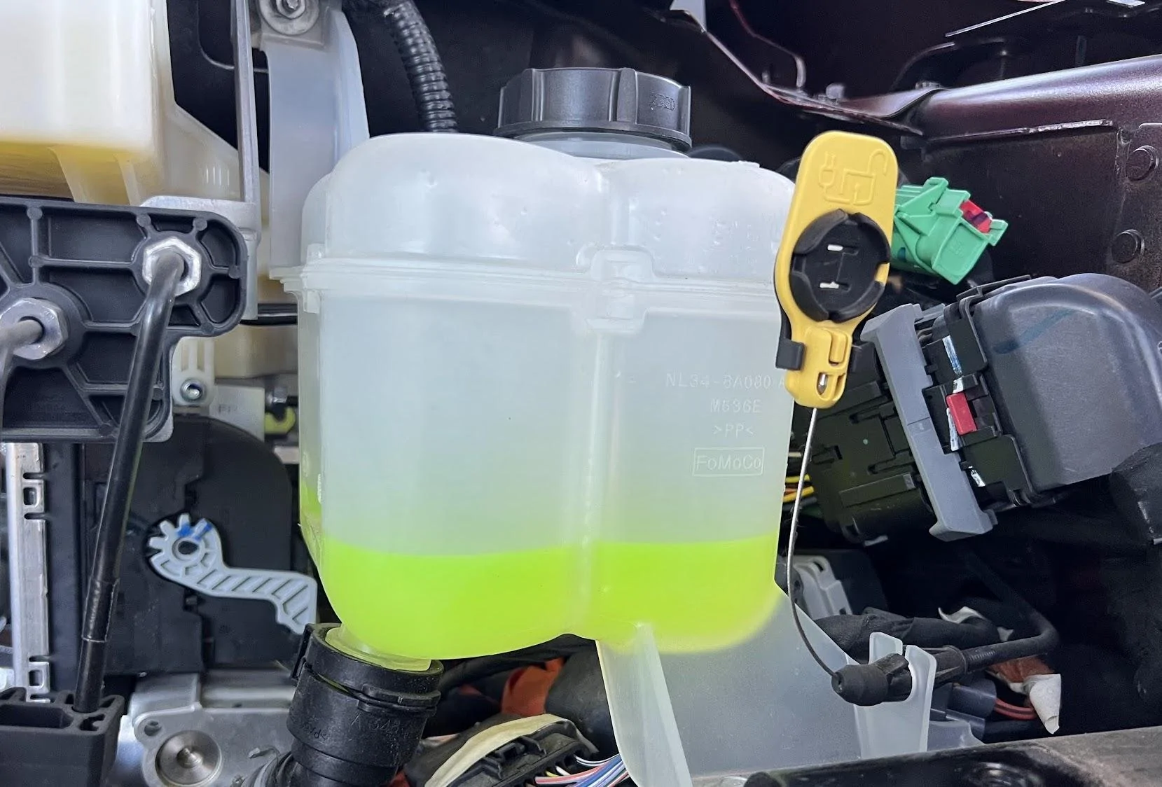

This is what mine looked like around 8,000 miles, a couple hours after a drive around town.
I'm also noticing that I never get 150 kW on DC chargers, let alone 170 kW. 138 kW is the typical max. In case that's related.

Was at my dealer for service on my 10 day old truck and they casually mentioned to me they have a truck that just loses coolant, and they had no idea where it was going. it's waiting on parts. No one would have found it had the guy mark sharpie ticks every day on his reservoir. It just kept going down, they said. And there were no leaks anywhere.
I have the exact same problem, but no solution other than to refill when it gets back down to the min line. First time was at about 2K miles and I now have 5K miles.

i'm guessing evaporation

But why? Is it not a closed system? I know it cools the electric motors and battery.
No i don't believe it is. The batteries get extremely hot. I think Tesla had a similar issue as well.

Mine was delivered new with the coolant at the minimum line. I bought the motorcraft coolant from Amazon and top it off. Now at 1,000 miles, no drop in coolant level.
13,453
14,447
I'm guessing that minor pockets of air in the system are finding a way out of all that plumbing.
That is exactly the answer that the Shop Foreman gave me when I asked about it.

Checked the manual and of course I couldn't find a pic showing the coolant overflow expansion tank location. Not saying it's not there, just that I can't find it. I do see a blue capped reservoir on what I assumed was the windshield wiper fluid tank. Do you have to pull the Frunk panels off? I was shocked to find out this is an open system and I'm supposed to keep an eye on it.
As stated earlier Tesla's are sealed and you can't do anything to them. I typically do my own maintenance and found that Telsa's system requires multiple connections an a computer controlled sequence to drain and refill. Not a stopcock and a bucket. But I was lucky and never had a coolant related problem.
It’s kind of hard to miss near the driver’s side frunk strut, kind of inside/behind the charging port. While looking there, notice the emergency CCS lock release that stores on the side of the expansion reservoir.

Thanks I never noticed the embossed writing. Not sure what else it's saying but I'm about an 8th inch below the low line at least after sitting for a few hours since last drive. No low coolant message though.
Guess I'll stop by the dealer tomorrow to get a top off or just buy a gallon for the future.
Thanks again. Now I'm wondering what else I might be missing.
