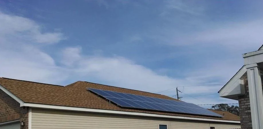

Already have an array on the roof, it's limited to 6kW by regulations for grid tied systems on residential applications in my area or else I'd have my entire roof covered.
Perhaps I'll add more panels and a power wall or 2 later on when the cost comes down.
