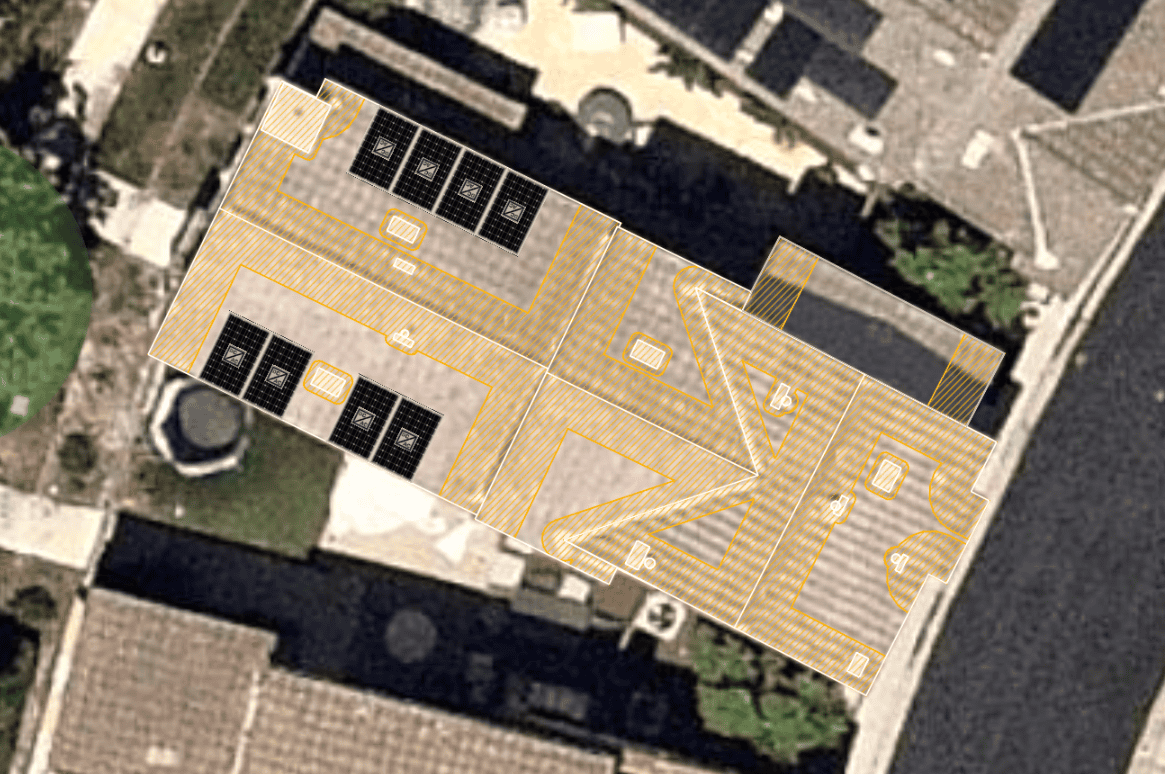

Thank you for these important points!
You are correct about the door to door sales people that are really just commissioned sales people who don't know much about anything except to sell.
SunRun at Costco told me the same sales pitch - they don't have a clue and their service is awful as of recent.
My neighbor just got 26 LG panels installed by SunLux and he loves it - chose to finance at 0.9% for 20 years!
6 months later, can't get the panels nor finance rate!
Looking around for efficient panels with low degradation per year is tough as most "bottom feeder" solar companies either want to sell you junky panels at a premium or more panels than you need.
My latest inquiry was awful - they are the utility company's main contractor and the said only 8 panels would fit based on 3ft spacing fire code? How come my next door neighbor you can see way more panels than 8 and we have the same roof / architecture.
Quite disheartened now...
Ford F-150 Lightning Who is installing solar as part of their Lightning purchase? 20220621013513000000image (3107) (1)

I would check with someone else. I *think* the code maybe 3ft along the edges of the roof, NOT the roofline(ridge). Thats what it is in NY. You see many installations with the top panels nearly up flush with the ridgeline. (Again I do not know the codes in California, they may be different than NY).
Even if the above light "area" is legit..I could see at least 4 more panels by placing the top panels sideways.

Yes you are correct - the installer is using an old building code and wrong distances.
Apparently updated the code for 18" distance in my county/city.
I received some good advice on Salar Panel Talk forum: https://www.solarpaneltalk.com
