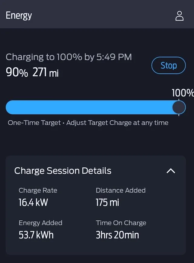

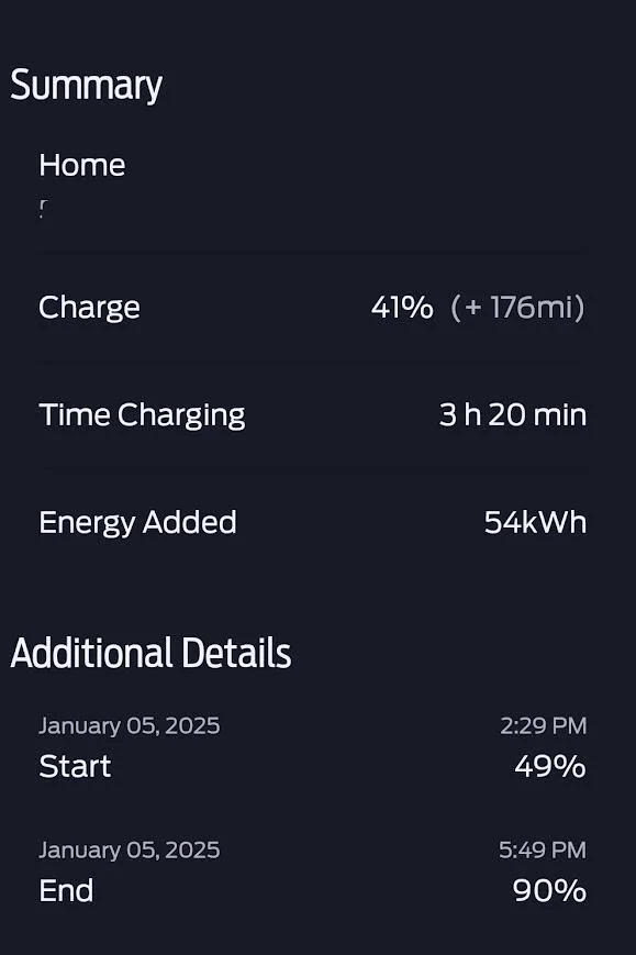

Yesterday I did my weekly charging routine, the SOC was at 49% with a predicted remaining range of 99 miles, the 100% interpolation of that is 202 miles at a current chilly 33°, the horrible 1.1 MPK is due to unplugged climate remote starts and using generous cabin heating.
After the charging was completed back to 90% the predicted range in the same if not colder outside temperatures was 271 miles, imputing a 301 miles range at 100%. The 3 hours and 20 minutes on the charger consumed 59 kWh (GROSS) of energy from the grid netting 54 kWH of traction energy.
This morning the truck was remote started for 15 minutes, driven ~5 miles and with overnight cold soaking at 20°, as it sits right now in 27° weather unplugged, the range potential diminished to 241 miles, the loss is because of cooling pack and anticipated heating demands.
I'd rather have realistic values then smoke & mirrors.
This is incredibly helpful information and it actually does make sense the way you articulate it, thank you!!!
I can probably get used to using Ford’s displayed miles estimate as what is realistically able to still be driven before 0%.
