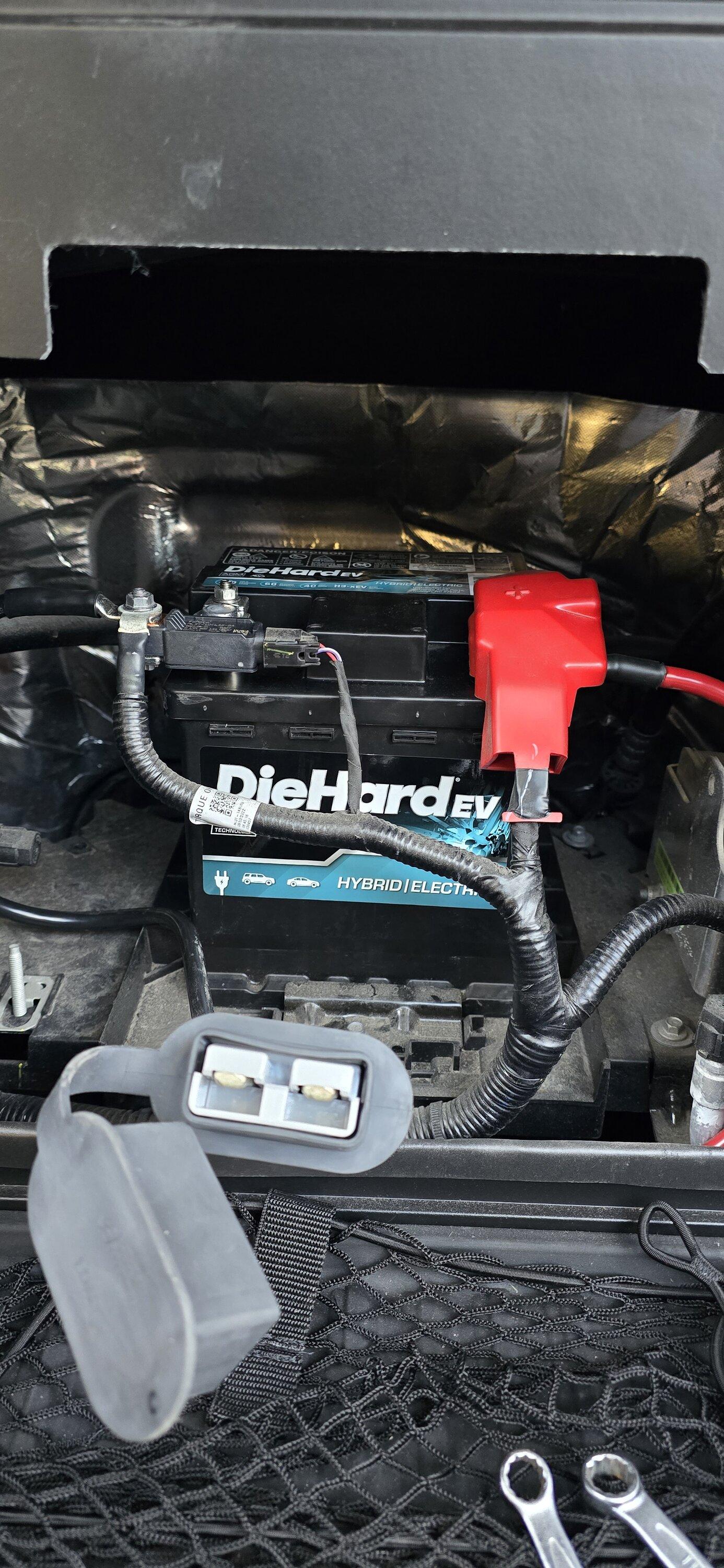

I replaced my BMS sensor today and because my 12V battery have been "weird" the last couple of weeks I decided to replace that as well.
I opted for the diehard version over OEM:
https://shop.advanceautoparts.com/p...-ca-60-min-reserve-capacity-h3-xev/50001096-p
It's a drop in replacement (size wise) and doesn't require any modifications.
A larger battery will not fit without pulling out the trusty ol' dremmel and with the truck being calibrated to a 35Ah battery I'm not sure a larger one will do you any good in the end, which is why I figured the 40Ah Diehard would be within "margin of error" (but we'll see...)
While I was at it I also added a 120A DC plug to make life easier when doing software updates.

Can you elaborate on the need for the DC plug when doing OTA updates? Question due to ignorance on my part.

No need for the plug if you rely on OTA only, it's for when you're doing FDRS updates on your own and need to supply external power during the process.
