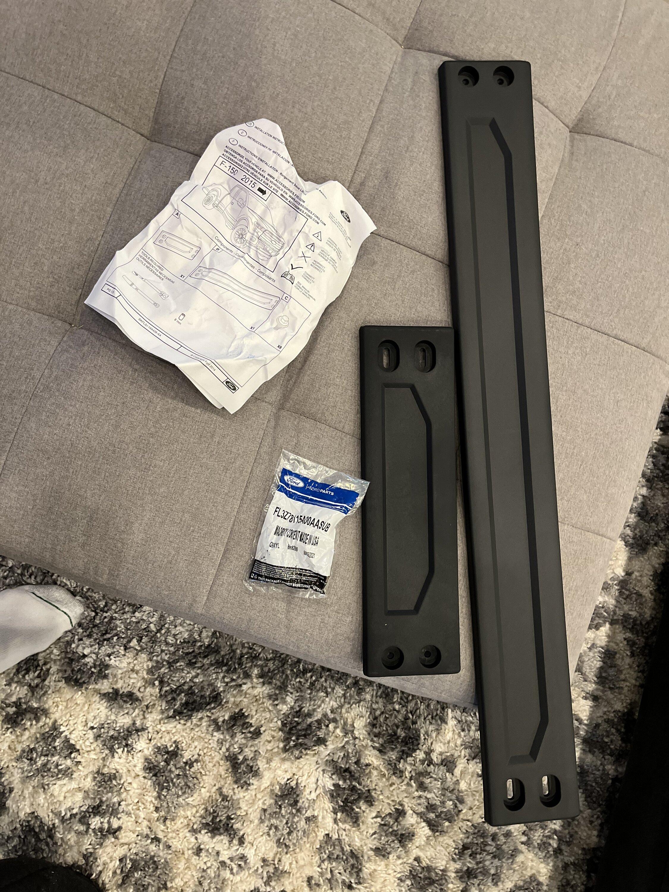

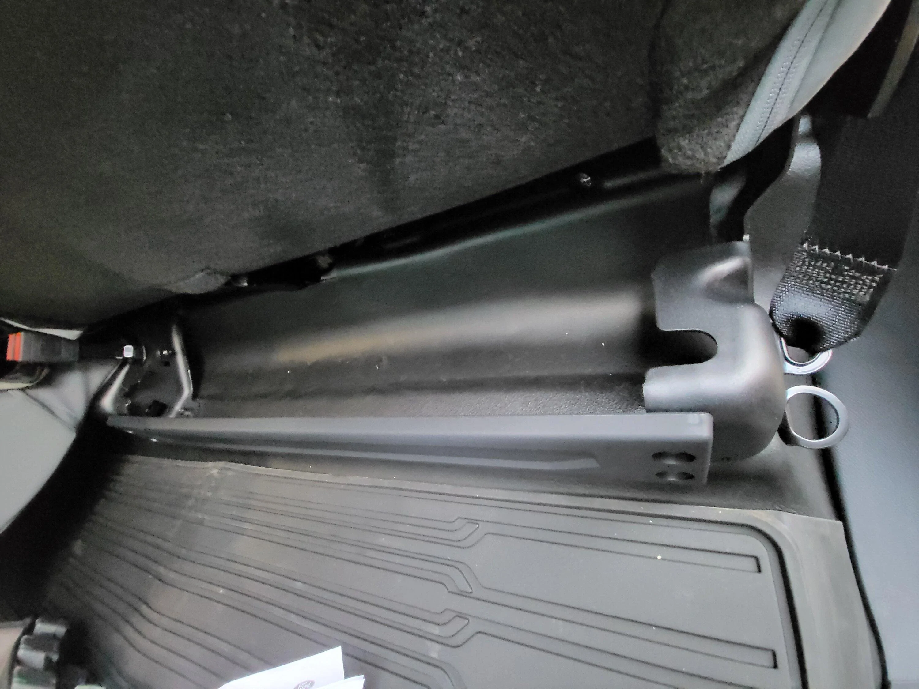

I also picked these storage bars up at the dealer yesterday. Fun fact, the bracket location under the smaller rear seat is different in my PRO vs the Wife’s XLT. So while the long bar fit fine, the holes don’t line up for the small side.
I did check the part number and it’s correct per the Ford website. I will have to figure that out today
Ford F-150 Lightning 🙋‍♂️ What Did You Do To Your Lightning Today? 48235B69-D73F-4965-9621-907F5CB50D18
If anyone else has put these on a PRO and they fit just fine or figured out how to make them fit, I would love to hear about it.

Didn't use it for my Lightning, but in previous F-150s a piece of 1x6 (or a decking board) worked just fine. Holes can be wherever you want them to be! ;)

Yeah. I saw someone posted here about that. May have been you. But with FordPass points, I figured why not

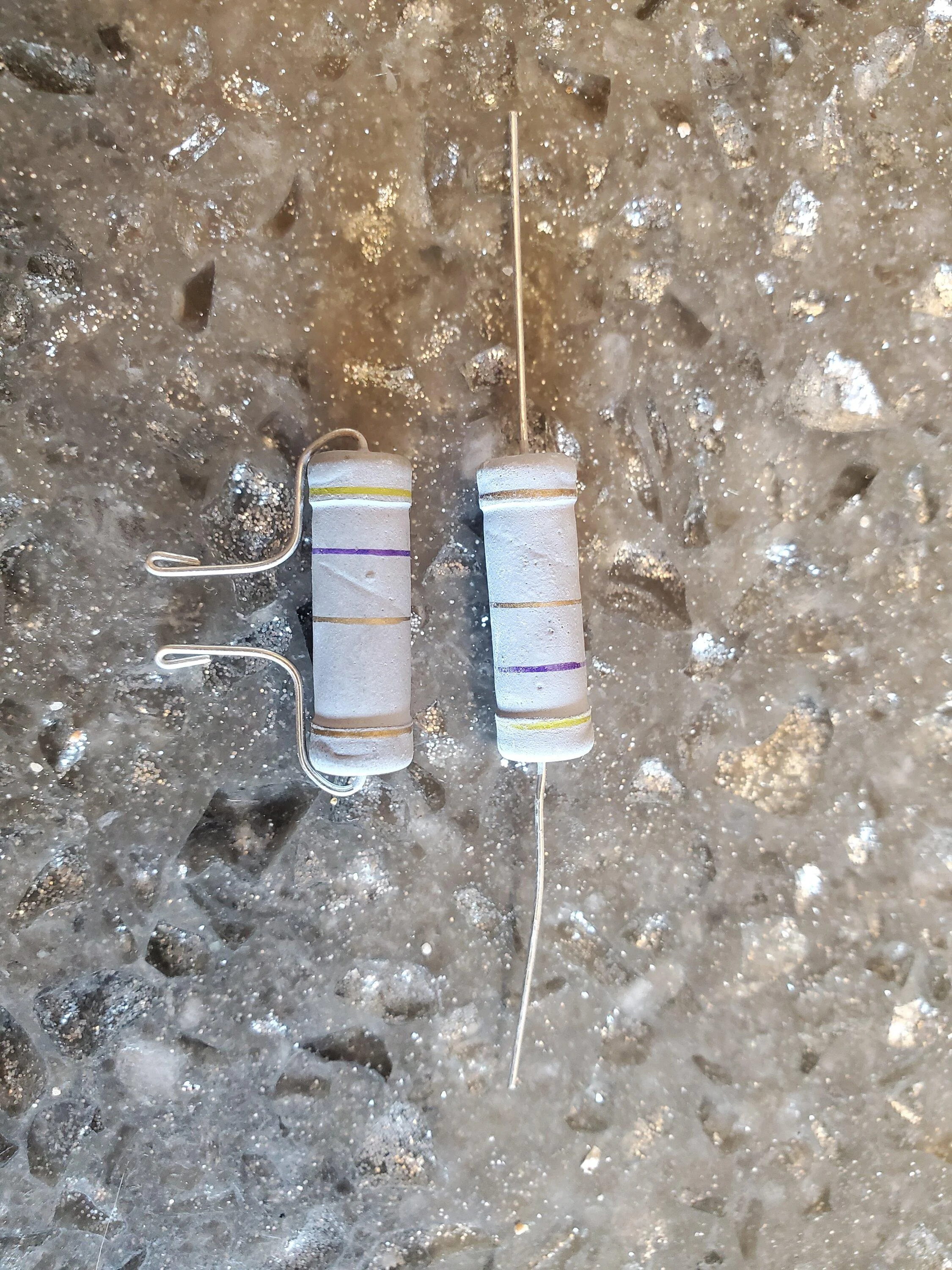

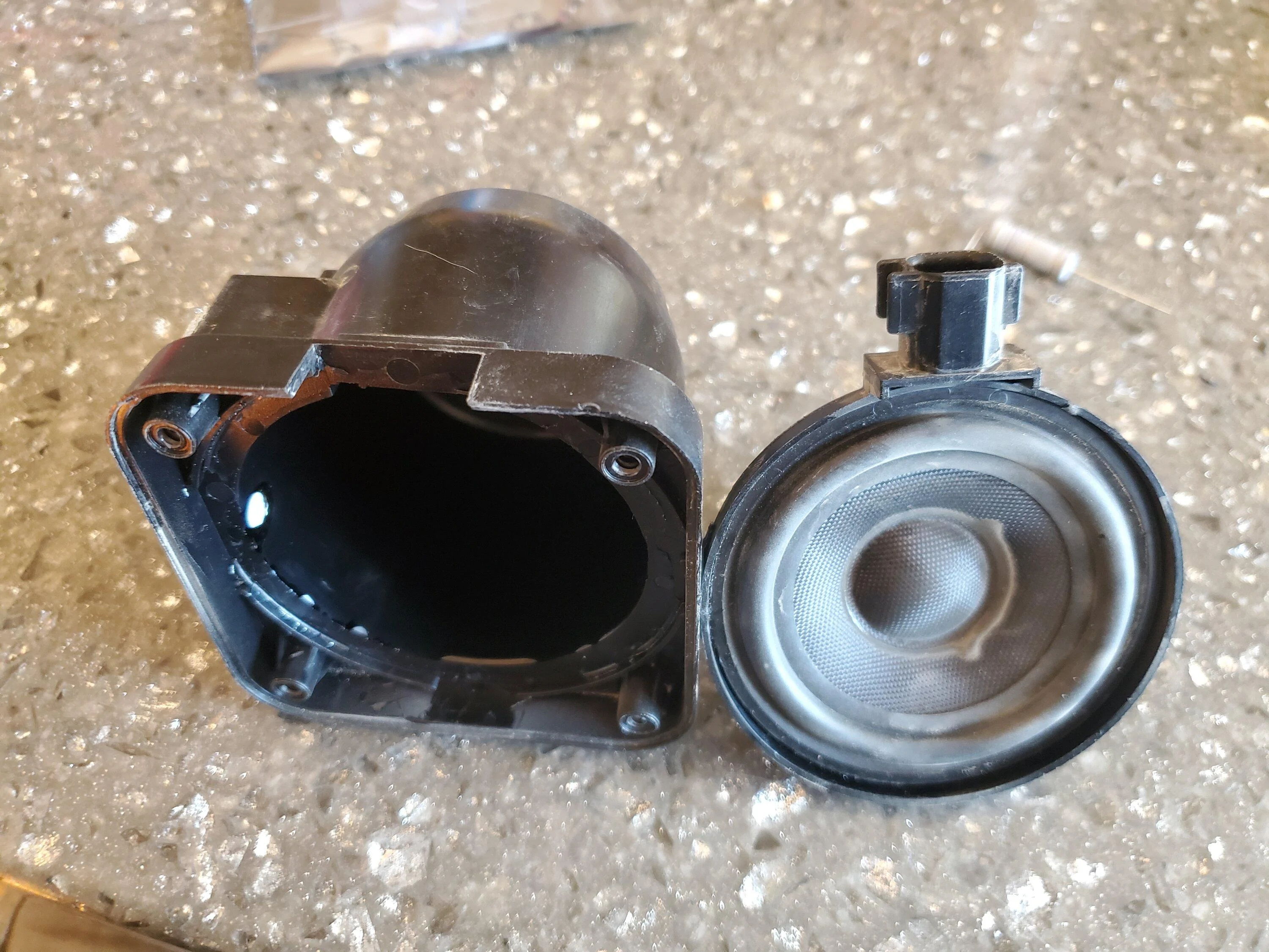

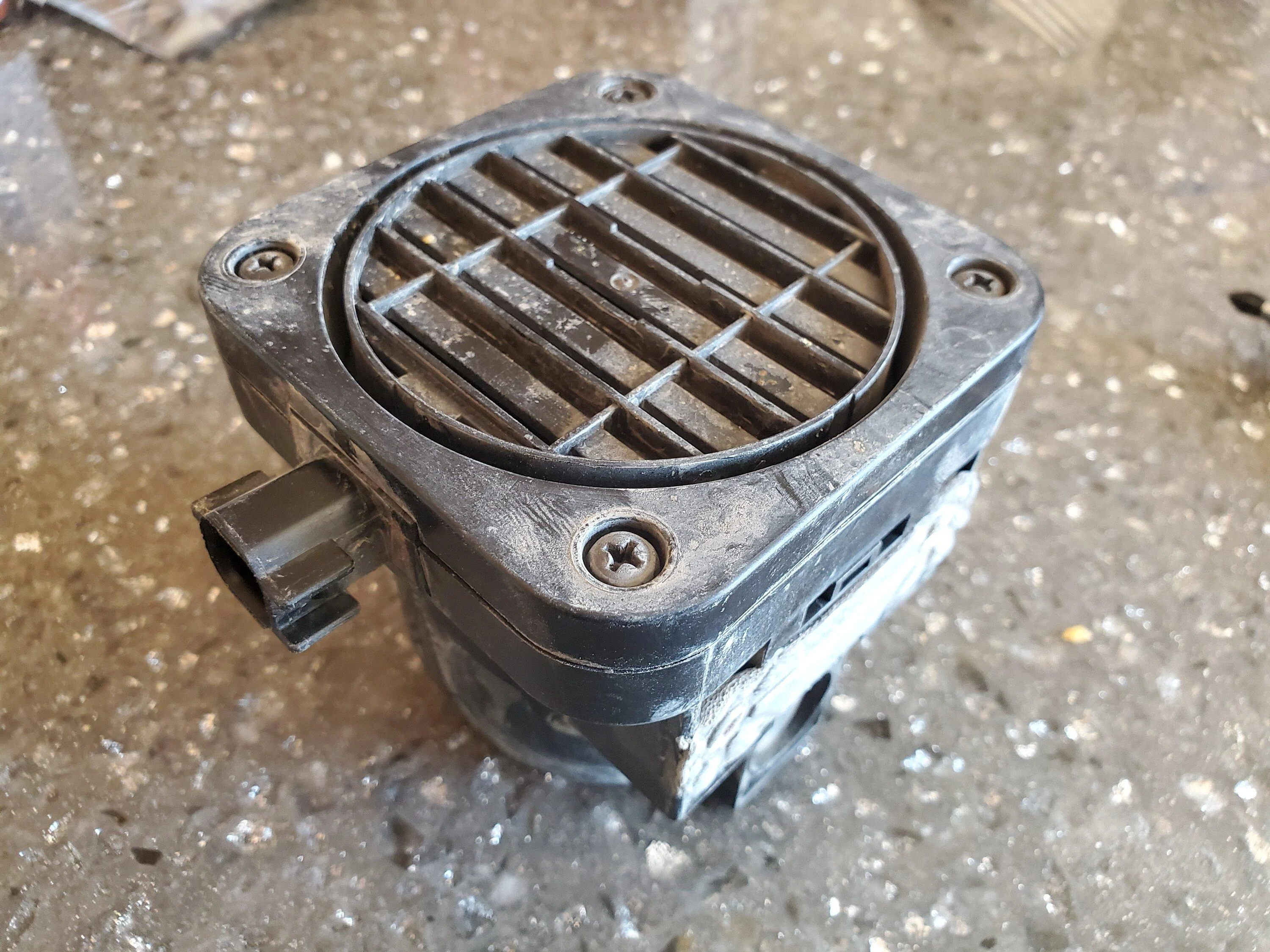

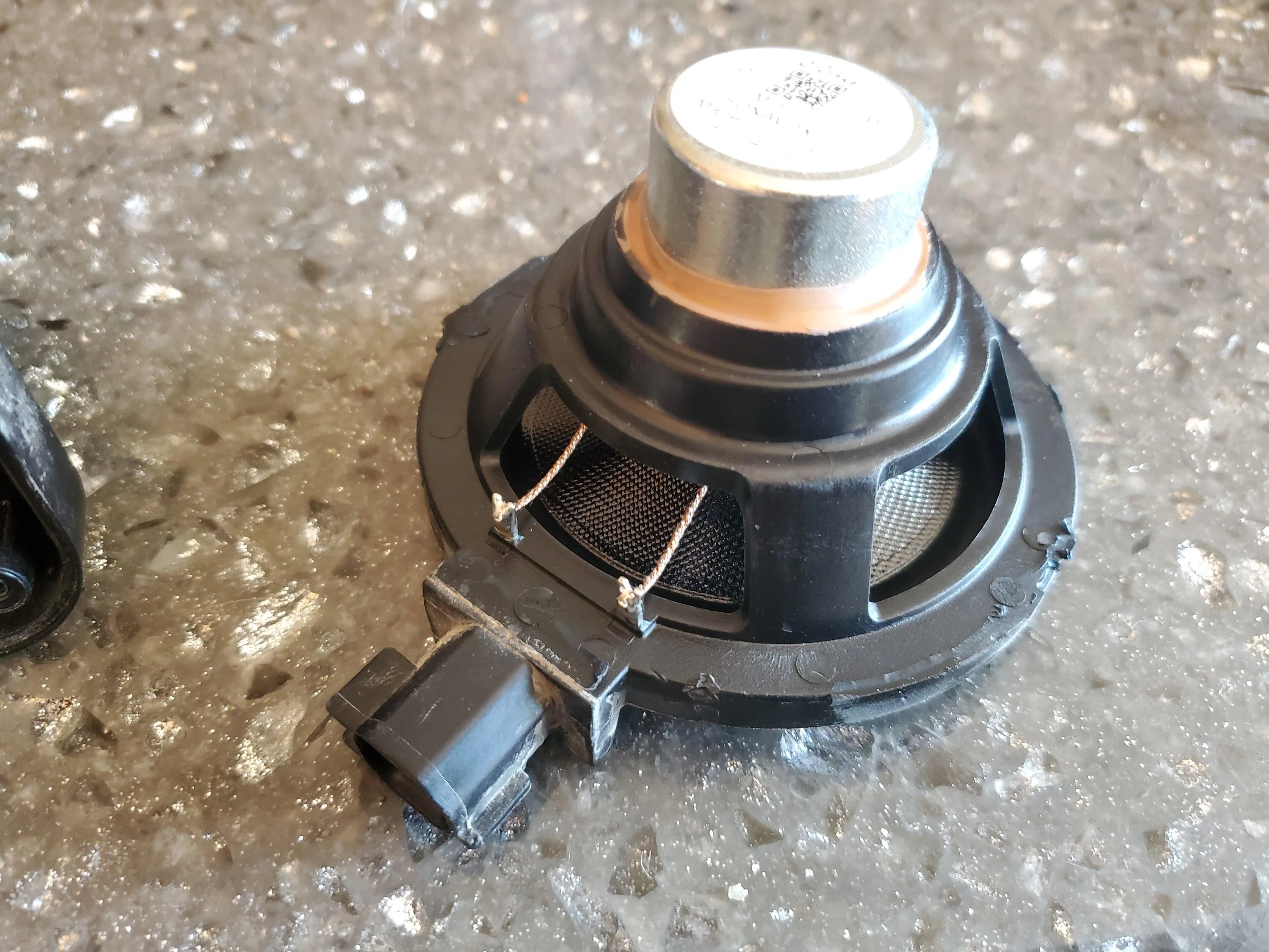

I silenced the backup speaker today. Saw a post on MachE forum on how to do it, but Lightning is a bit different....
It is very simple tho...
The speaker is just behind the front bumper on the pass side frame rail. I took it off and out, but there is no need to do that... The MachE speaker can be disassembled and resistor added inside, but not the lightning (unless u want to solder) So removal/disassembly gets you nowhere....
So, just lay under truck
unplug the speaker and add
A resistor into the harness connector (5watt 4R7 4.7ohm off Amazon).
See pics.
I bent the resistor wires as shown and inserted into end of the wire connector, it fits tight, sealed it with dielectric grease and taped it up. I realize there is a more elegant way to do this, but as an experiment it works great and only takes a couple minutes.
Enjoy the silence!

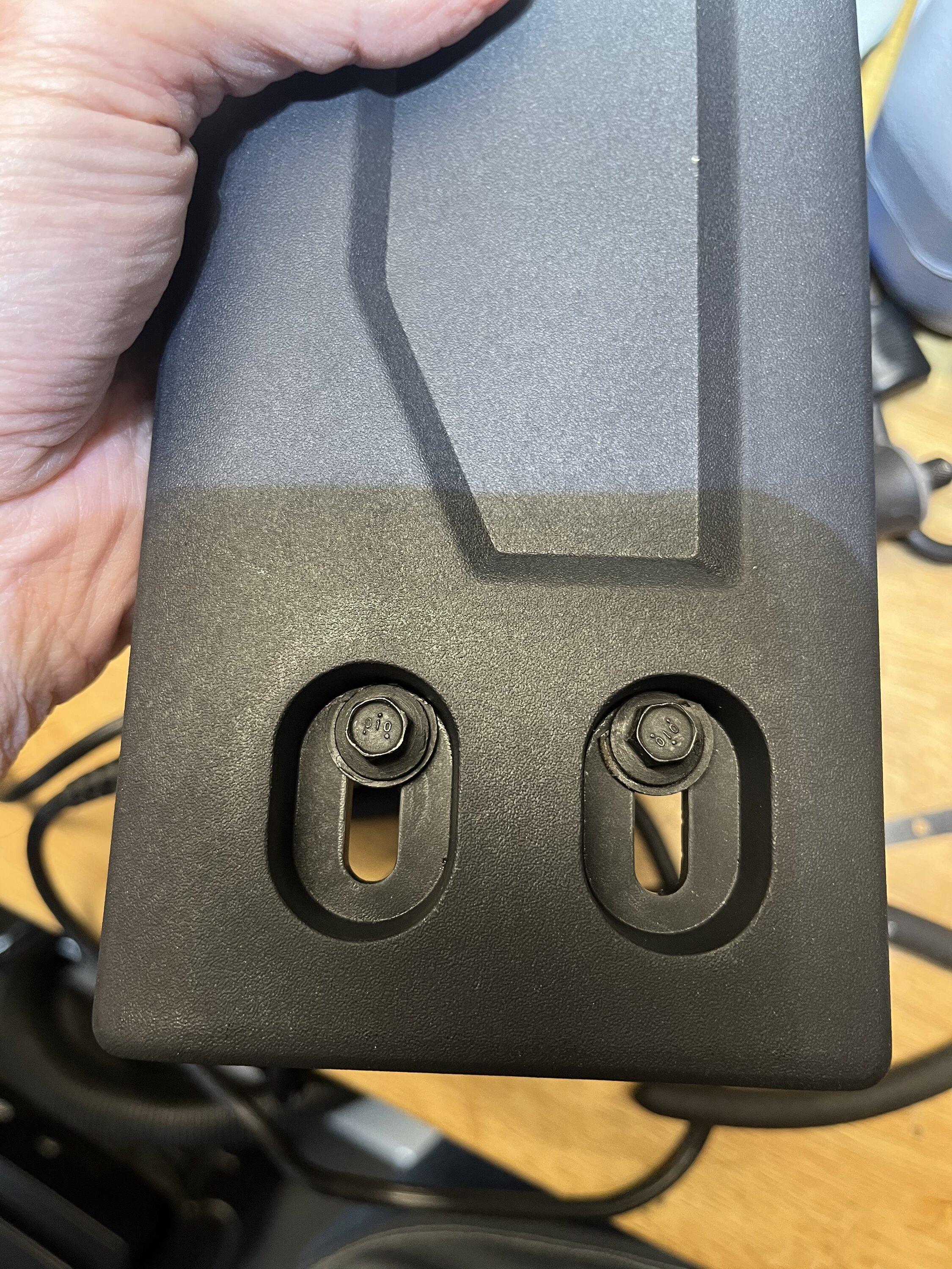

Had to elongate the holes since my seat attachment points are closer together. And then I cut the pressed washers off the bolts because they wouldn’t come off the bolts. And I got it to fit.

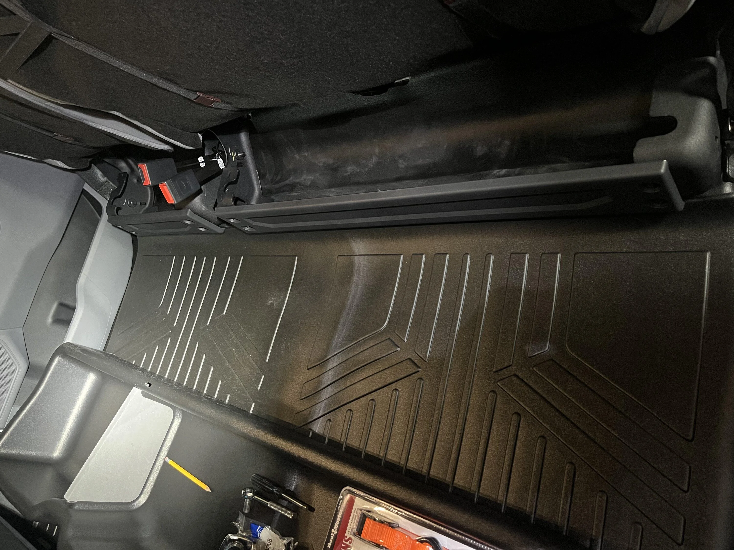

No issues on my Pro:
Ford F-150 Lightning 🙋‍♂️ What Did You Do To Your Lightning Today? 20221206_154657
I realize the picture is only of the long bar, but both went in with no issues.
Part #: FL3Z78115A00AA

I didn't even realize these were a thing. How do they impact rear passenger footspace?
Not at all, they basically convert unusable space to a small storage nook.
I keep a first aid kit, mobile charger, and a battery jump start pack there.
At $40 (plus $8 off currently), it's fairly inexpensive.

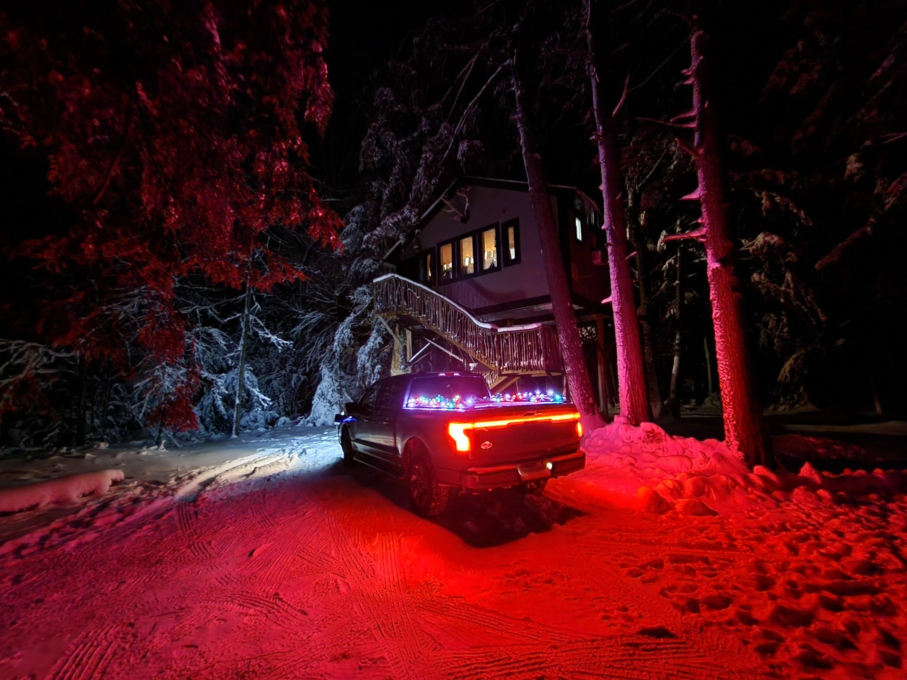

Christmas lights on the bed rails.
