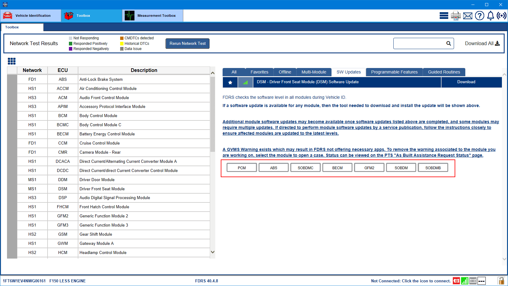

So today I got GVMS warnings for all the powertrain modules....not that I actually have any updates available for any of them...but I couldn't update them now even if I wanted to.
Ford F-150 Lightning 2022-2023 Lightning-Powertrain Reprogramming Pause-Now Extended to October Lightning_GVMS_Powertrai
Since the OASIS message about not performing 23B57 (powertrain module updates) came out a while ago I wonder why it took them this long to use the 'nuke option' in FDRS to block doing those updates.
And where's that gateway update we've all been waiting for?
I too have this issue! Is there a known solution?
