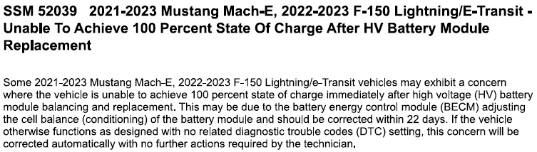

My battery array replacement is complete, and they will give me the truck back later today. Right now it's charging, but charging isn't making sense. Was at 37%, charging at a rate of 9.3kW per hour. It climbed fast. At 1 hour (now), it's at 52%. 52 - 37 = 15%. 15% of 131 is 19.65kW, but it's only added 9.3. Seems like perhaps all of the battery isn't accessible. Have to see what CarScanner says when I pick it up.
188
14,182
15,324
FP 5.0.0 is trash with the monitoring of an active charge session, retest later once she is home.
That could be it. First time charging with the new app, I charged the loaner but of course wasn't connected to it.
43
2,207
3,075
Ford F-150 Lightning 2022-2023 Lightning-Powertrain Reprogramming Pause-Now Extended to October 1717007399343-gx
Thanks for posting. As a data point I charged successfully to 100% (and maybe more!) about 13 days after my repair. It was the first time to do 100% after the repair. I typically do 85% and weirdly it only displayed 83 and 84 for the two session immediately after repair.

I'm wondering whether to charge to 90%, as I normally do, or to 100% to help the balancing process (and then drive some in the next day or so).
