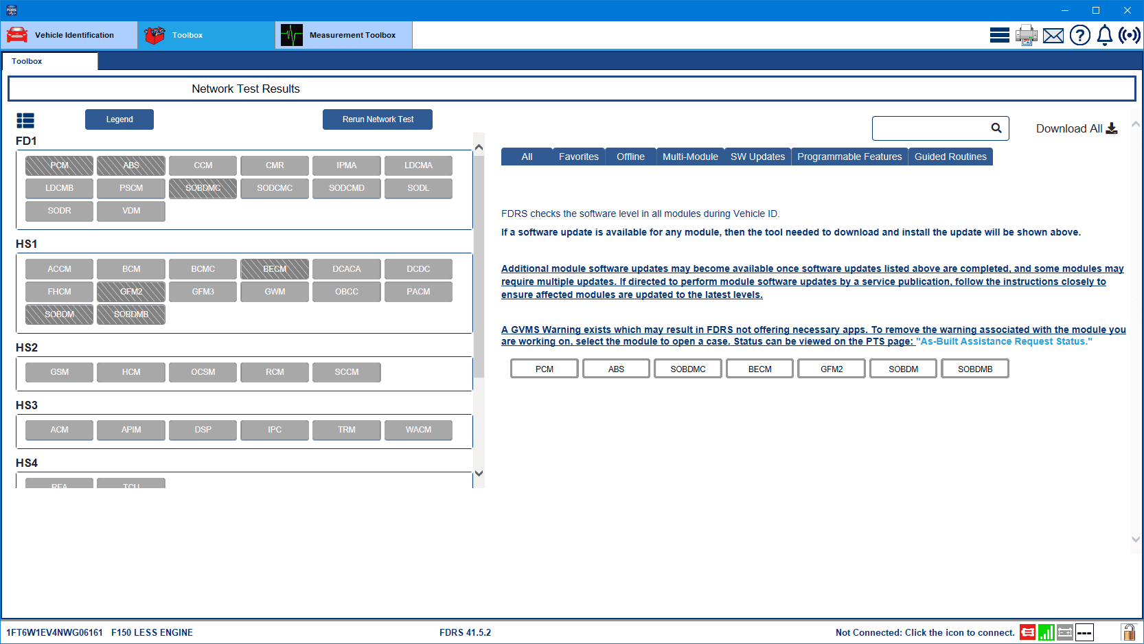

There is a block on programming all '22 and '23 model powertrain modules right now. The SOBDM is one of those modules that Ford isn't allowing techs to update (or do a PMI to install a replacement as well I'm guessing).
In this example below that's what the 'GVMS Warning' info means, and this would currently apply to your truck as well:

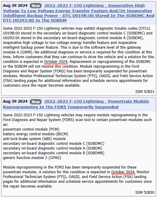

I have this bad software. The dealer replaced one of my battery modules and programmed the faulty code the day before they pulled it.
The DTC‘s don’t bother me. But I do have the “inoperative high voltage to low voltage energy transfer” issue. The HV battery will charge the 12V when the truck is on, but won't if it has been sitting for days. It needs to be driven occasionally or put on a charger if left for long periods. I’ve gotten the “12V battery low” red flag a couple times. SOC below 40%.
The bad part is I only found out about this problem from a helpful forum member. You would think Ford would have reached out to me and let me know about the issue and the need to drive the vehicle occasionally and not let it sit.
