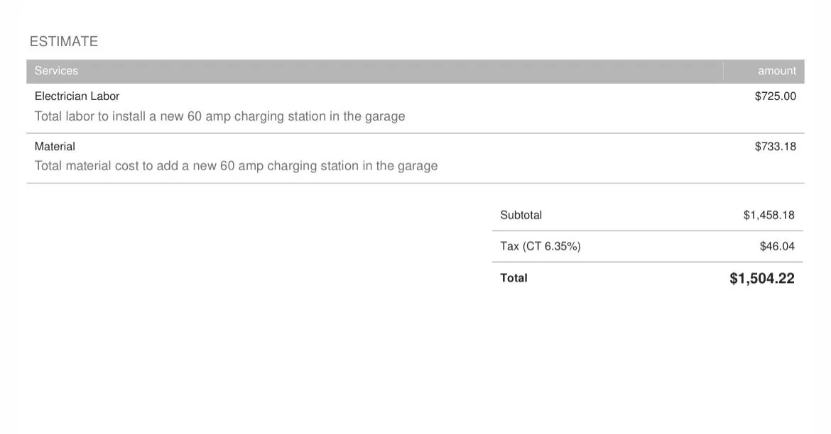

I just got a quote today for 60amp installation to the garage at $1,500.
Electrician will be providing me a 2nd option for 80amp, but material costs will be much higher, so he suggests settling for 60amp and save the money.
Plus he said 80amp won’t add value to the house versus 60 amp because only a Ford could even make use of the 80amp.
He thinks 60amps will be enough to still get a more than decent charge time, without going all the way to 80amp that might save 3 hours of charging time.
