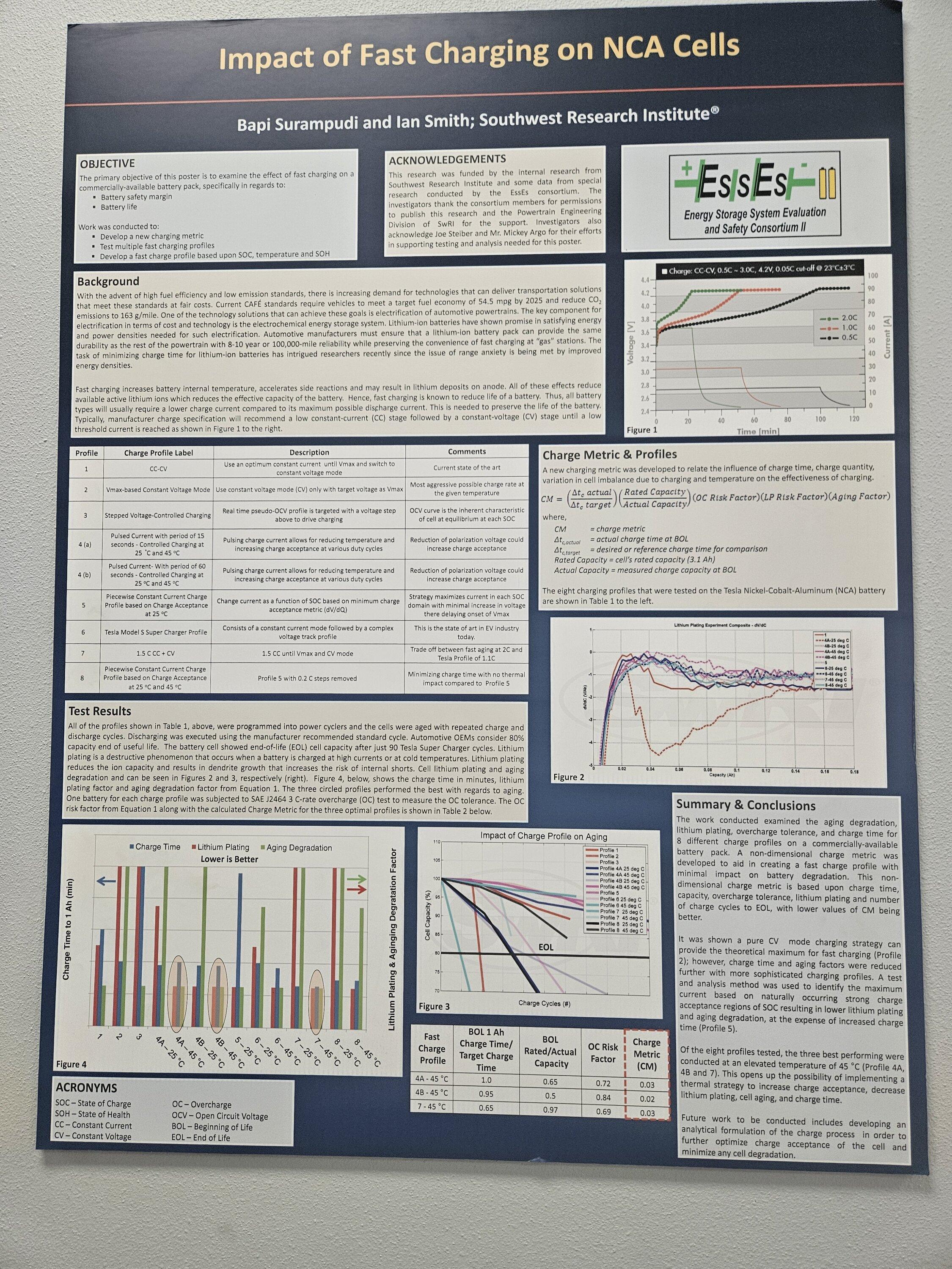

end of video - Fast charging -my research was in the early days of fast charging, so may not apply now, but here is the poster on what we did.

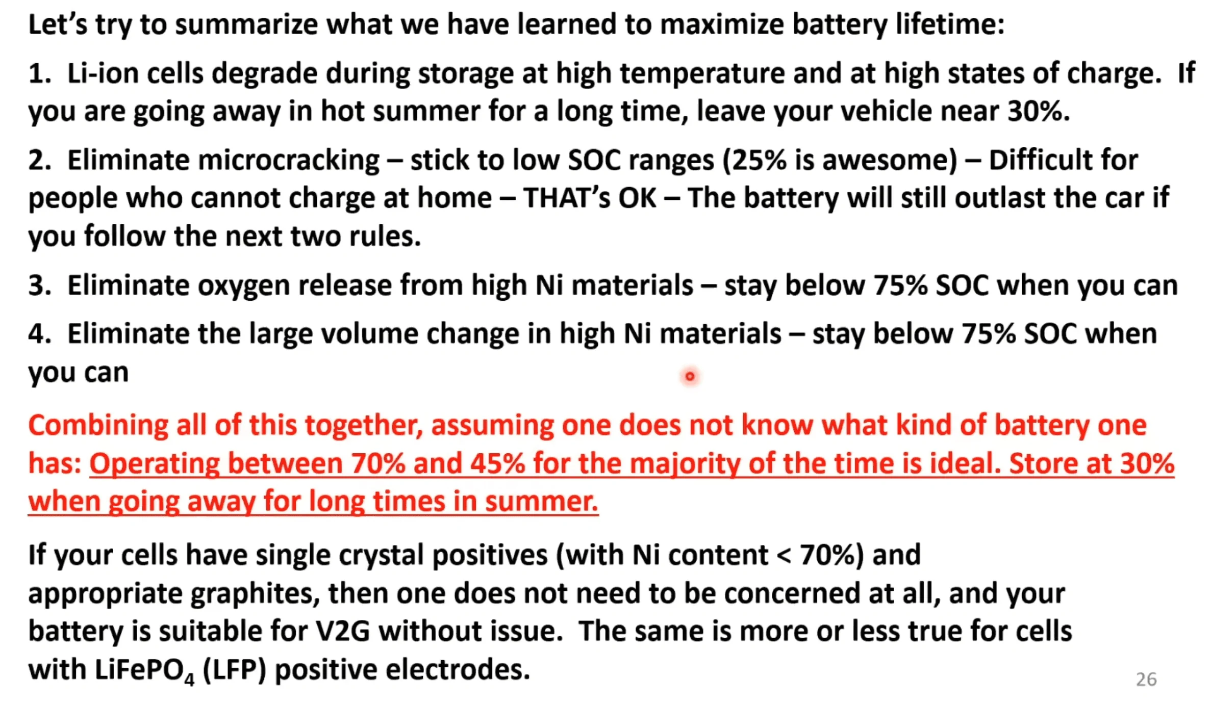

If you look at the video lecture by Dr. Jeff Dahn Dalhousie
The video is well worth the watch in it’s entirety but if there are folks that don’t want to invest an hour, here is the summary in min 42:
