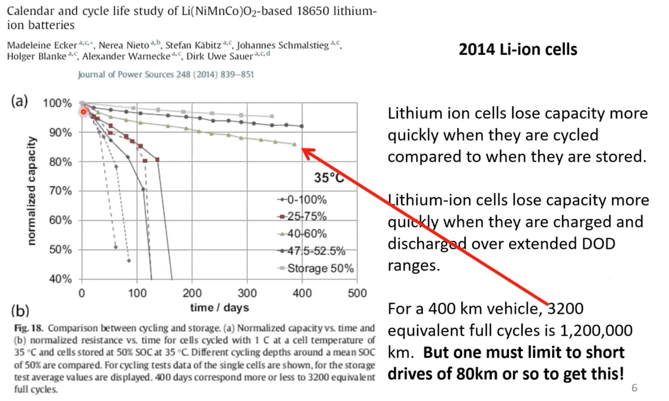

I am convinced that we spend way too much time worrying about the battery. You could charge to 100% everyday, leave it parked for weeks in the summer, and still probably have relatively minor battery degradation over the normal life span of a vehicle.
you may have a little bit of point. It looks like warranty numbers are coming from this chart. Even with 0-100 You still could get 200K out of it before it hits 70%. Of course if you combine that with other things you shouldn’t be doing, then things can get ugly fast.
I still do the best practices not just for maintaining capacity but to reduce chance of failure.

So, are we supposed to use the displayed percentages or do the math with the total battery capacity when we figuring out if we're killing our battery?

Great question. Since lower is better, I’m going to charge to 75% of the allocation from here on out
I do 80%(which is less than 75% of the actual capacity) and as he says, drive the car. 75% certainly won't hurt, but based on my research, the difference between 75-85% on our Lightnings would not be measurable for at least 10 years. Full cycle charges will degrade capacity faster than 75% vs 85% target SOC.
When looking at these charts remember they fully cycled the batteries at a 1C rate. In use, we never achieve these rates.
I'd guess you can do this and still be okay on the warranty of 70% capacity at 200k miles. But, I'd love to still be at 90+% battery at 200k, and paying a little attention to these things should improve it.
Even if these batteries are incredible and treating it the way you describe leaves it at 85% of capacity at 200k miles, if I can be at a higher capacity by following some very easy to follow practices (while still making full use of the battery when needed), I'm gonna do it.
Total capacity and range on road trips is still the biggest drawback for this vehicle, so I like preserving as much of that as possible.
