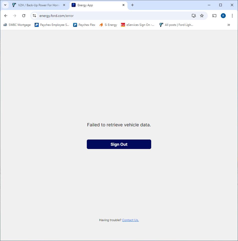

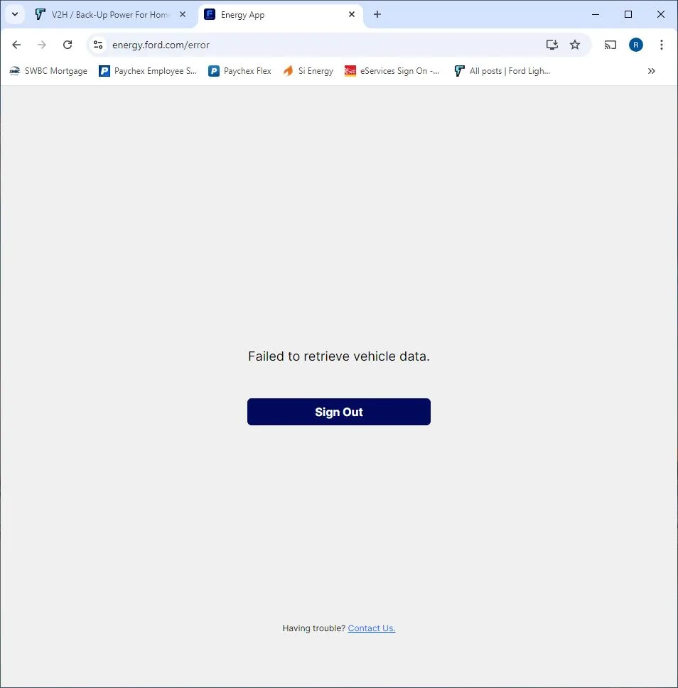

tearitupsports
Russell
Jun 1, 2024
343
328
Houston, TX
When I go to the site, it just shows this message now.

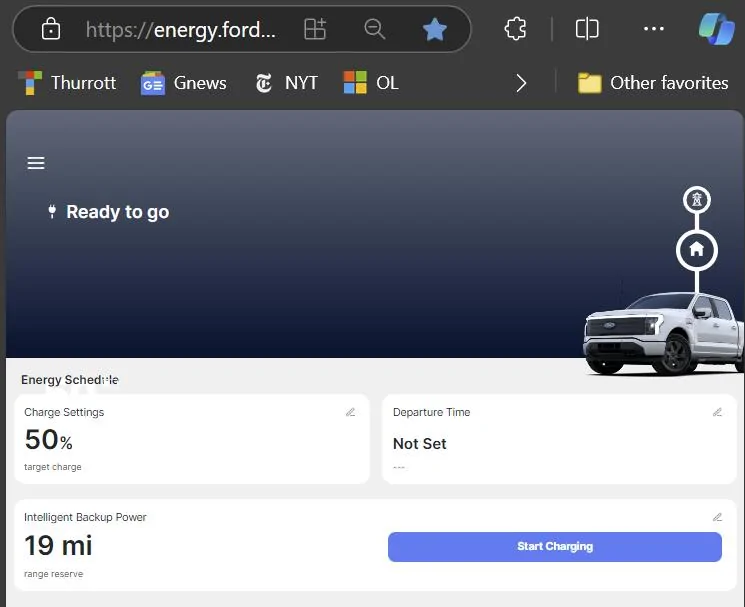

Jim Lewis
Jim Lewis
Jan 10, 2023
51
986
929
San Antonio, TX
Sorry to hear that. Did it work before recently? Maybe it depends on the state of your system.
It's working for me now:
Ford F-150 Lightning A new way to manage Intelligent Backup Power is up ahead. 1728426965856-b2
Last night, during a BPT test, I had trouble connecting on my iPhone, but the site came back on for me when I tried again a few minutes later. Maybe if you try again in a bit, you'll get through?
tearitupsports
Russell
Jun 1, 2024
343
328
Houston, TX
It used to flash for a second then go blank. Now it redirects me to an error page (for days and on multiple devices).
Jim Lewis
Jim Lewis
Jan 10, 2023
51
986
929
San Antonio, TX
Perhaps the web page is still in Beta and we're only able to successfully connect if we've gotten Ford's secret sauce of Beta updates on our system. I've asked Ford what's making my HIS unit work "more better" than previously and gotten no reply from them on that. The lack of communication and the lack of expensive things working the way we have a right to expect is insanely frustrating. :sadface:
