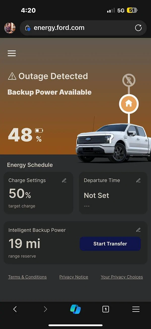

Thanks for sending that I wasn't aware of it. It looks nice but doesn't seem to offer much information, at least when not plugged in.
I hope they provide the advertised functions of starting and stopping the backup power, and showing available backup time remaining via this since it never made it into the app as advertised. I'd like to be able to test it without having to flip the main breaker every time. ?
If it doesn't do these things we'll have to ask for it via the feedback page in the menu.

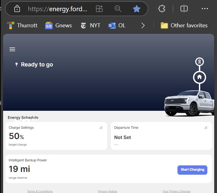

2024-09-09 19.05.43 energy.ford.com e0bbea43-1822-4da3-8e21-1f966e27faef.jpg
How do you get this page to stay up? Mine flashes this screen then goes blank both on my computer and phone.
Same here, as reported above.
When I examine the page source of https://energy.ford.com, there seem to be a number of Javascript errors, including crossscripting (XSS) regarded as insecure and not alllowed by modern browsers.
Here's the page source view with errors in MS Edge:
energy.ford.com
www.account.ford.com/:1 Refused to frame 'https://www.meea-local.ford.com/' because it violates the following Content Security Policy directive: "frame-src 'self' https://login.ford.com/".
(index):2942 Uncaught TypeError: Cannot read properties of null (reading 'classList')
at HTMLDocument.onDocumentLoad ((index):2942:19)
api.pd01e.gcp.ford.com/meea-vs/energy-app/v1/vehicle-status/1FT6W1EVXPWG12099:1
Failed to load resource: the server responded with a status of 400 (Bad Request)

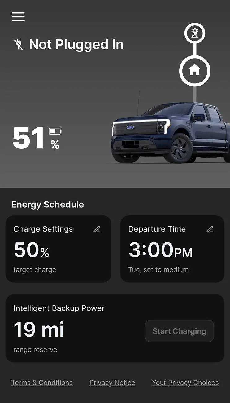

looking at the first line about the departure time not being set; mine is set, is yours? If not maybe the page is getting hung up on that somehow?
I set a Departure Time for 8 AM Monday morning. The page load still goes blank, so that's not it.

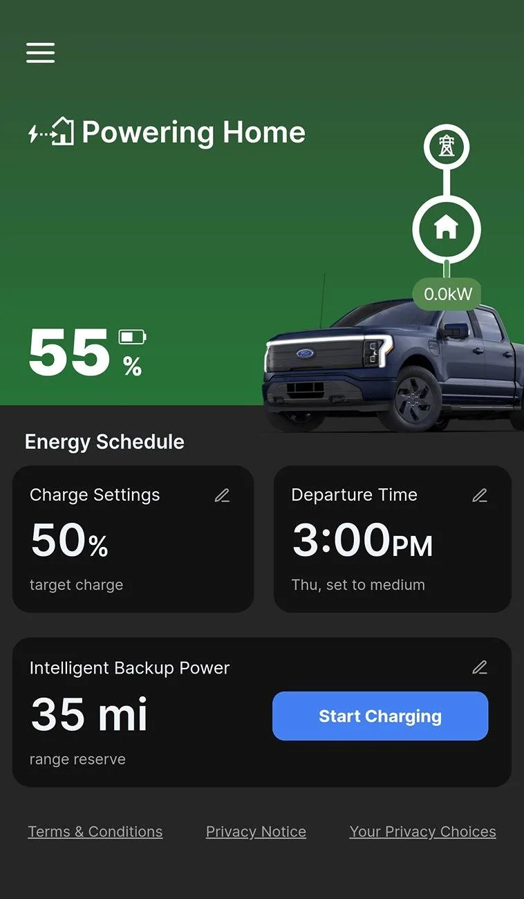

The online Ford Energy app to monitor Intelligent Backup Power appears fixed. I just tried it (https://energy.ford.com), and now, after I sign into my Ford account, the page loads and no longer goes blank. It shows the correct status of my truck and its backup settings. Hurray! Let's hope it stays that way... (y)

Here is what it sould look like with backup power transfer in progress. Note mine isn't actually transferring any power though. ?
Disappointed there doesn't seem to be any way to start or stop the power transfer from this page or any backup duration remaining indication.
Does anyone with a working system care to test this page out?

I tested backup power transfer extensively early this AM and got the same results. The screen background goes from BLUE (power available from GRID) to GREEN (power being transferred from truck to house panel) just like the FCSP LEDs, and the truck port LEDs change color accordingly.
The START/STOP transfer button does not work in the energy.ford.com app for right now,*** and although the kW transfer indication shows 0.0 kW being transferred, if you check the truck SYNC screen IBP app or use the M Professional app (available in the App Store and Google Play), you'll find power is being transferred (the 4-number passcode to connect M Professional to the HIS unit via BT is on the side of your HIS unit). Hopefully, the lack of power transfer wrongly shown by the web app is something that can be easily fixed.
***Note: Actually, the Stop Transfer worked for me via the web app in the midst of a BPT event, but with backup transfer stopped and the truck and grid power off, the Start Transfer button, as shown in the screen capture before, did not work and crashed the web app, The web page for a short time became unavailable to my iPhone! Ideally, one should be able to stop and restart BPT at will, as the truck IBP app suggests, to nurse the most usage out of your battery during an outage.
Here's what the site page looks like if grid power is down and there is no transfer. The background is now a dirty orange-brown. More later. The most important thing I learned is after the picture.
