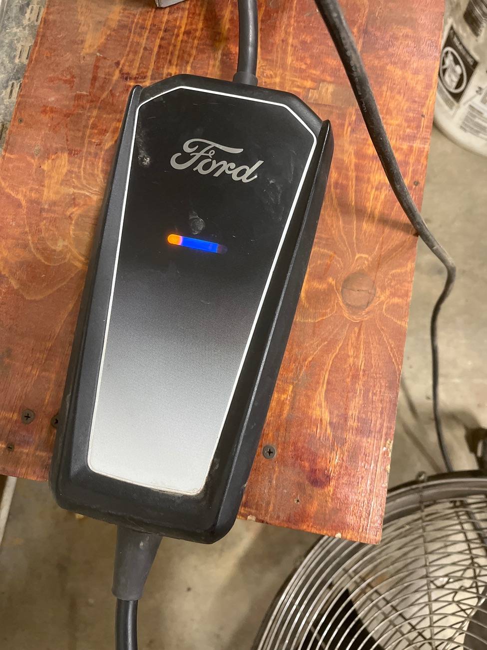

As I mentioned in my original posting, I had just gotten home from a long road trip. Hence the state of charge. not wanting to cold soak. I plugged it in to 110 since I don’t have 220 at the house. I didn’t need it to charge at all. I believe I’ve said multiple times I wasn’t looking to charge. Maybe the full picture next time….
By the way, my mobile connector charges at 1.3 kW even when it’s 5° out this morning.

Its more likely that the problem here is the poor mobile EVSE. While the slower charging rate may not be able to keep up, it should still be supplying power.
THIS... has been my experience. Ford's mobile charger would not work for more than a couple minutes in the cold. Tried my Rivian mobile connector and it worked fine, but was painfully slow (of course).

In the "why waste $500 if you don't have to" department: If your vehicle is still under warranty and the dealer isn't completely fly by night, you might be able to get that mobile connector replaced. I had an orange-light situation which took two trips to the dealer and some data to resolve; the thing would only fail after working OK for a while. But once the problem was made clear, I had a new one within two days. Yours seems like an obvious fail which would be visible right away. It's useful to keep the portable charger in the frunk for when...situations occur.

Think of it this way: the most you can do with a standard 110 outlet is run a hair dryer or a small space heater. Imagine trying to keep an 1800 lb battery pack warm in sub-zero temps (keeping in mind it wants to be like 70-80 degrees) with a hair dryer. That’s a big ask for not that much electricity, let alone having enough power left over to charge the battery.
I agree though, the mobile EVSE should have been able to keep providing some current to at least keep the battery above ambient but I doubt it would have been able to keep it warm enough to charge in any meaningful way.

Yes many failures of the Ford MPC have been reported as well as the non-Ford branded one the Webasto Go (sold on Amazon).
Keep for emergencies, not suitable for everyday use probably.
Covered by the 3 year B-B warranty.
