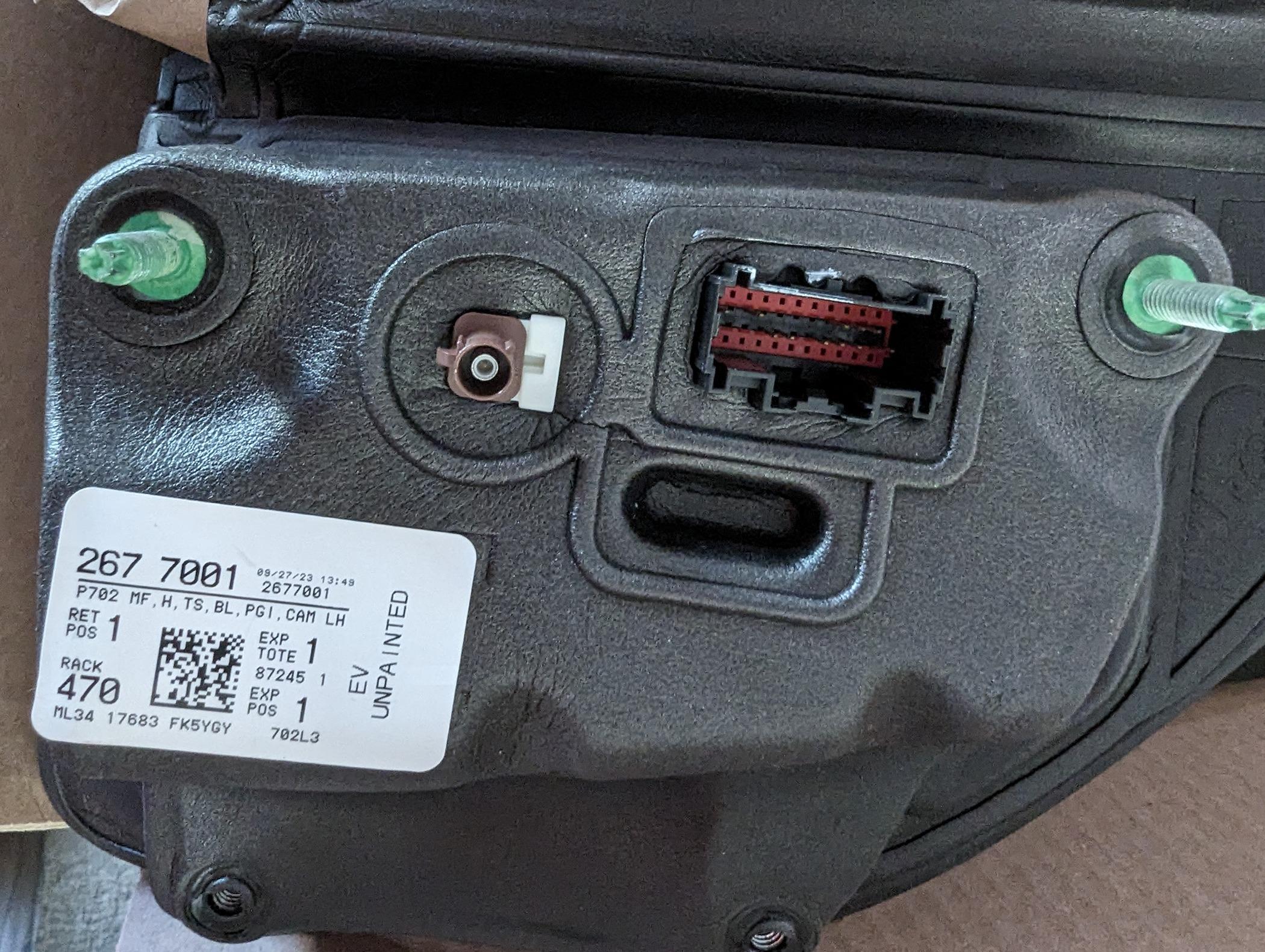

Could i buy a set of powered mirror missing the camera or light underneath and swap mine over? Would it still have all of the wiring inside to accommodate it?
VenomVol
Kyle
Mar 28, 2024
Nashville
'23 Lightning XLT ER
I don't think so, because the mirrors with 360 have an extra plug for the cameras that is separate from the main mirror plug (brown connector in the pic below). If the non-360 mirrors have that connector, then the wiring should be there inside, but if they're missing that, then it definitely isn't.
