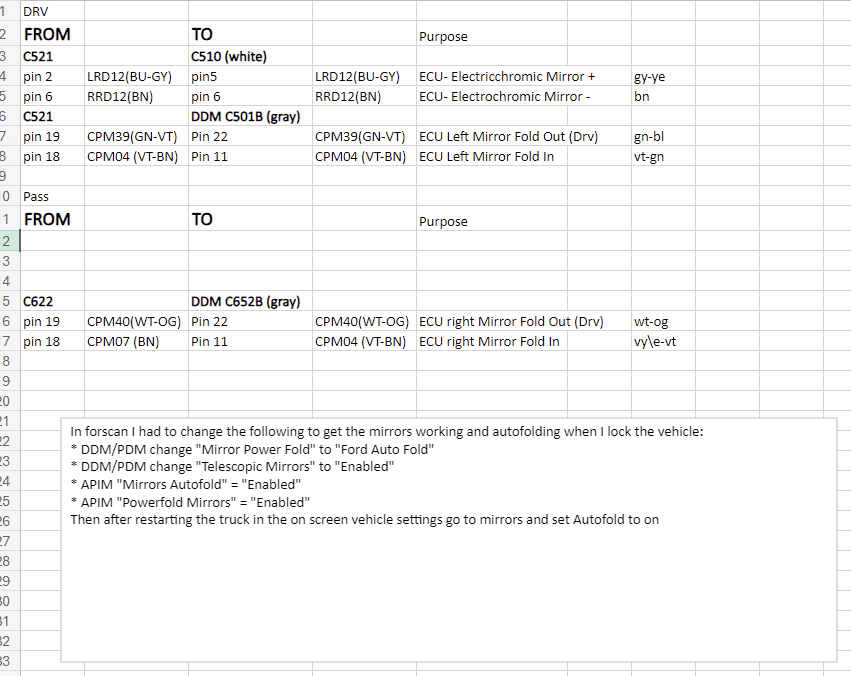

I have some video when doing mine from awhile ago ill see if I can dig up. bright ideas to be helpful but much more annoying to edit and publish. I only had to pull wire from the door connector for the electrochromic mirror. the others are for the DDM/PDM to the top plug super simple. I can probably re-lookup the pins i used if you want to do it cheaper than BGG designs

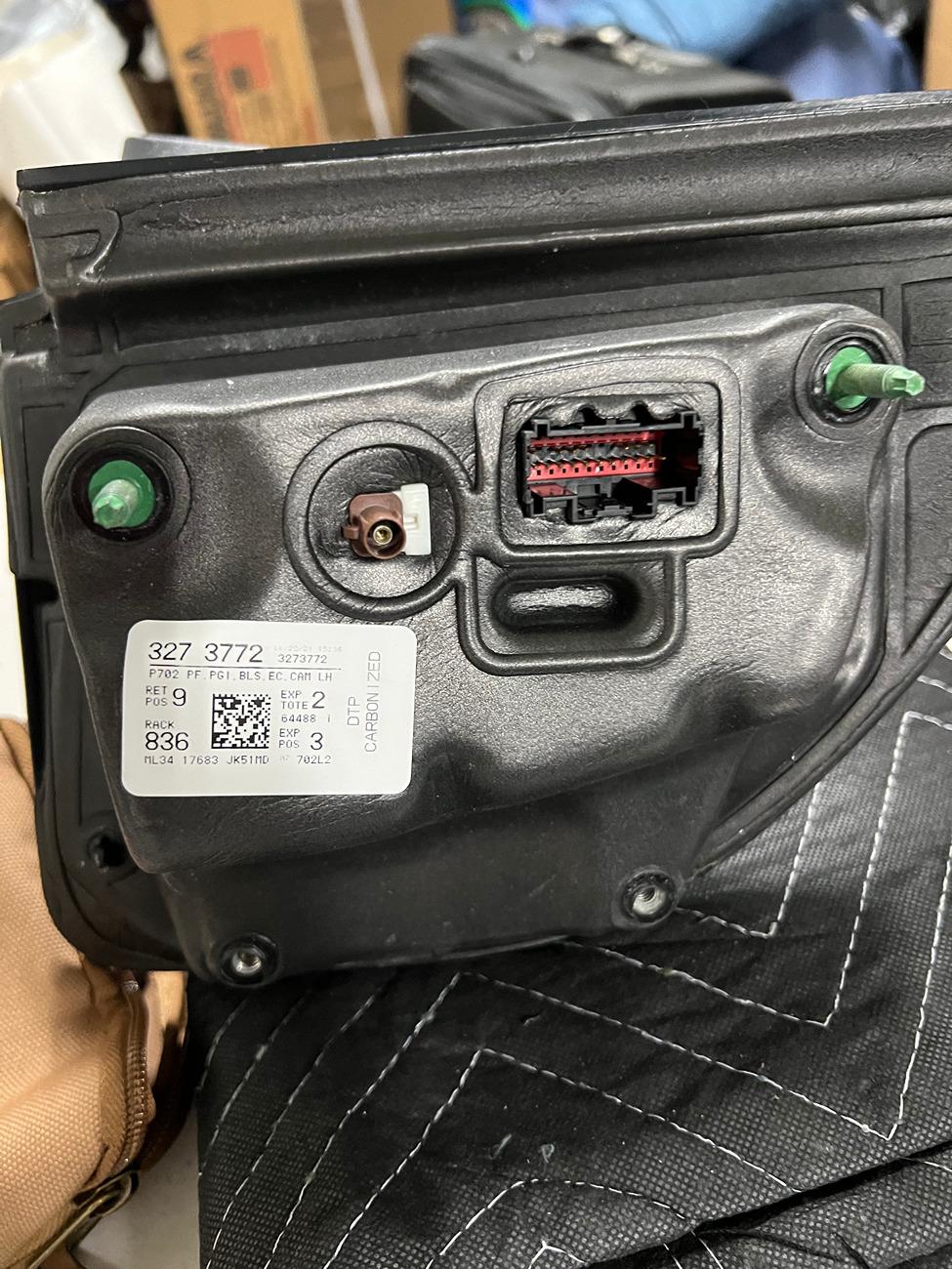

So I saw this thread and also a similar one in the F150Gen14 forum and started looking for some power fold mirrors on ebay, etc. I happened to find a guy selling take offs from an ICE F150 Lariat which were the same color as my truck (Carbonized Grey). Bought those, the boosted grey goose harness and a new door switch (ML3Z-14529-CC). The mirror and harness install are very straight forward. Everything is working, 360 cams, BLIS, puddles, etc. Here are the part numbers of the mirrors. The drivers side is also dimming but I chose not to wire that up as I have heard some people don't like it and I really don't need it.

2023 Lightning XLT here. I sourced a power folding mirror from EBay (driver's side only). Bought the new door control switch from Ford dealer. Bought the Boosted basic harness.
So far, I could only find the driver's side power folding mirror.
Wired up both doors with the Boosted cables. Verified the new pins were fully inserted and locked all around.
Made the above-listed DDM, PDM ( I figured "why not" even though there's no passenger power mirror yet, as the new added Boosted pins are de facto unconnected circuits until I add the power mirror), and APIM changes, except the telescoping mirror change, as all my mirrors are non-telescopic.
BLUF: the driver's power mirror does not fold or unfold under any condition - not when using the new FOLD / UNFOLD button on the door control, and not when locking and unlocking. Moreover, the APIM choices under SETTINGS / VEHICLE / MIRRORS are there but grayed out and not grayed out anymore with a further change in the IPC although the AUTOFOLD function still doesn't work grrr...
Anyone run into such a situation?
One possibility: the new EBay-sourced mirror assembly is faulty. Another possibility: the truck's modules must sense both power mirrors as present before this function can work.
It's almost like I'm missing a step somewhere... I'll relook this tomorrow. Comments welcome.
