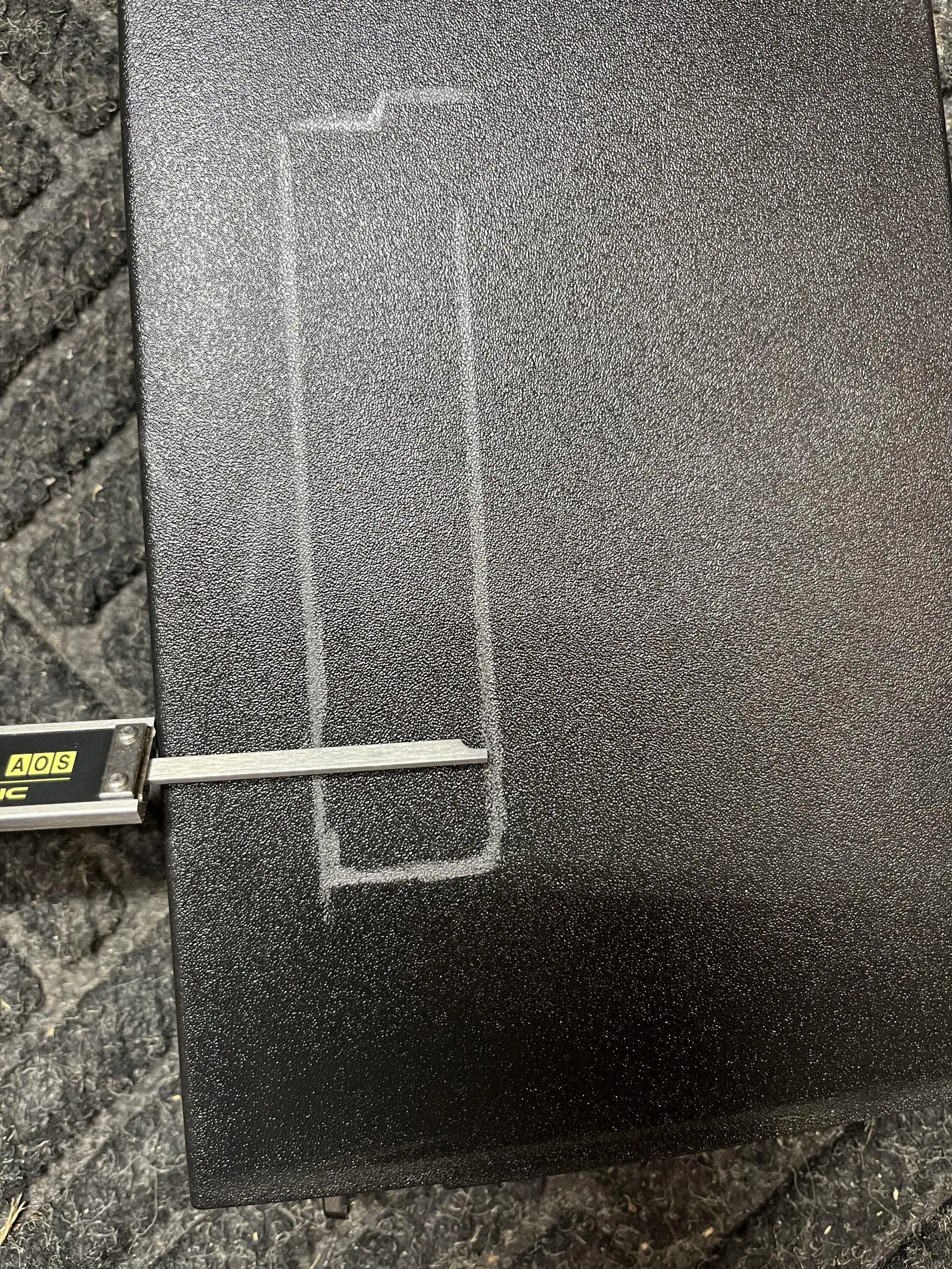

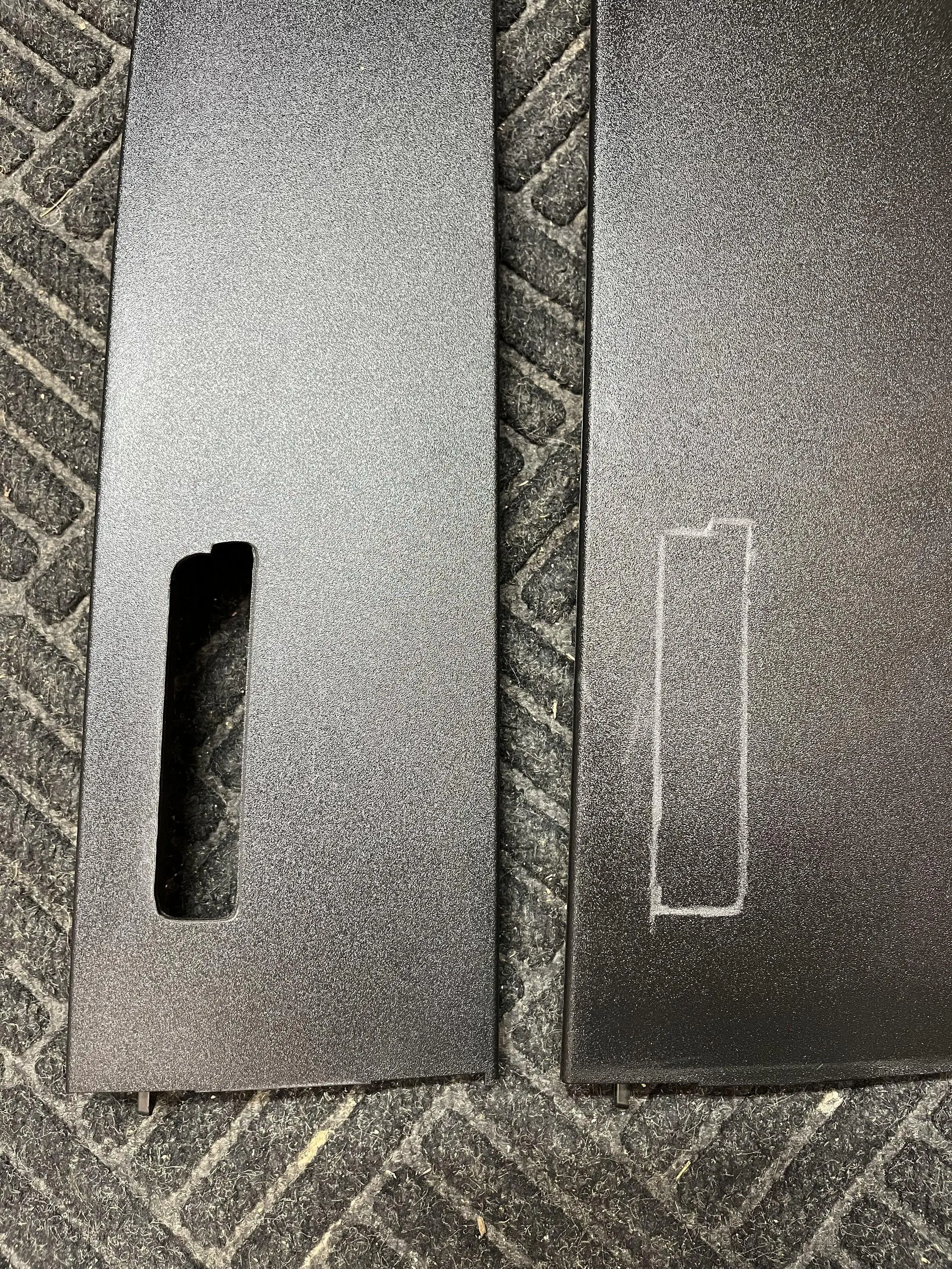

Im gonna go the route of dremmeling my current trim….the pre-cut one is to have on standby if/when I screw it up!

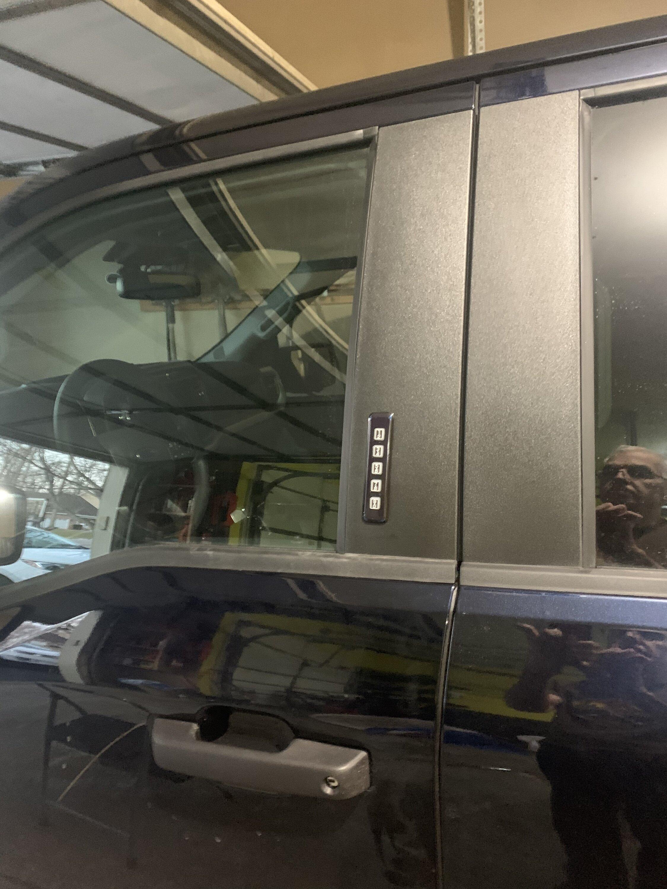

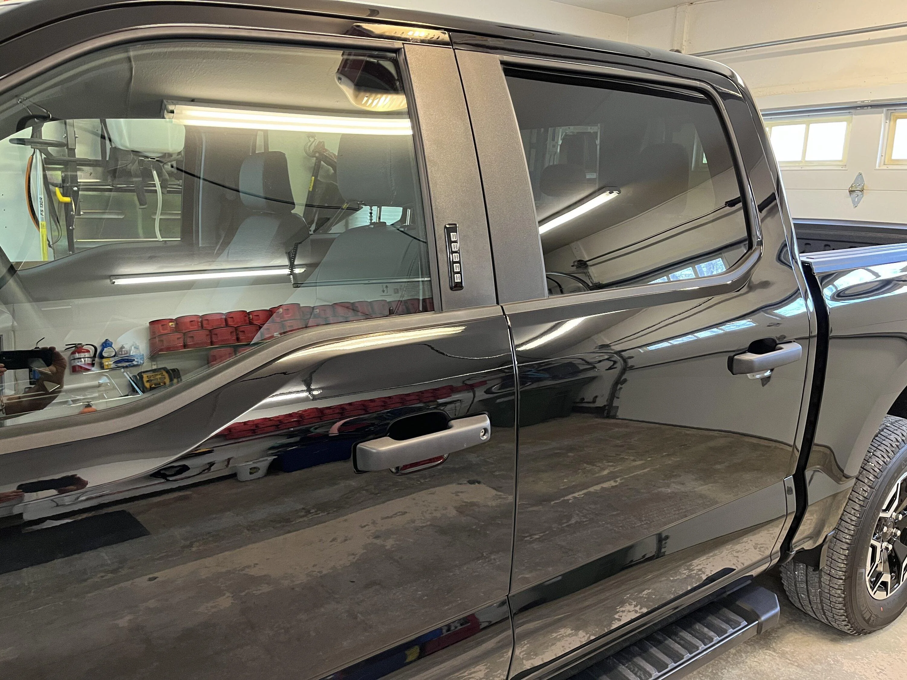

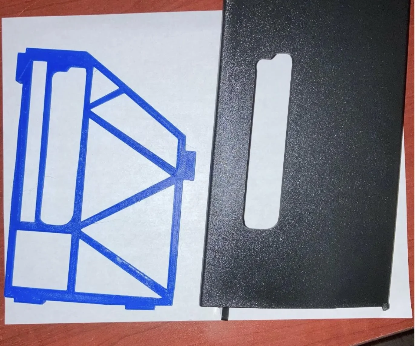

Ok everyone….It’s done! Added to Pro today. Everything works as intended

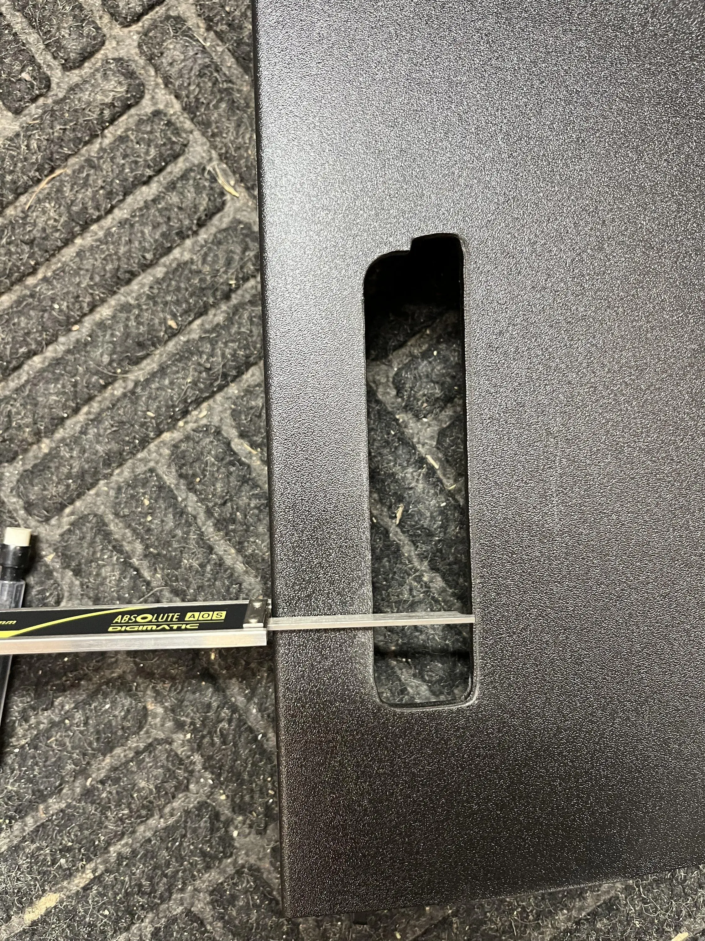

Gotta be honest…it was a pain. If I didn't get so used to the feature on my previous F150…I probably would have quit on this one. Like most things, would take me half the time now…but was an honest 4 hours for me. That included me dremmeling out my trim piece. Routing the wire is what really sucked.
If anyone is wanting a trim piece with the hole already factory cut, I still have a new one. It was my backup if I screwed up mine when cutting!
Was $78 at tasca before tax and shipping. And, there was quite a delay in getting it. If someone here wants it for $80 shipped, let me know!

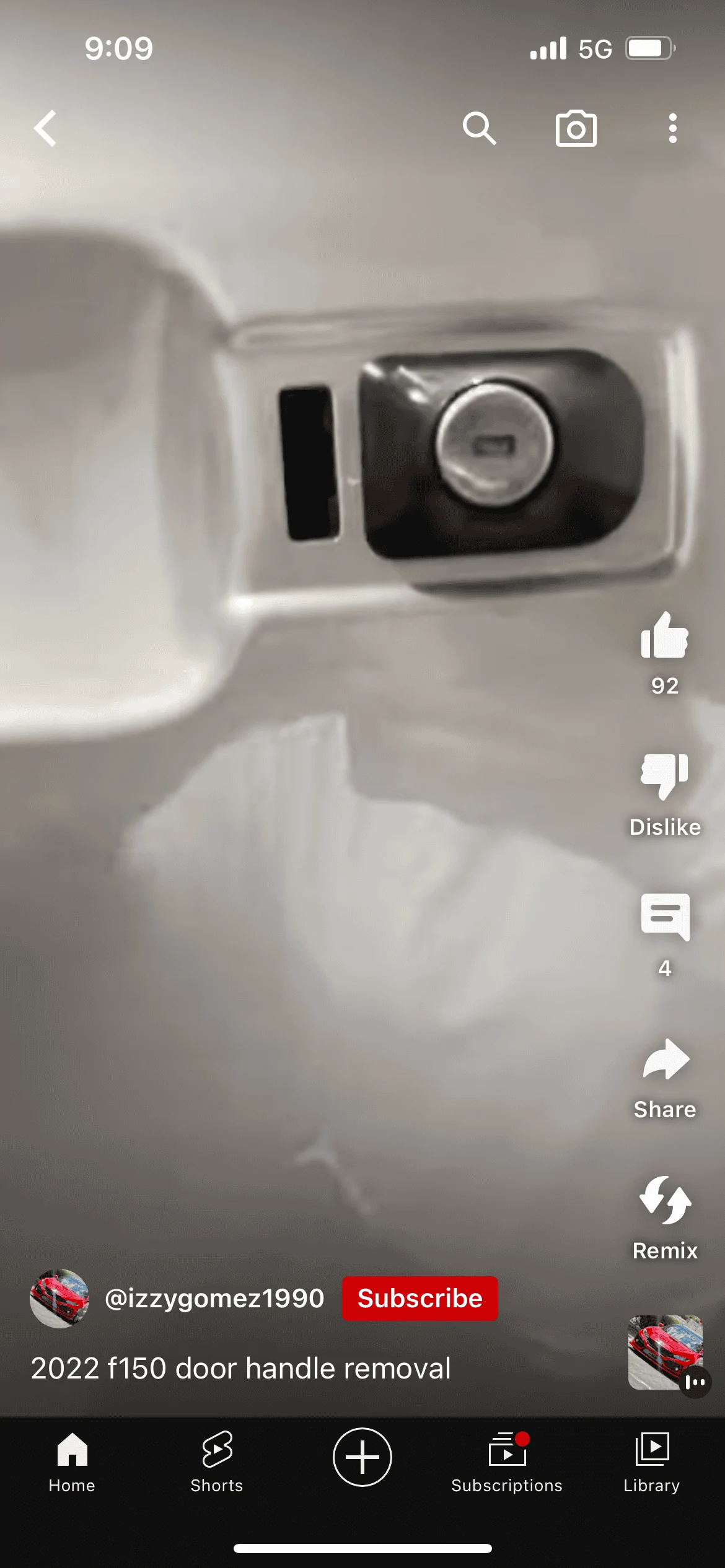

Did you remove the inside bracket portion of the exterior door handle? Have any pictures of it? How hard was it to remove?
jallen
Aug 19, 2022
175
140
2009 F150 XLT / 2023 Ford Lightning Pro
I removed the exterior door handle…but just the handle comes off. The lock mechanism is still there on one side, and super tiny hole on other side. No access. Wasn’t about to try and get lock mechanism out without access to back side of it. Even then, the hole to be gained was maybe 1.5” by 1.5”??

Still from a video with handle removed. No access still.

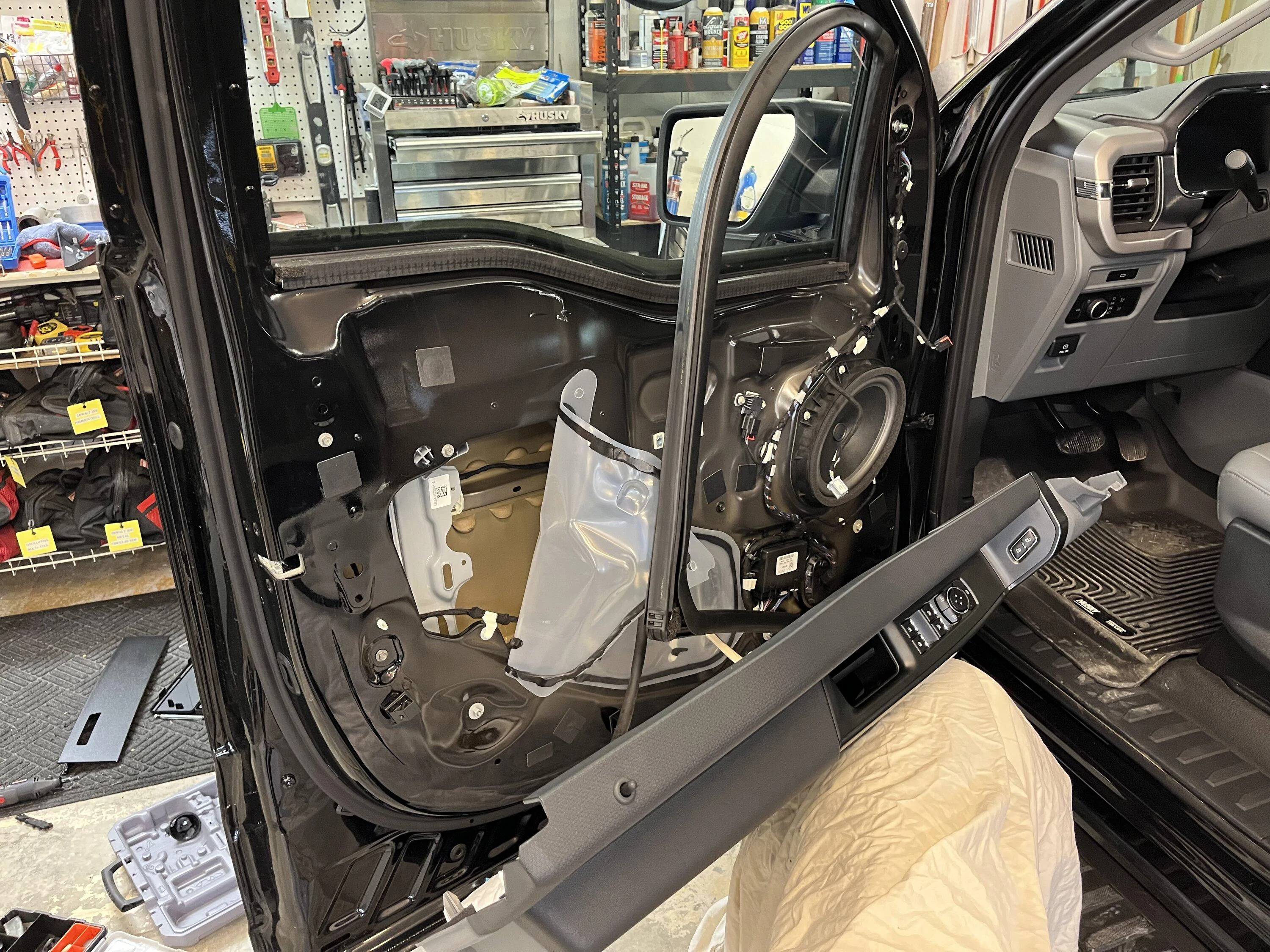

With much insight from @jallen i got it done in 50 minutes. I even dropped a screw down the door and had it fish it out with a magnet tool. The wire fishing is the hardest part. I used a long dowel to push it down between the door edge and white plastic window guide.
