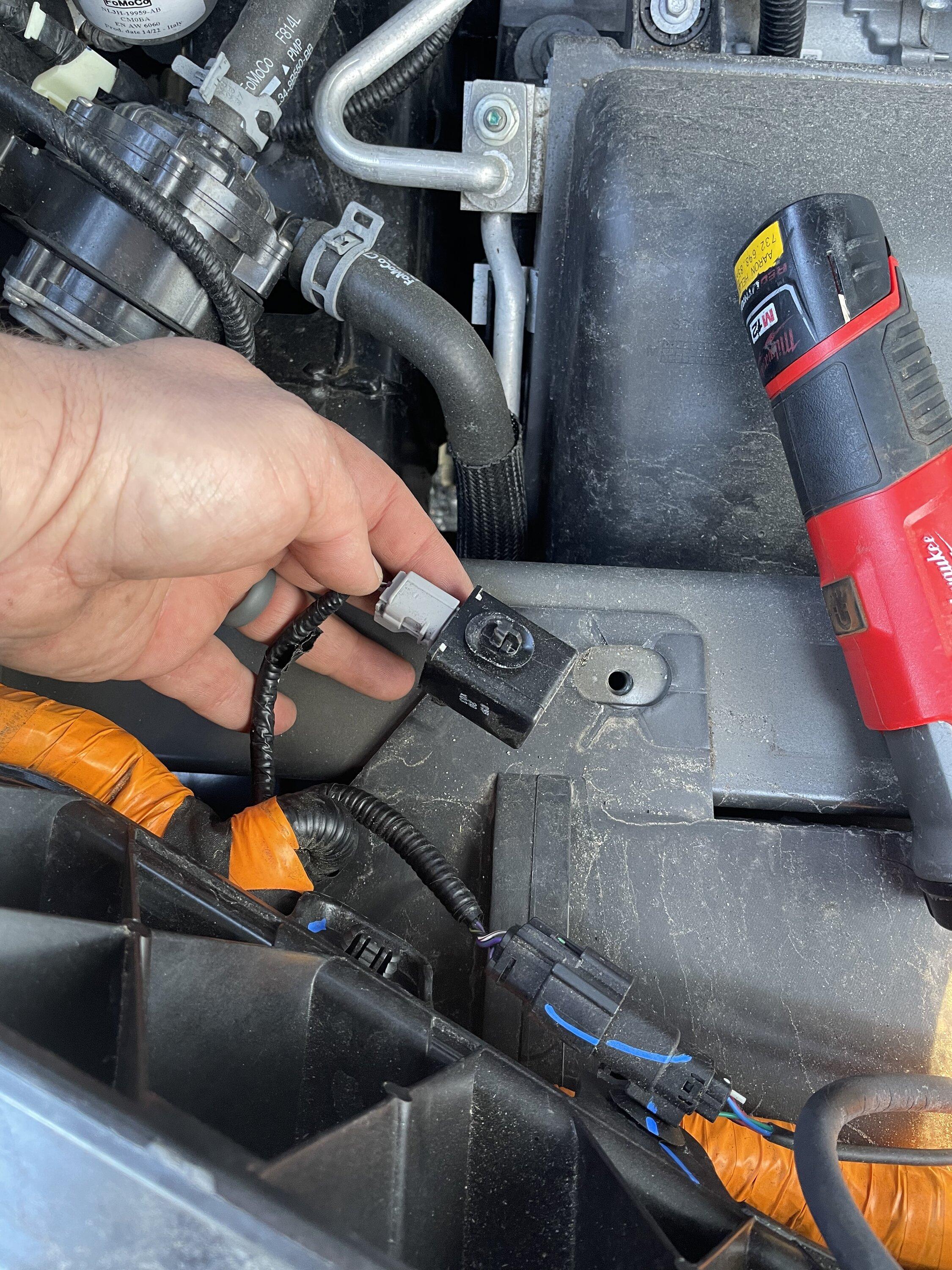

I can confirm from when I made the original post that there are no codes. The truck has no way to tell if the buzzer is operating or not due to its design.
Just got back from taking it out! n I spent awhile trying to do it from underneath and from the front passenger wheel well. Nearly impossible, frunk had to come out

Not sure if this was mentioned, but once I popped out the module it was very easy to reach. Actually delayed doing the mod because I wasn't quite sure about that.

Speaker removed thanks to the video. Much appreciated. Maybe I missed it in the video but I had 2 - 13mm bolts in the subfunk as well, so 8 total. Easy to figure it out but thought I would pass it along. I also used painters tape to attach the harness in an easy to reach place so I can reattach if necessary without removing the frunk next time. Total time was about an hour and the kids loved looking 'under the hood' at the battery/front motor.

Well, using the remote to disable the beep while you back up, then enabling it after you finish backing up solves the issue. If you forget to turn it back on, you can get the variant that has it normally on and it will be on next time you start the vehicle. The sounds come from the same speaker, there is no solution (like Forscan) that provides 1 without the other.
A lowpass filter would only work if the speaker is getting its audio from a source sending it through the wire. I believe all the sound components are contained in this little speaker. It's just sent a turn on/off command for each sound type. It would be redoing a PCB board if you wanted to isolate one from the other.
Are you sure of that? I actually find that hard to believe because it would make it impossible for Ford to software update the sound if they ever thought they had to - see Tesla for example, the sound is all software.
@WillB17 have you ever removed this speaker? Is it just a regular speaker that a lowpass filter could block the beeping - IE who owns the "sound file" ?
EDIT: according to this post, it is indeed just a regular old speaker. So a lowpass filter might indeed do the trick. It also means, should be relatively simple to install a volume control... https://www.f150lightningforum.com/forum/threads/switch-to-silence-backup-beep.14620/post-311525

Tesla and Ford go about their hardware and software in very different ways. Tesla is designed from ground up and completely customized, Ford reutilizes as much of the F-150 ICE platform as possible. Look at the frunk speaker...just an on/off, enable/disable.
You could be right, but I would be surprised as this would be a completely unique feature that would require a non-standard F-150 module to output an audio signal to a vanilla speaker.

It's already confirmed it is a simple speaker from the other thread where the poster disassembled it.
