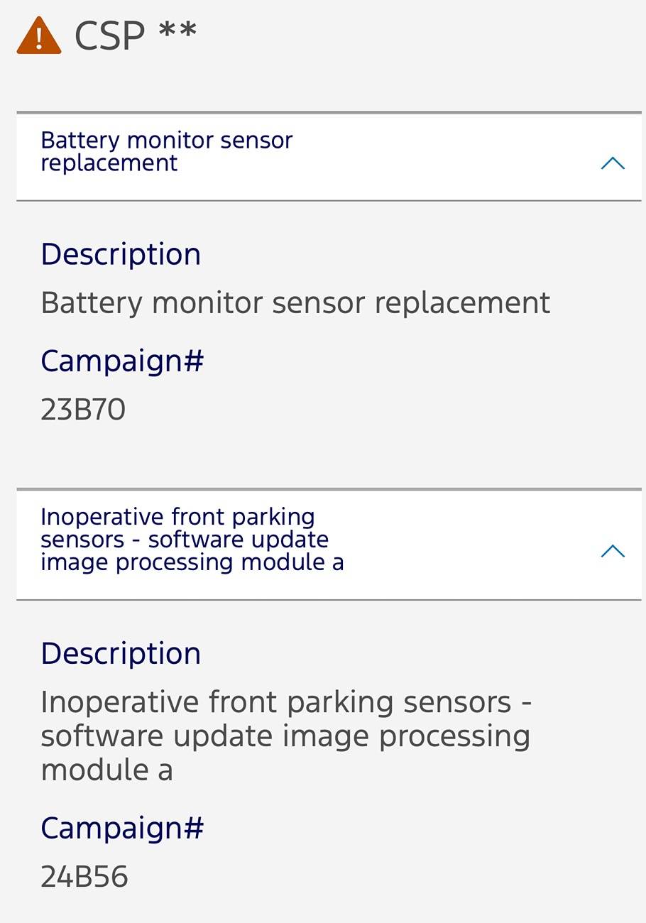

So for those wondering if your truck will OTA update to BC 1.4 if you have certain outstanding CSP’s. Mine did with both still not done yet. I’d say yes based on my experience
23B70 “Battery monitor sensor replacement”
& 24B56 “Inoperative front parking sensors - software update image processing module a”
both not yet completed yet….
BC 1.4 working just fine.

Dealer refused CSP update a few weeks ago so trying again Monday.
I had the same problem back in August. Came back to the forum and found Mike G.'s post of the original CSP bulletins to owners and dealers. It's pretty clear all vehicles within the affected time range get the sensor update:
https://www.f150lightningforum.com/...sp-24b56-front-sensor-error.21470/post-421878
To celebrate 2025, after the New Year, I plan to get Ford to nudge my dealer, and then, hopefully, I won't have to haggle with my service rep to get it done.

So what are they going to do for the CSP if the OTA has already updated the IPMA??
If you get the BC 1.4 update (either OTA, or by FDRS) to the IPMA and PSCM modules it will be an update to the IPMA/PSCM updates that you never got that came out a couple of months ago as part of the 24B56 IPMA front sensor fix.
The CSP FSA (24B56) will still likely be attached to your VIN (as it is right now) and will stay that way until your dealer service advisor clears it, or months and months from now somebody runs a script on the server and figures out that your truck was updated by an OTA or a tech, or by you with your personal FDRS subscription.
My truck just went in for the 10K service and I had three FSAs that I had done the updates for personally. Dealer signed them off (there wasn't any software that needed to be updated), so the job was done and the FSA 'campaigns' were cleared from my outstanding FSA list.
Once again, for clarity, if you get the BC 1.4 OTA....or you do the current IPMA/PSCM combo using FDRS, you will have the IPMA software that would give you BC 1.4 functionality, and would also correct the front sensor issue if you never had the truck in for that a few months ago.
