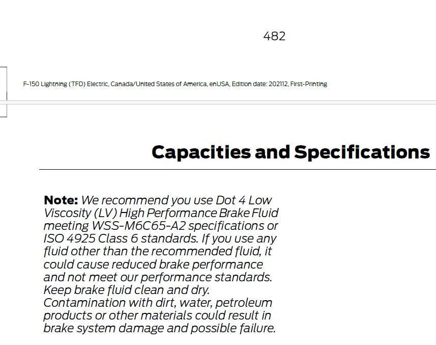

OP here. Its 11 degrees and dark. I will tomorrow. But I have not seen any sign of a leak. Seems as though it would be easy to spot on hard packed snow where I park, Are these DOT 5 or what, and seems like there shouldn’t be a leak after only 15,000 miles.
I take it that on your trucks the pedal does not collapse. What about a leak in the power brake system (an air leak, maybe)?
188
14,185
15,331
DOT-4

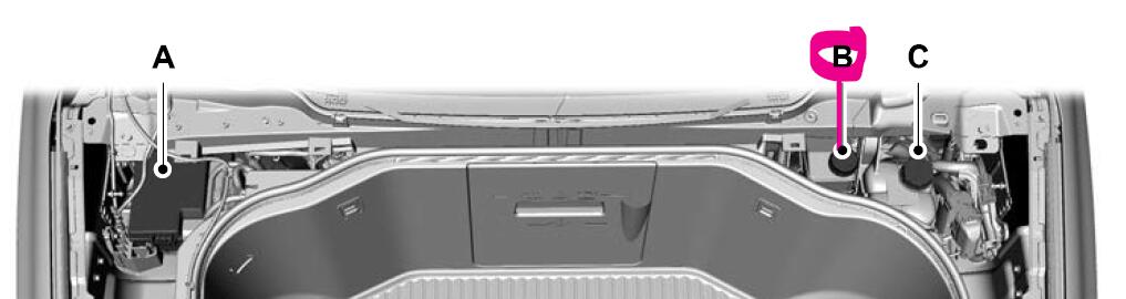

IIRC, there is a little settling, but not to the floor.

Not normal. Your brakes need to be bled. Why do your brakes need to be bled?
Air doesn't just get into brake hydraulics. Maybe the reservoir is low? Why is it low? A leak? Low from the factory?
Brake fluid is hydroscopic. Water in brake fluid can boil causing air in the lines. It would require heat to boil and a functioning brake system on an EV doesn't generally cause excessive heat.
Your entire brake system needs to be inspected. Check the reservoir and note if the front and/or back reservoir is low. If only one side is low you have identified where the problem is. Check the wear on the brake pads and look for any signs of seepage.
