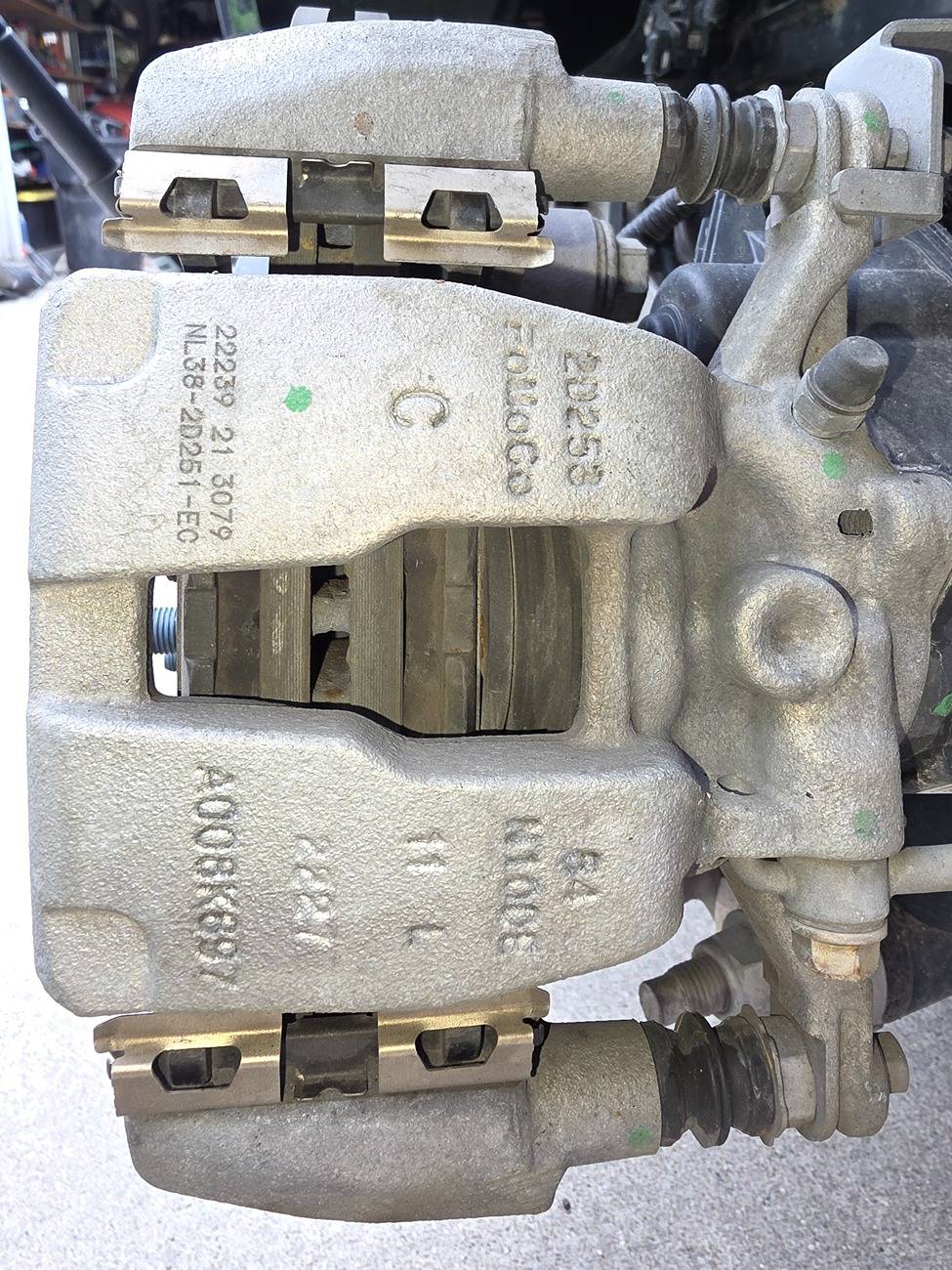

I just rotated my tires / put on the 3-seasons and this is my left rear after 22,000 miles and three Michigan (tons of salt) winters.
Ford F-150 Lightning Early brake wear 20250405_160459
