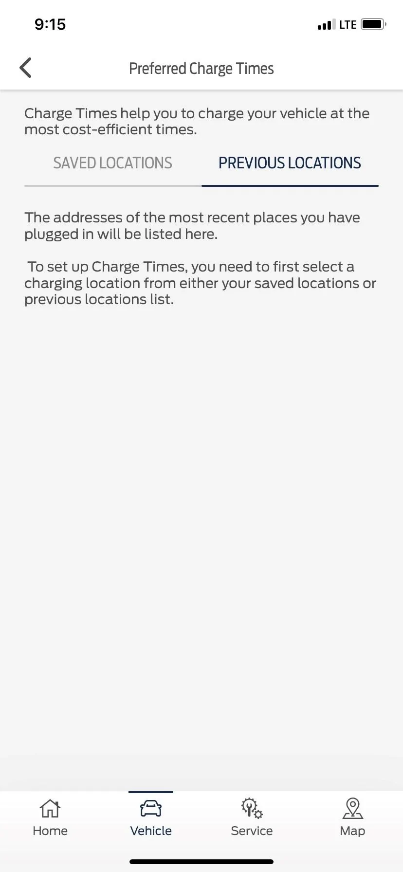

So I deleted my only saved charging location which is my home because it stopped charging during the set time of 1am-7am and was also charging to 100%. Before I deleted the location I tried to change the times and re-save but it continued to charge immediately when plugged in. Now after the deletion I can’t get my home to show up. I’ve done two charges. One I started and then stopped manually after about 30 minutes when that failed to come up as a previous location I then set a one time charge to 85% and let it complete that. Still does not come up in previous location so I can’t save a location because it keeps telling me I need to complete a charge one time at the location. Any ideas?

I can’t get it in either the truck or the app

Nothing. I'm just wondering if I changed a location or privacy setting early on because after I saved my home initially it has never listed another charger in my "previous" locations. Is it supposed to list public chargers I've used in "previous" locations?

Nope locations to set up preferred charge times. I cant get anything to show up here in either saved or previous. Ive tried charging at home like it said but still it wont show up.

How do i re-save my home so I can set up preferred charge times? Am I totally having a brain fart. It says I need to select a location from “previous” to save it. But with nothing there I can’t
Yup that part of the instruction is flawed due to the failure to retain history.
You can recreate a saved location by:
Driving the truck a few minutes away from your home so that the GPS system tracks a a fresh location.
Park at your regular home charging spot in the driveway or garage.
Plug in the truck and allow the EVSE to begin charging (assuming your battery is low enough, ei your not already at 100%)
After the charging begins, use the trucks Sync screen, go to the Charging menu in settings.
Slide the screen so you can see the the option for locations, begin the process of creating the new location, set the max percentage, then go to the next screen to set the first option weekday start & stop times, then tap weekends to adjust the start & stop times for Saturday and Sunday, then save the configuration.
After a few minutes this configuration should appear on the list of saved locations, make sure it's active (switched) on.
Later look at Ford Pass, you should see it listed in the "Preferred Charge Times" section under the "Saved Locations" selecting that you can rename it or adjust the parameters, note if you make adjustments always revalidate the start and stop times for weekday and weekend. then save the modifications.
Also make sure that the app shows the location selected as "Use preferred charge settings", not "Charge when plugged in"

I had it all working since December and made adjustments in the app and everything you mentioned but after I deleted "home" I just couldnt figure out how to re-save it.
I will give that a shot when I get home tonight. Thanks!
