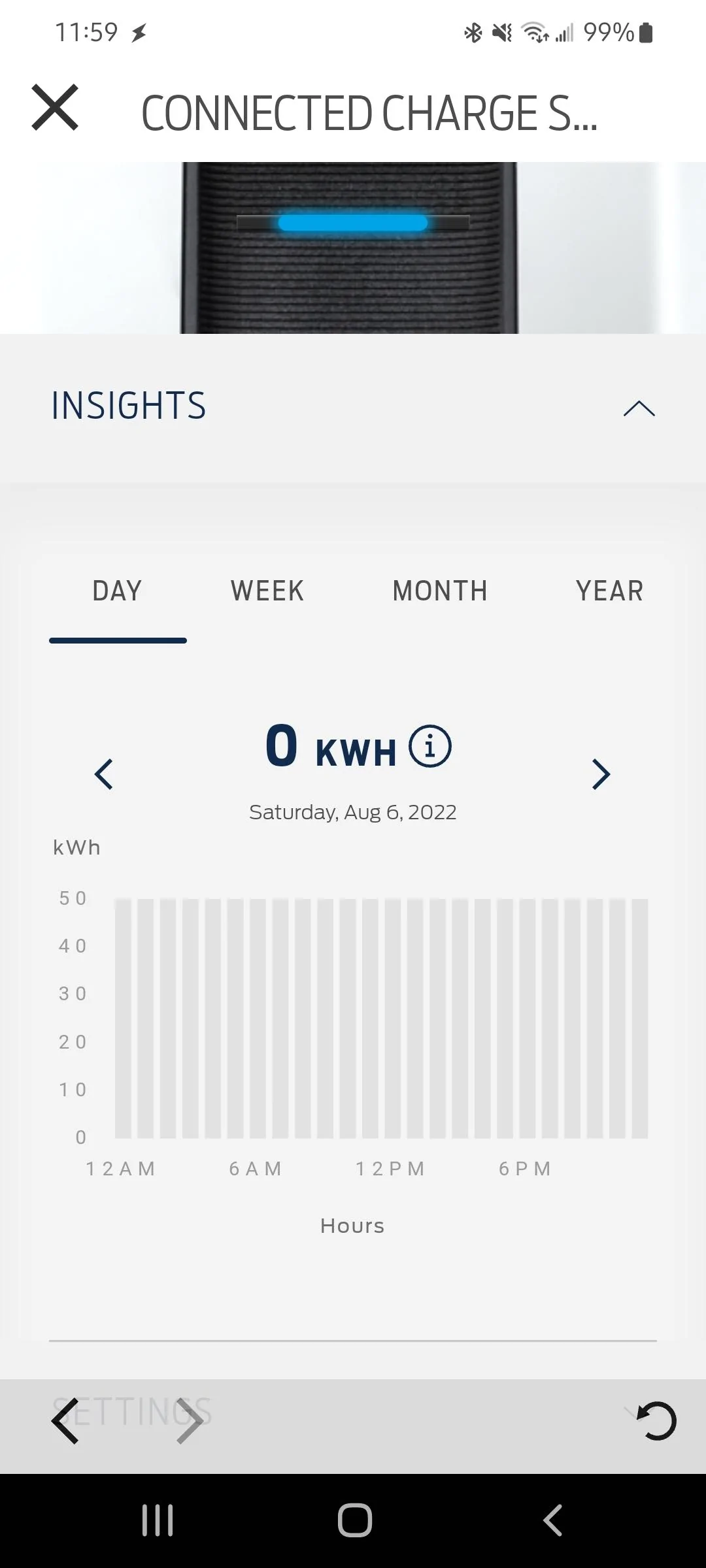

I was finally able to update the amperage on my CSP to 80 yesterday and can report that I successfully charged from 60%-90% without any issues or error messages, since the OTA update installed a few days ago.
The interesting this is that my charge sessions no longer show up in the Insights section of the app.

Yep same here...80amp seems to work, but I can no longer log my energy usage in the app.
Two steps forward, one step back
