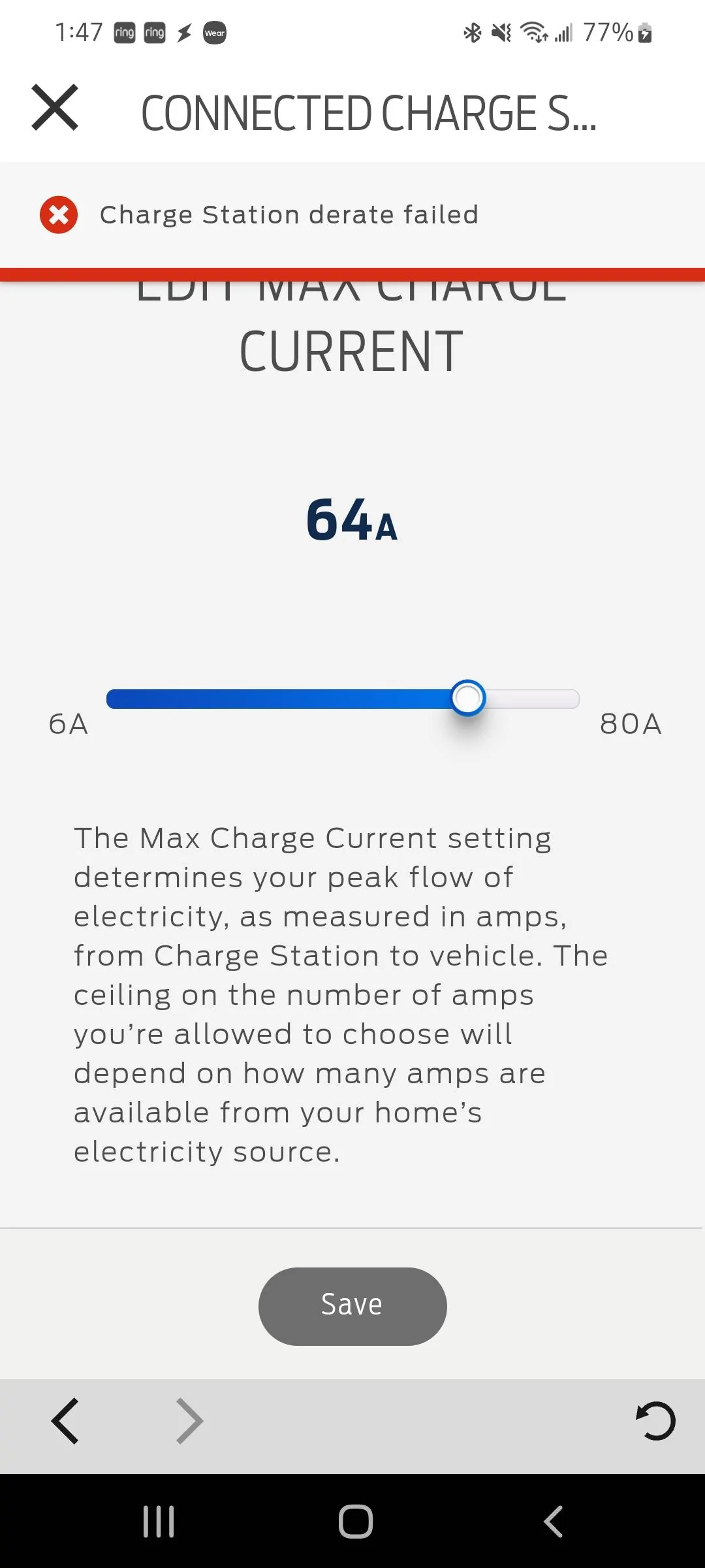

Ok I got the OTA update last night and now it fails every time I try to set the amperage back to 80. 🤷‍♂️
Ford F-150 Lightning Charge Station Pro Problems Screenshot_20220805-134714_FordPass

What version number did you update to on the CSP @bg226 ? Mine is still showing EVSE Software Version
2.112.64:0.0:0.0:0.0:0.0. . @Ford Motor Company can I also have this new update please?
