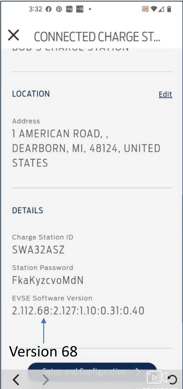

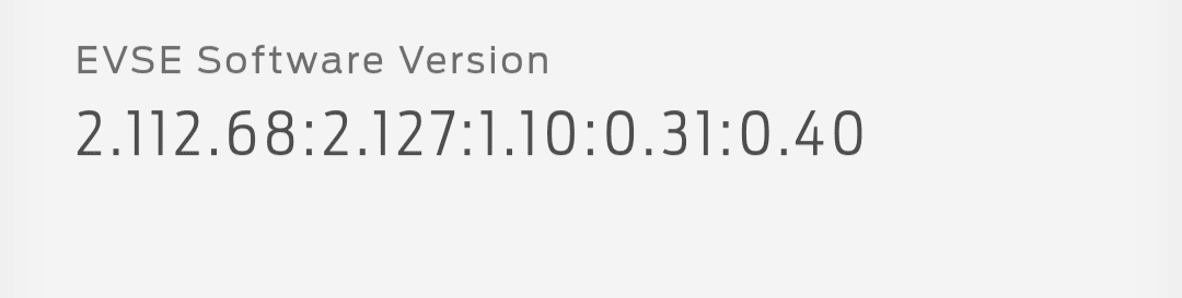

I have the same version number, but never got any kind of notice. Will try to set amps back to 80 tonight and see what happens (been at 60 since started having issues with trips).
Ford F-150 Lightning Charge Station Pro Problems Screenshot_20220805-201357

Did they send you that screencap? I’m assuming you don’t live at ford headquarters
Yeah they sent that. They said it should match that screenshot.
I have the same version. I only has mine installed/connected for 1 day, never received notice of any installed update.
I see now that mine is updated to this too. What were your results? I’ll be home again tomorrow and going to try charging at 80A and see what happens with the new version too.
