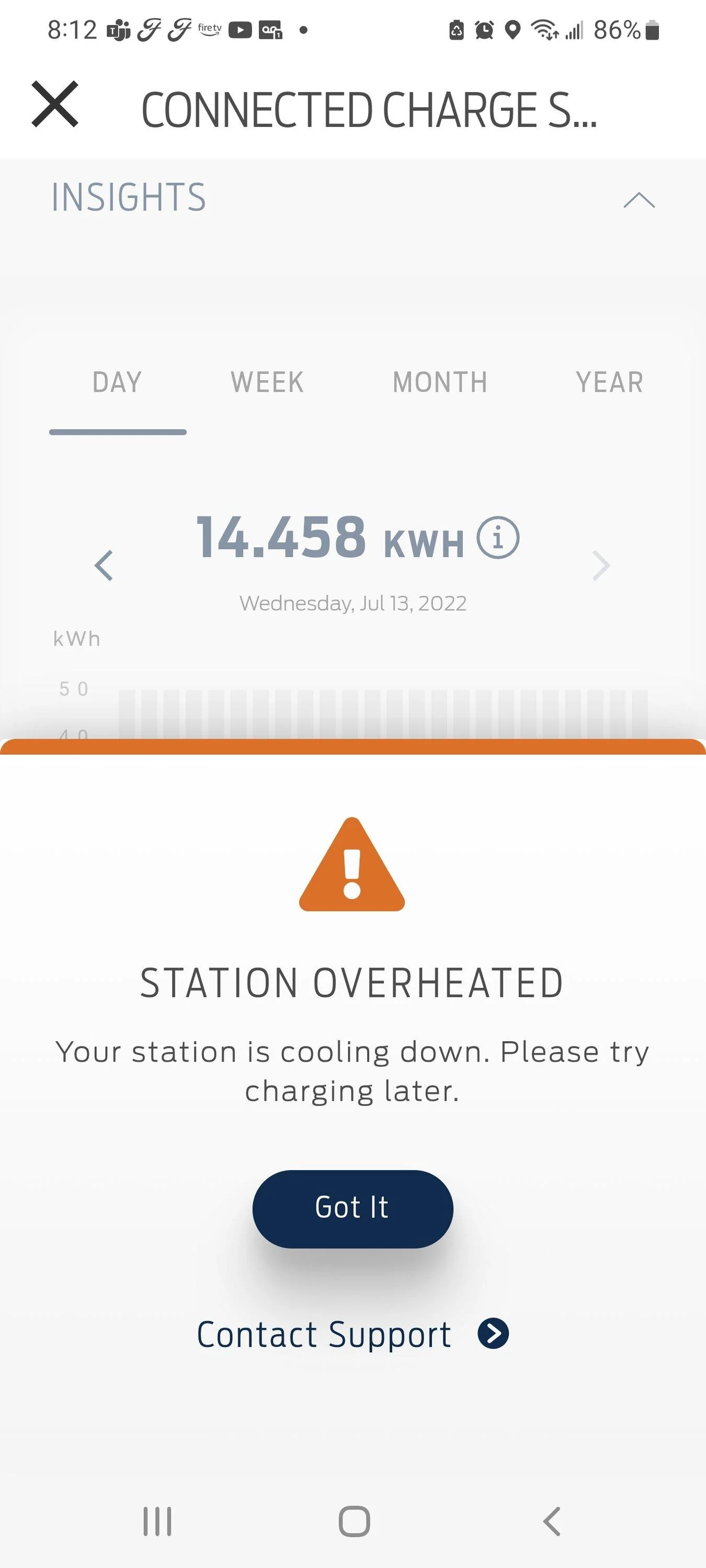

My charger worked just fine for 1 hour and 7 minutes. After that it has been non stop error messages.
Ford F-150 Lightning Charge Station Pro Problems Screenshot_20220713-201237_FordPass
Curious, what was the ambient temperature at your charge location?
hg020680
Hector
Jan 7, 2022
33180
Audi Etron, Audi A4, Mini Cooper S and soon F150 L
Regional Property Manager
89°, I waited 4 hours and tried again when it was 83° and it did the same thing. I then dropped the max amperage to 72 and it worked thru the night.
