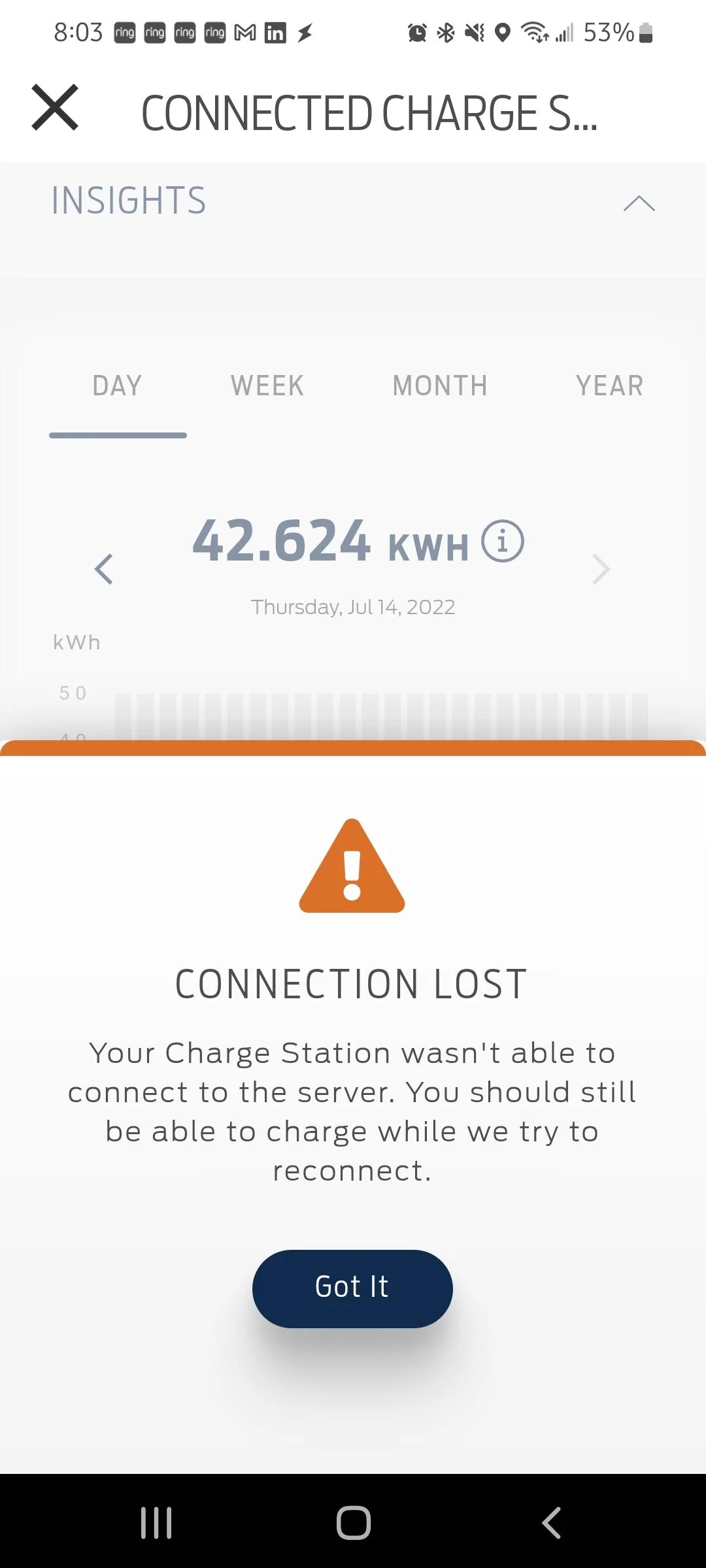

Another day and another hundred messages in the Ford Pass app telling something is wrong with my charger. BUT this time, when I clicked into the first message and clicked the Manage Station button, it took me to the charger screen with this new error message!
Ford F-150 Lightning Charge Station Pro Problems Screenshot_20220714-200309_FordPass

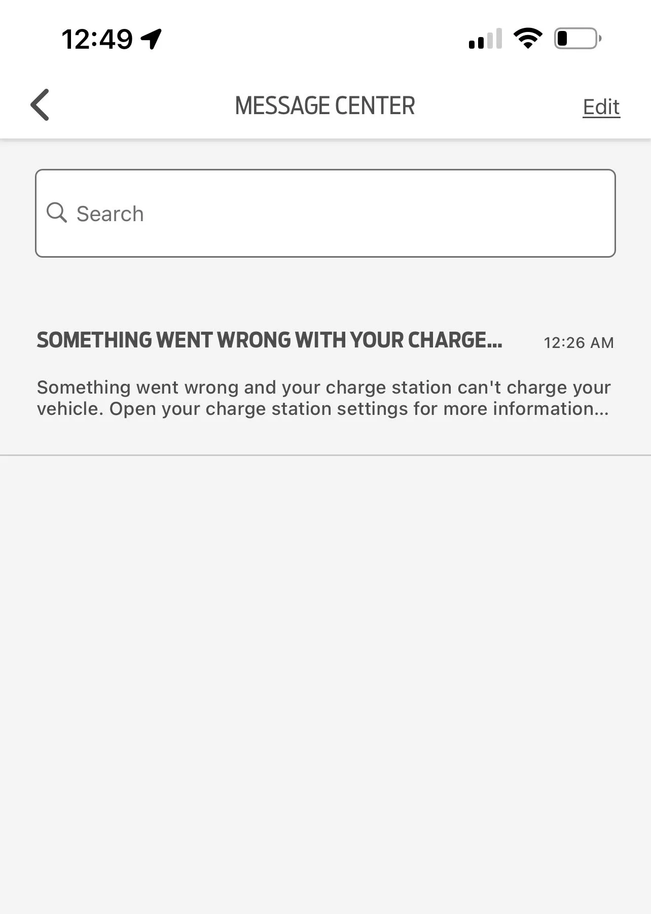

I finally got the overheated error as I was typing this.. It's 78 degrees here in the Hamptons currently and there is absolutely no reason my charger should be over heating.
The error above is the one I commonly get. 47 errors last night. Turning it down to 64 amps to see if that will solve it for now.
