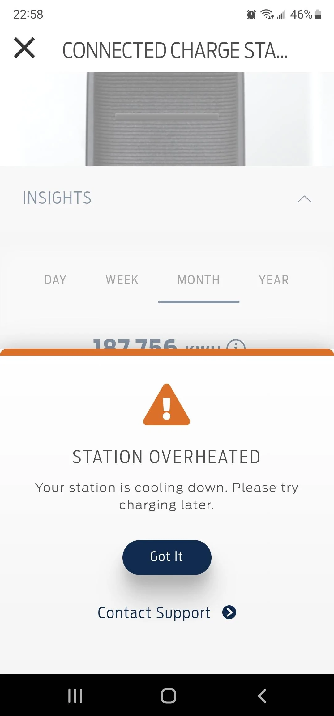

Im running a stress test today on my system by charging in the middle of the day and it’s about 90 degrees outside right now . Ive been watching the system and I’m seeing the orange light once in a while which indicates a fault and getting the overheating message.

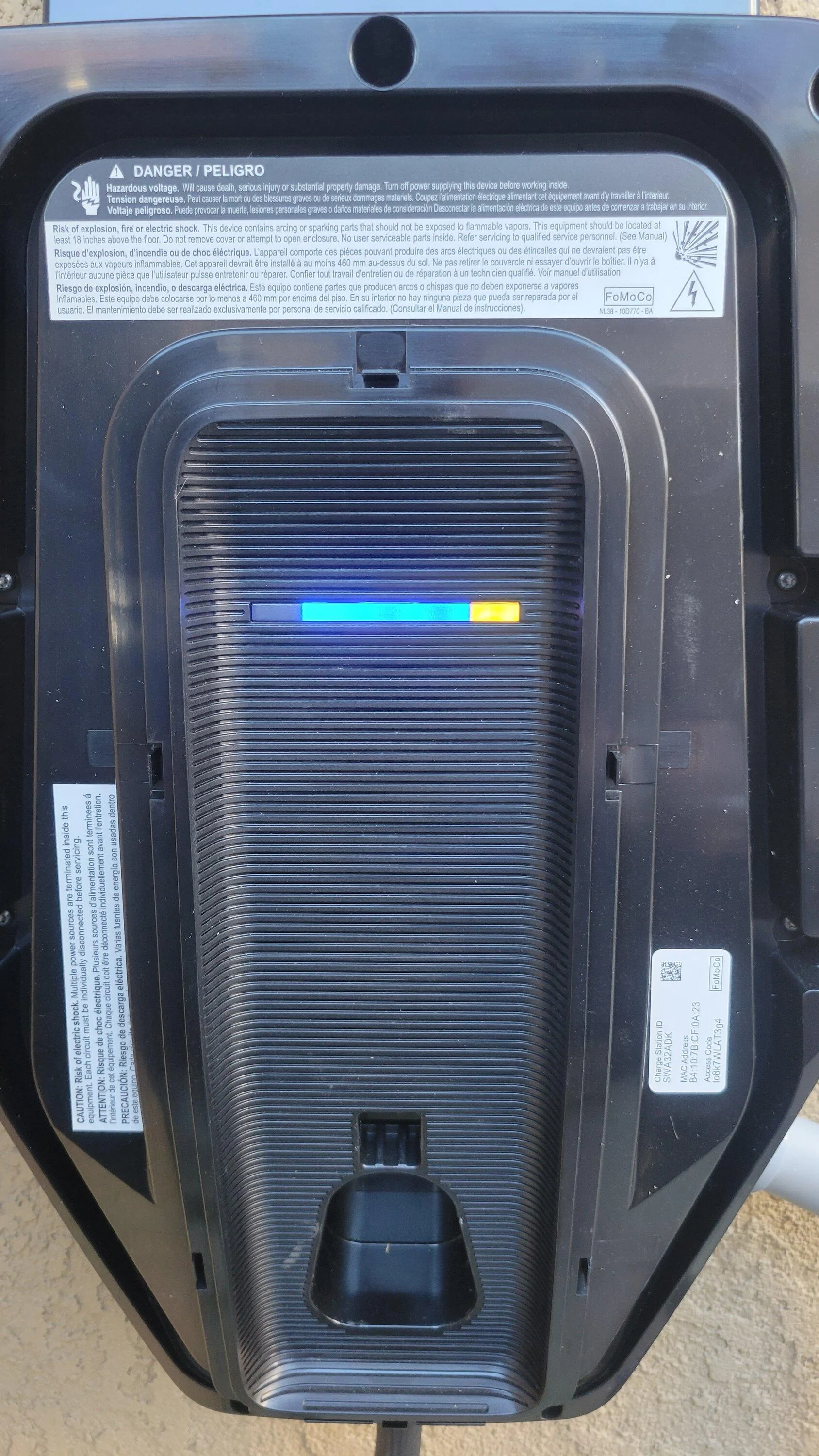

I unfortunately have joined the club. I can charge at 80amps with the cover off. Not just the trim panel but the cover itself where you can see the circuit board. I get temps of 150F on the terminals. The charger cable side was the hottest.

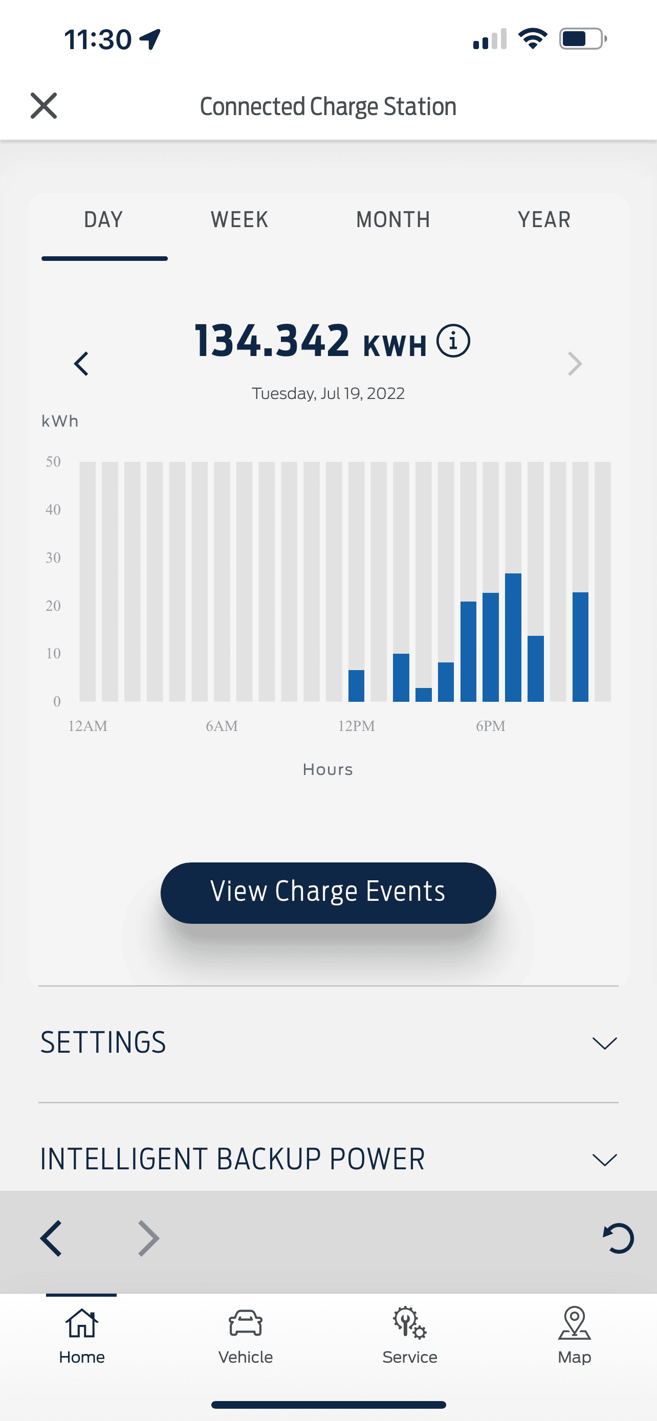

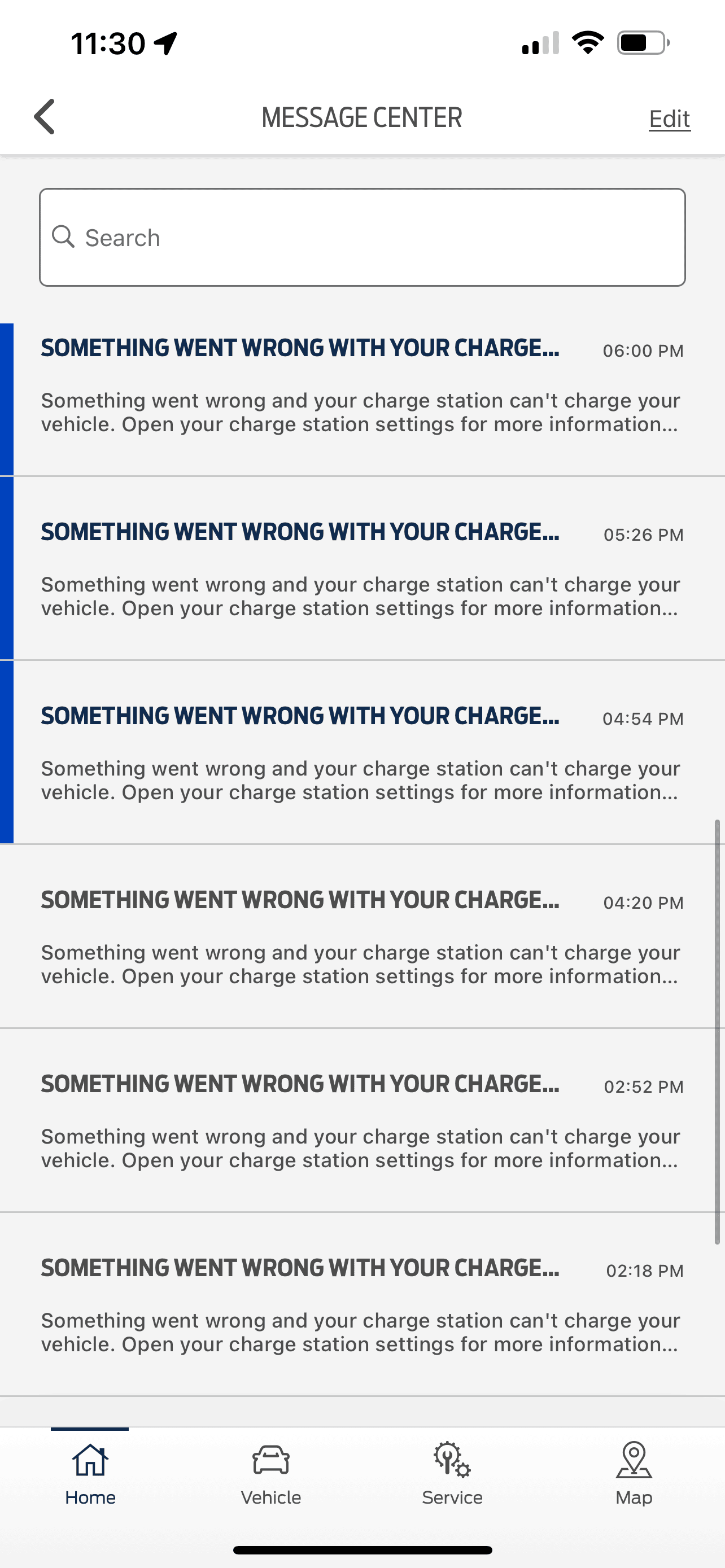

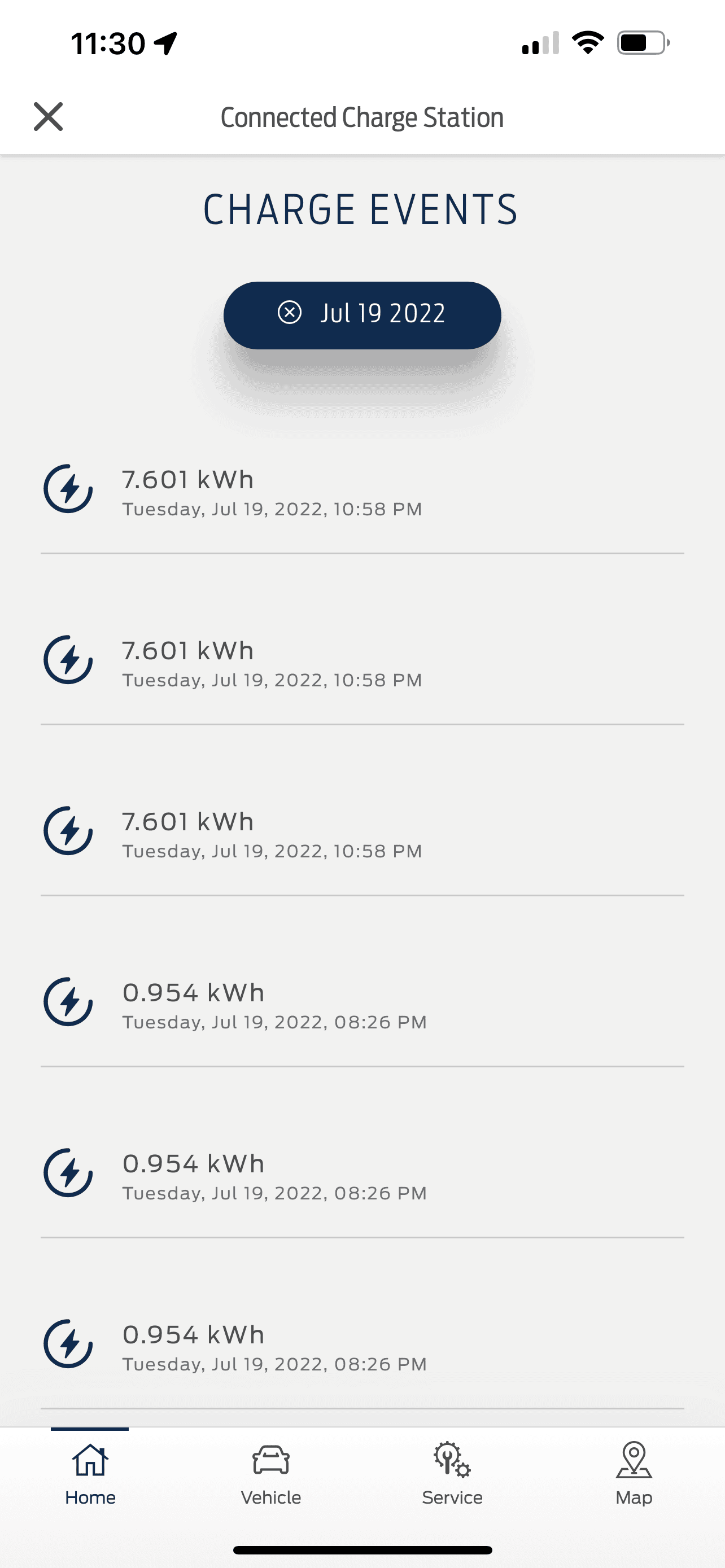

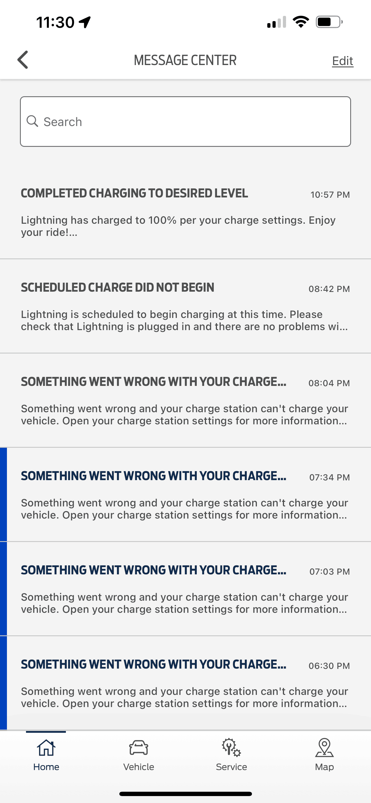

Here are the results of the stress test I ran today . Please see screen shots .
I charged from 60-100% but the charger says I charged over 134kwh . It posts multiple charge sessions as the same and multiple overheating errors . A hot mess. Literally .
My charger is located directly across the wall ( 1 foot run Id guess) on a 100amp circuit and it’s a foot from my electric meter. My electrician did say to me he used 1 gauge instead of 3 . I think

I have the CSP installed to a 100amp breaker on my panel and everything works fine, but I'm getting tons of messages on the FordPass app saying something went wrong. I see the list of charging events that coincide with the messages but nothing really gives me any idea what the actual issue it. It charges my truck just fine so I have no idea what's going on. Anyone else getting this?

I think they may have pushed an update out. I bumped it back up to 80 amps via the app and started charging it. After a while, it went from a pulsing blue light to pulsing blue light with a small solid amber light to the side, meaning reduced charging. I didn't get any messages in the FordPass app either.
