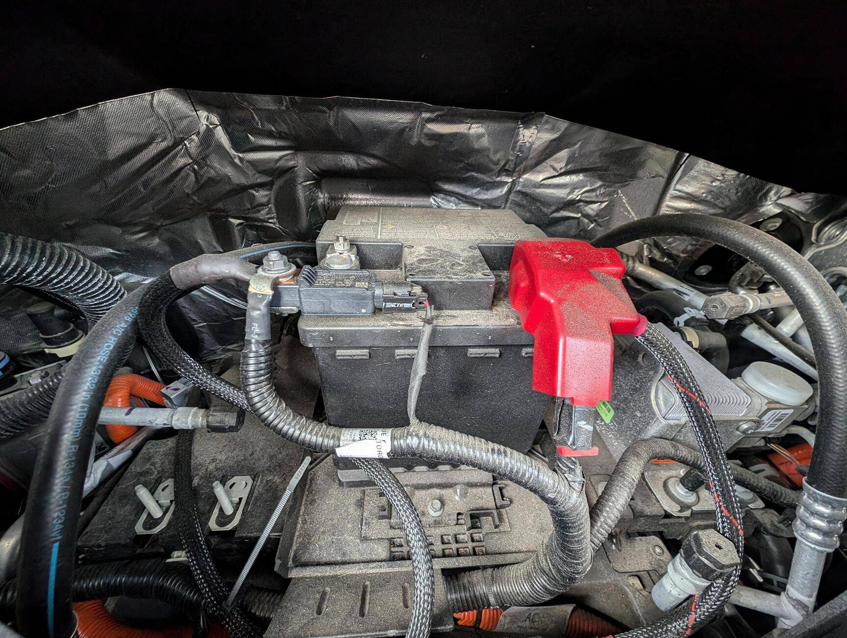

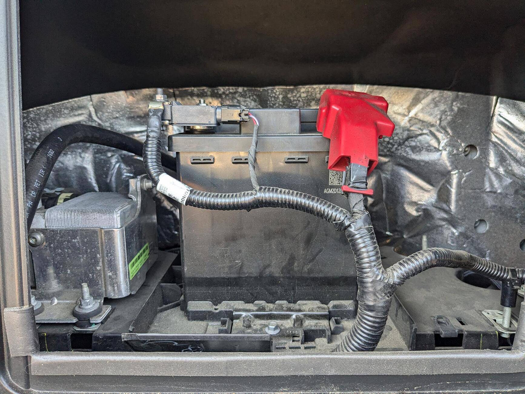

When you're looking at potential Lightnings to buy, don't trust a used vehicle features and options list unless they reprinted the original Monroney sticker.
You can confirm max-tow by opening the frunk, pull up on the 12v battery access door, lift up and away to remove it.
If you see the chiller module to the left of the 12v battery, you're looking at a Non-Max-Tow Lighting.
Ford F-150 Lightning Clarification on Max Tow Package contents? 1740518611274-36
If you see the chiller to right (driver side) then it has the Max-Tow option
Ford F-150 Lightning Clarification on Max Tow Package contents? 1740518717287-09
Good luck in your hunt.
