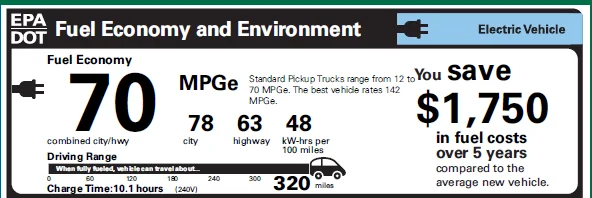

I have a theory that the Max Tow cooling loop is the reason the Platinum has an EPA range of 300 miles and every other trim has an EPA range of 320 miles. Max Tow is standard on Platinum but optional on other trims.
The other possibility is the 22" wheels but I've run both on my truck and not noticed a difference. My observations were not in any way scientific though.
My Lariat-ER was built with the Max Tow option and has a EPA rating of 320.
Stock AS tires on 20's, fixed running boards.
Right, but EPA rating is not based on every possible option combination. My theory is that the EPA ratings are based on trim before options, hence lower range for Platinum. It could be wheels but I've never seen an ICE vehicle with a lower EPA mpg because of wheels. I could be wrong.?
