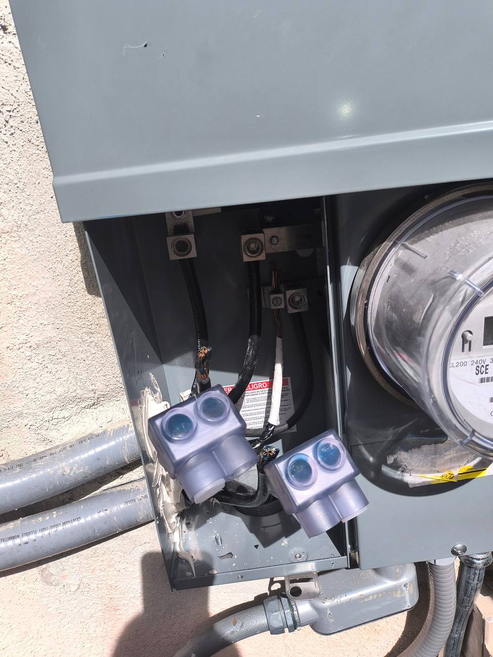

I got my electrician working on it but it seems the WHB is not wanting to send power to the grid. The electrician disconnected it between 1 and 2 and it didn't work. Same issues. Do you know if there is a setting in the m professional app that I need to change or enable?
Unfortunately it is really hard to see how this is all connected in your setup. Even in a grid outage the WHB still needs to be connected to your panel board. I was hoping there was a disconnect in that box but it is just wire nuts. I am not sure how you can simulate an outage without disconnecting the meter can.

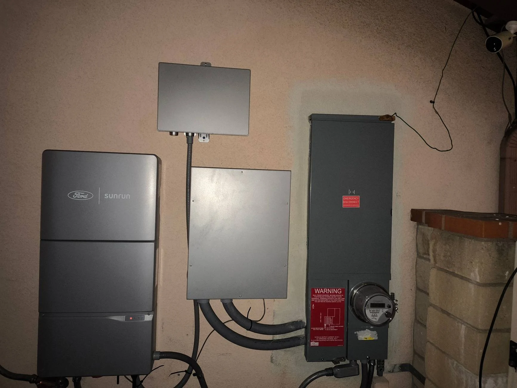

Let me know if this picture helps. I disconnected the WHB from the grid.
That looks like it should be correct. When you did this, did the truck come on correctly? This sounds silly but your main panel breaker is still on correct?

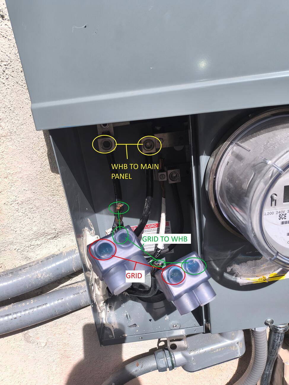

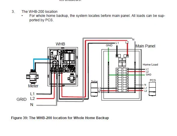

Here is how it is wired.
The truck comes on and is transferring power, I see the meter is connected to the WHB in the diagram and mine is connected to the main panel. Solar and EVSE show voltage but no amps running through in the M professional app. The main breaker is also on.
The consumption meter should actually turn off, when the power goes out. My meter is inside the WHB. The CTs should be on the grid side of the WHB.
When you disconnect the grid power you should hear the relay in the WHB click over.
At this point it is very hard to tell what is going on without looking at all the wiring. I am quite sure there is something in there. It might just need a complete reset. It would be really nice if your electrician could add a disconnect between the grid and WHB. That would make this much easier to troubleshoot and test.
Did you take pictures of all the device wiring before the covers were put on? If so those might be helpful to look at.
