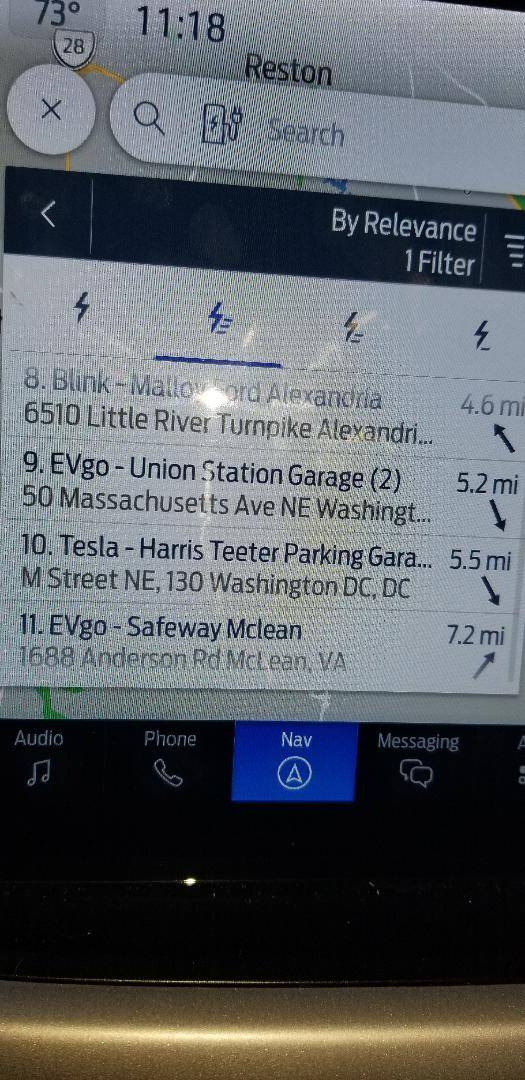

Here is a screen of my 12-inch NAV with a CHARGERS search, filtered for the fastest DC Fast ones (yes, NAV can filter for charging speed). See the #10 selection - a Tesla Supercharger point at a Harris Teeter across town.
Of course, this fails to find the eight or nine Tesla Supercharger points closer to my location in my urban agglomeration.
The truck navigation will show Superchargers with built-in CCS adapters that are open to all EVs. No NACS adapter required, which is why they show up in the CCS filter in PlugShare.
Google “magic dock” to learn more. They’ve been around for a couple years.
