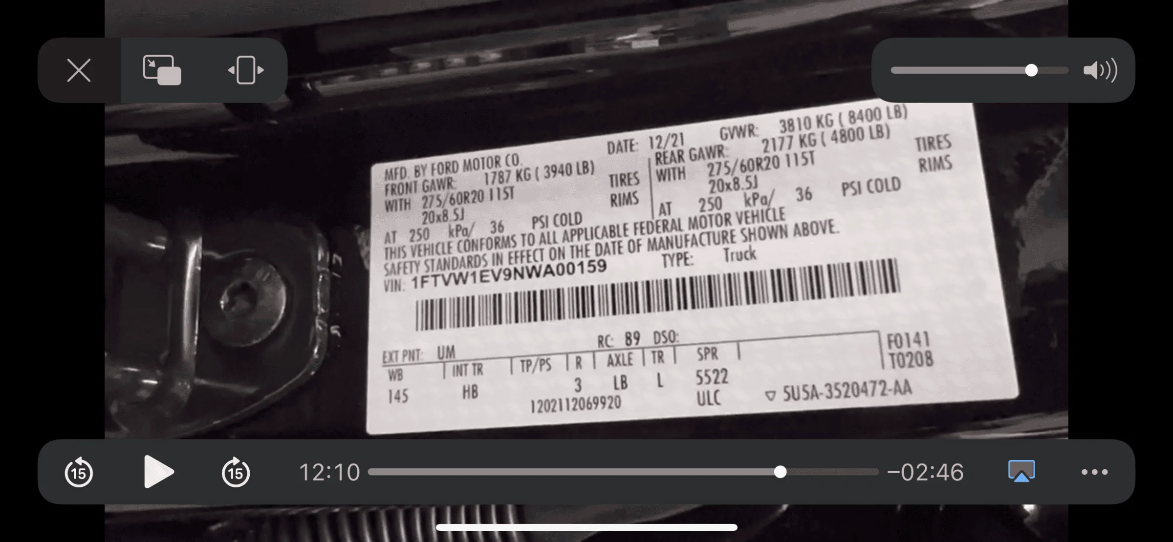

I misspoke, it's the other sticker in the same area, in this example the pre-production model build truck was built December 2021 [12/21] at the bottom is the blend date of 12/06/2021 [120211206]
9920 is the production sequence number found on the top of your window sticker.
Question on GVWR. My SR Lariat says 8250 on this sticker but I went to a DMV certified scale and it was 6600. How can that be ?
This is kind of a thread hijack, but the GVWR is the maximum weight of the truck + payload that is safe (You can carry an additional 1,650 lbs).

The GVWR rating sticker on the drivers door pillar is your Month/Year of manufacturing, while various parts will show a variety of productions dates as they are coming from jobber plants days/weeks prior the blend date.
Or after. My rear motors have a June build date while my truck was otherwise assembled the week of May 23, 2022.
