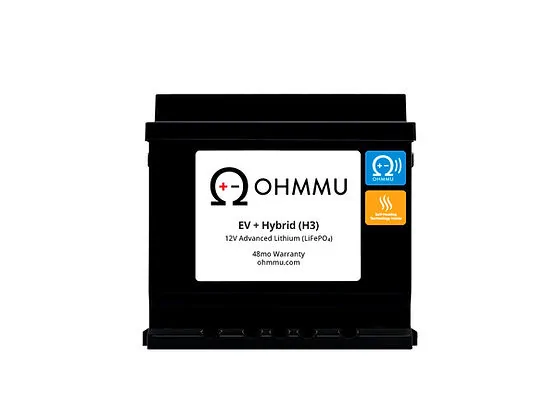

Mine turns 2 soon and I’m searching for lithium options, absent of any I’ll go AGM with mine. I haven’t found many yet, just this one so far from a brand I’ve never heard of. (*Note: The teardowns show this particular battery is NOT a good quality with potential safety concerns)
Interesting video, I saw alot of discussion people buying Ohmmu batteries. I think EarthX is floating around as a candidate for lithium battery. I do see a thread on the tesla forums about a person having issues with EarthX too though.

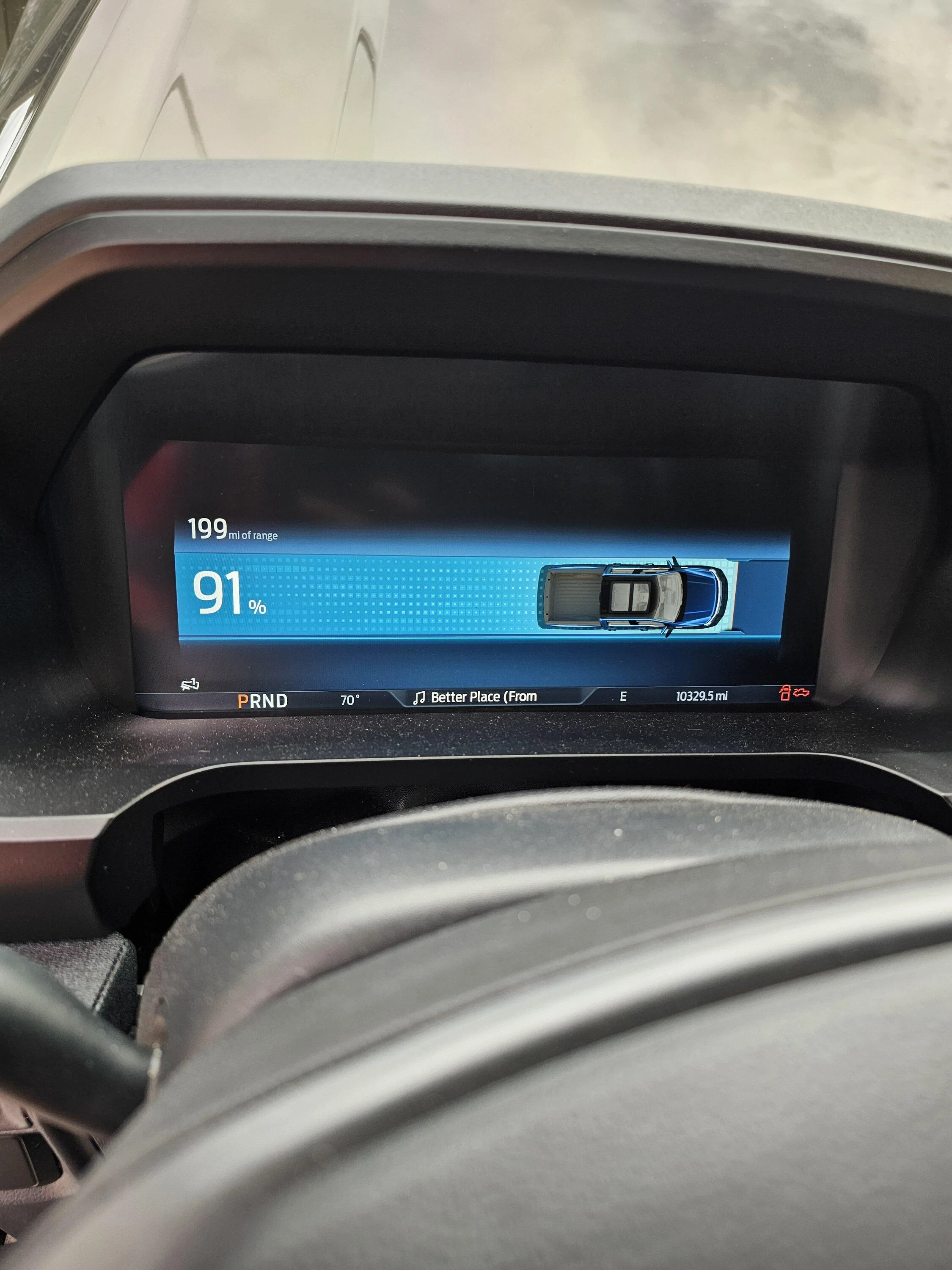

back to the OP topic, I had my dashboard do the same thing on two consecutive starts back on November 21st of 2023. Going to lunch, and 45 minutes later coming back from lunch. Here is my dash:
Ford F-150 Lightning *Fixed!* - Urgent! NO INSTRUMENT PANEL! 1703775858822
I happened to be taking the truck in for recall work (tailgate lightbar) and CSP (heated steering wheel upgrade) the following Monday, and had an open correspondence with Ford Motor Company via this forum at the time, so they checked it out while they had the truck. They couldn't reproduce it and seemed to write it off as a 1-day glitch. It hadn't happened since.
Just FYI, I was able to maintain speed awareness via Waze thru Apple CarPlay.

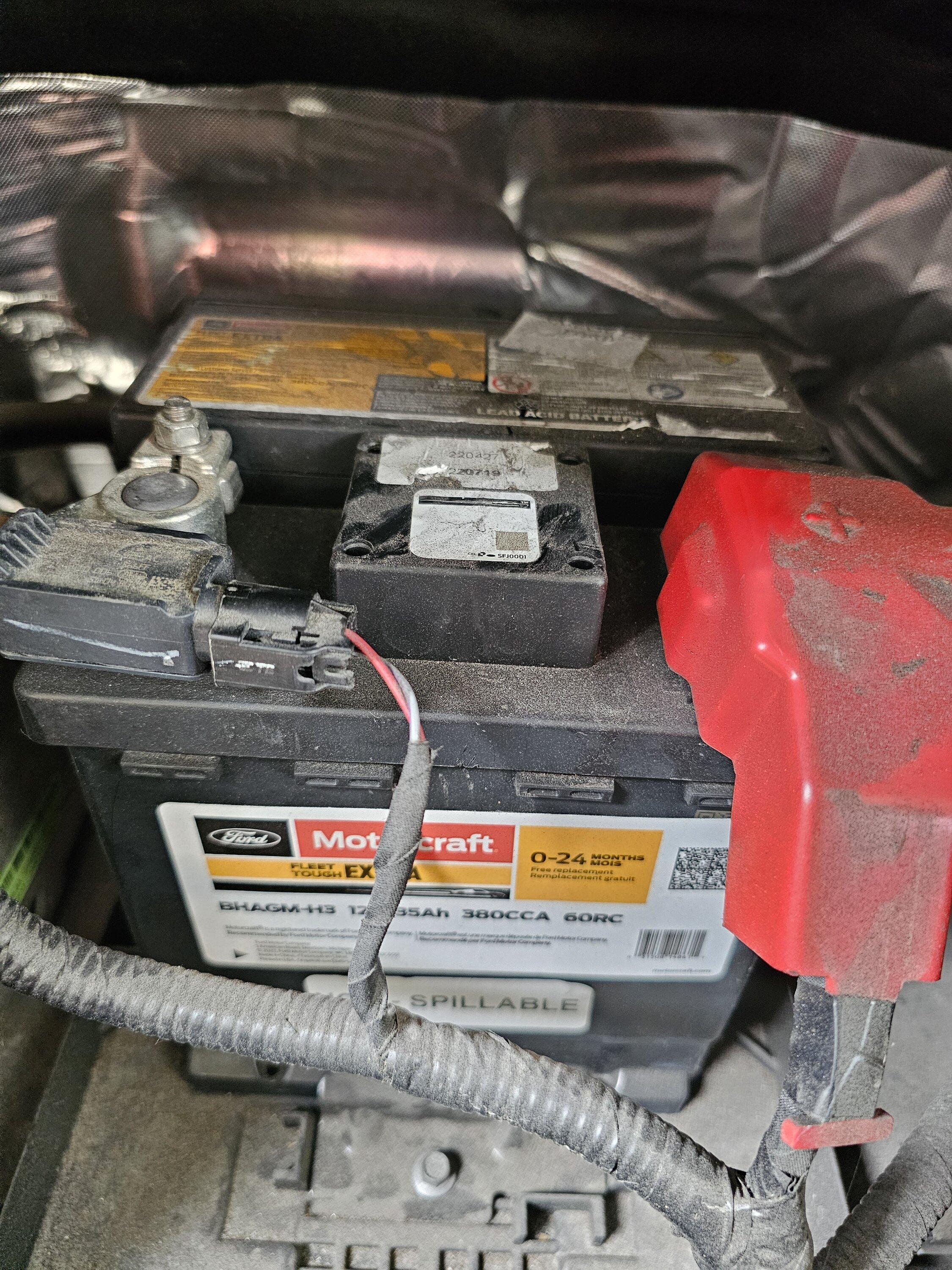

I'm planning to replace the OEM LVB with a higher capacity unit next summer when my truck turns two.

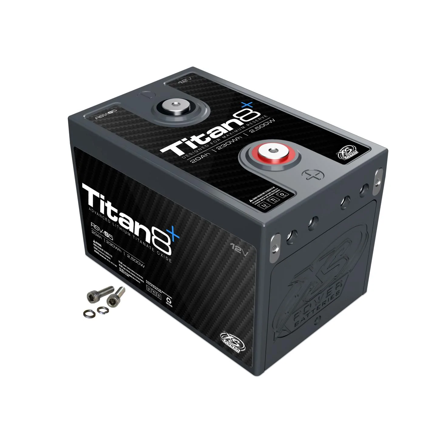

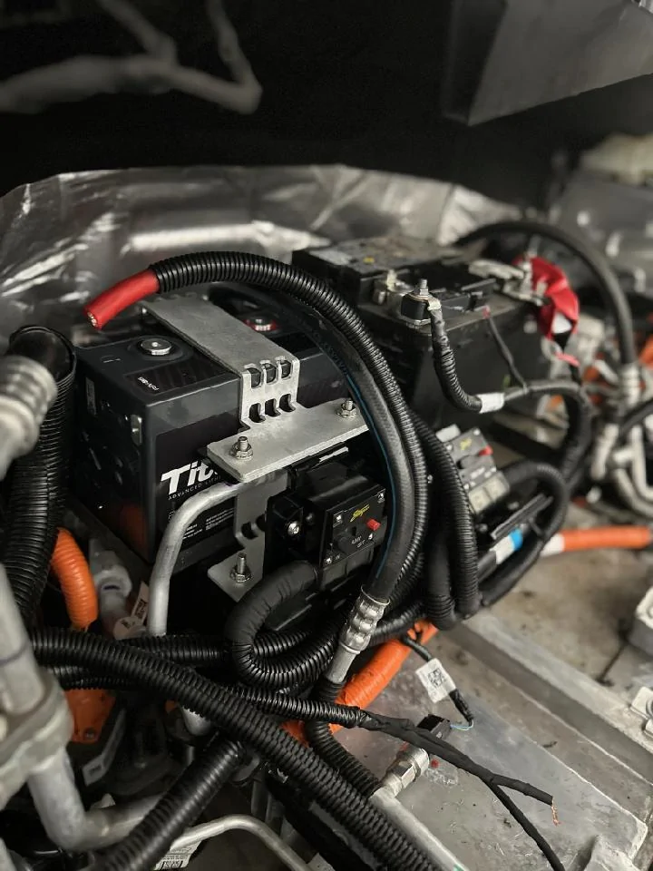

I have an XS Titan Power Lithium Ion Battery RSV-S5, wired in parallel with my OEM battery to assist my 12v system. I have several audio amplifiers and so far, the truck seems to be ok with the addition. I added it in August.

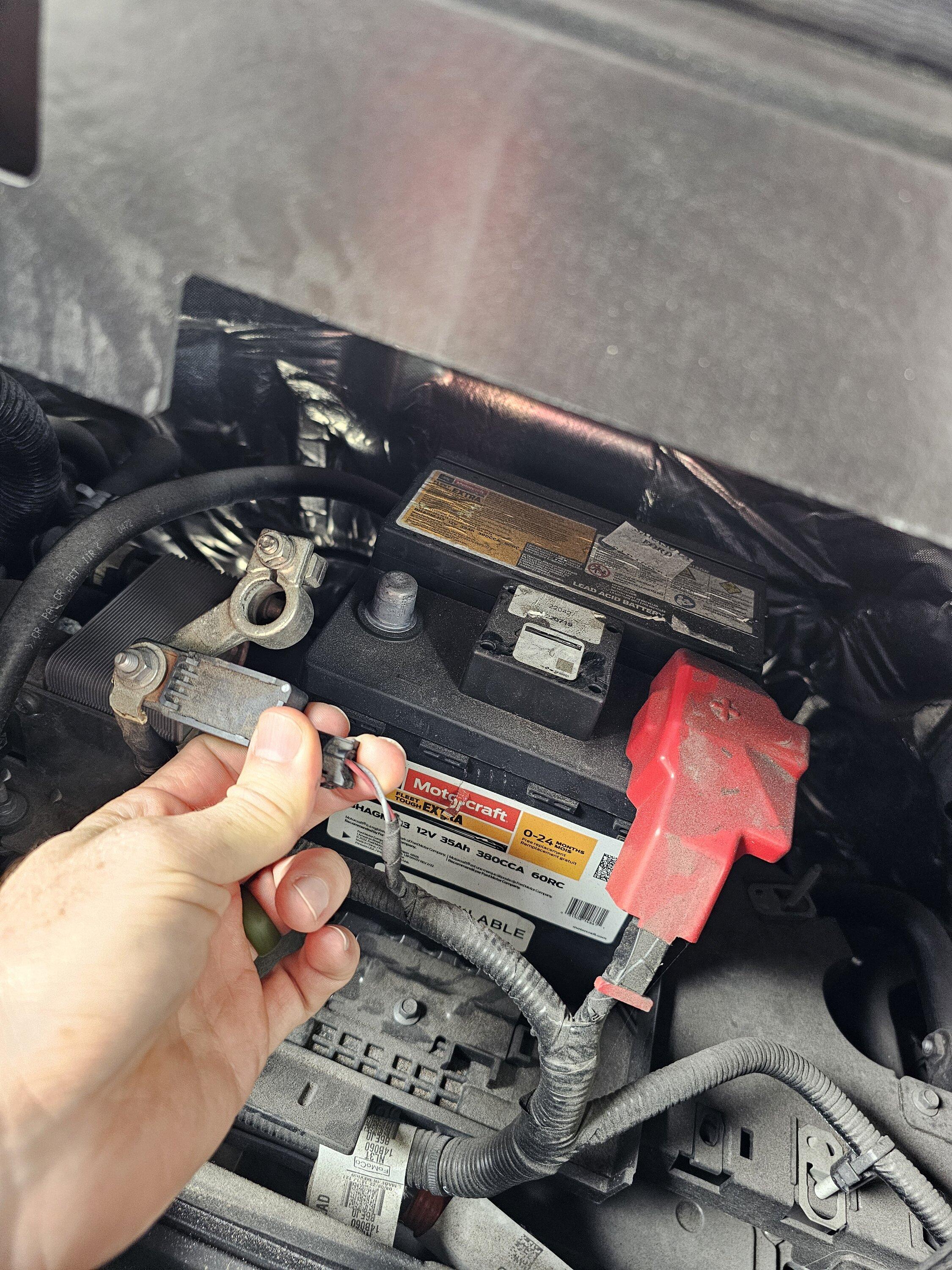

Time to pull the negative 12V battery terminal. Wait at least a minute and reconnect.
My hat is off to you. This just happened to me tonight, and sure enough pulling the battery worked like a charm.

Seems like 90% of the time disconnecting the 12V fixes the odd electrical issues.
