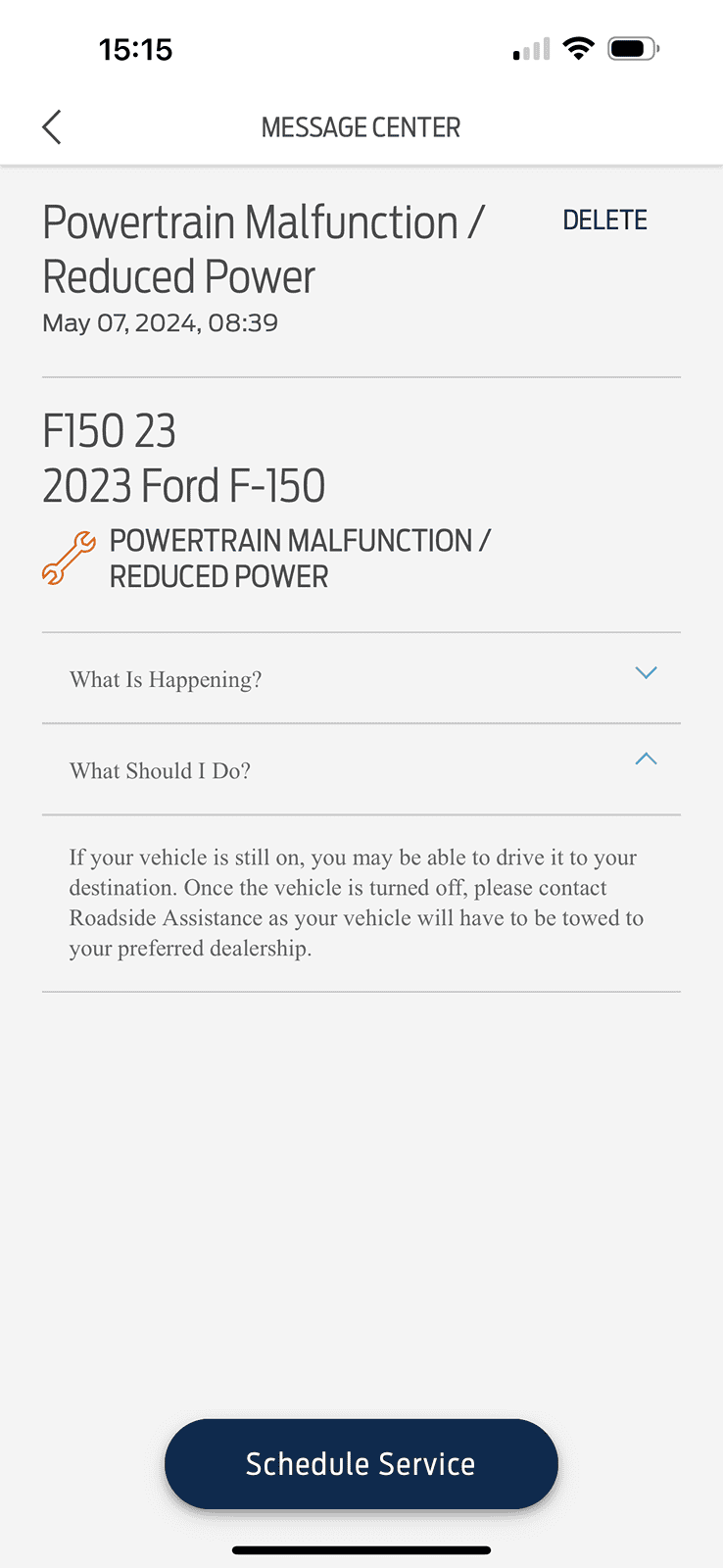

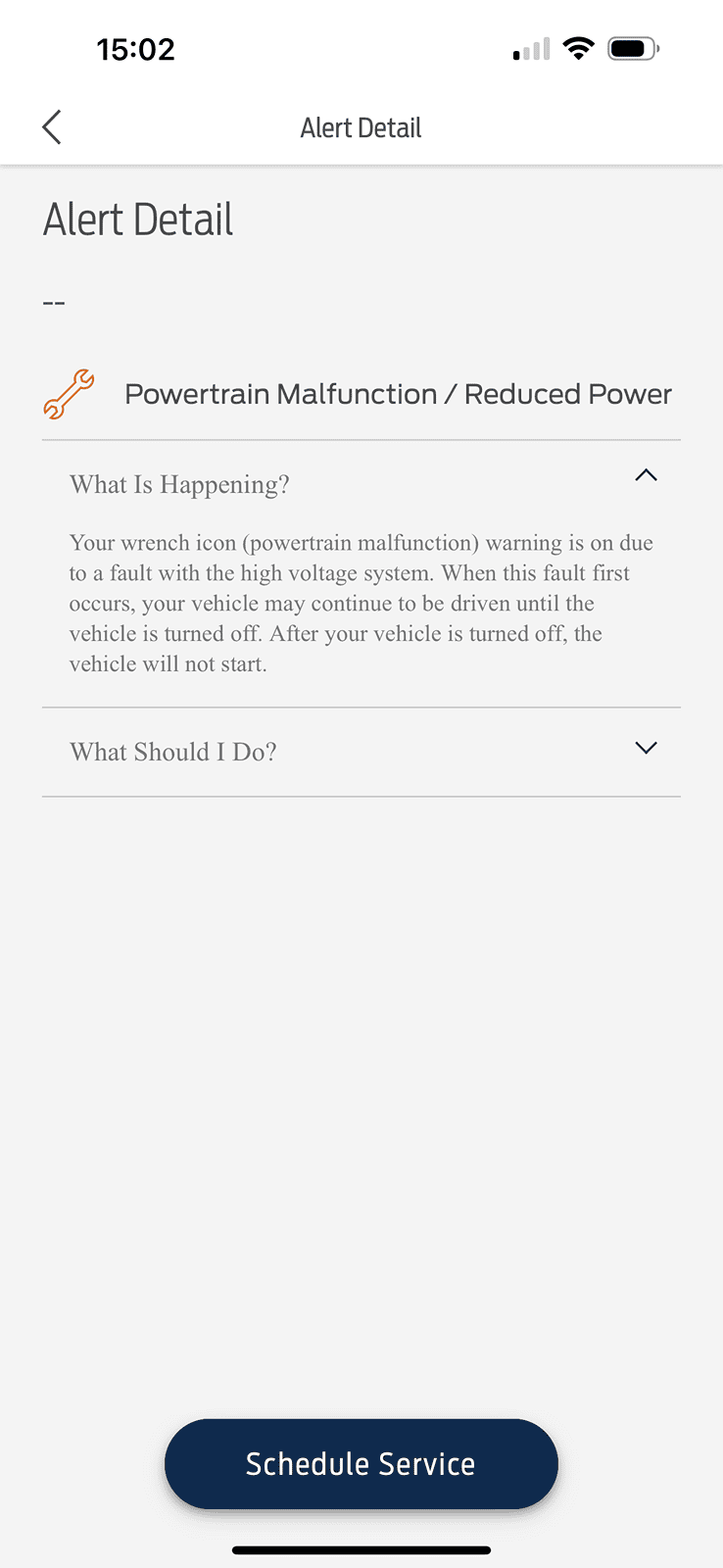

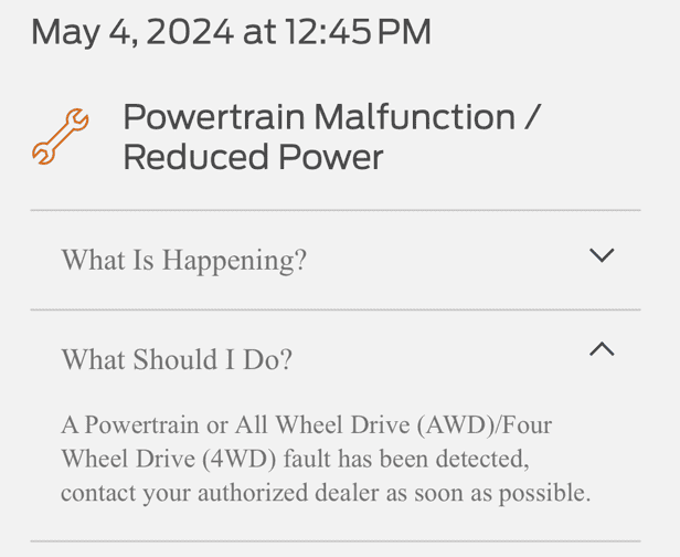

My truck just had the battery fault warning. Message said that it may drive until turned off and then it will not start. It did start and I was able to drive home. Service appointment is not available until next week. What do you think, can I drive it till then or do as the app message states and have it towed to the dealer now? This is my only vehicle so this sucks. Did any of you guys get a loaner from the dealer or did you hav to pay for a rental car?

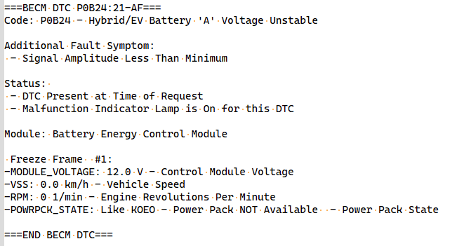

There must be different levels of severity for this dependent on what went wrong. My message has been less ominous. If you have a DTC reader you can see the specific error. Mine was: P0B24 (Hybrid/EV Battery 'A' Voltage Unstable). Dealer tests showed I had a battery module out of spec (still waiting for repair).
Note a Powertrain Malfunction is not always a battery module; there have been other causes.

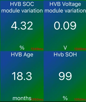

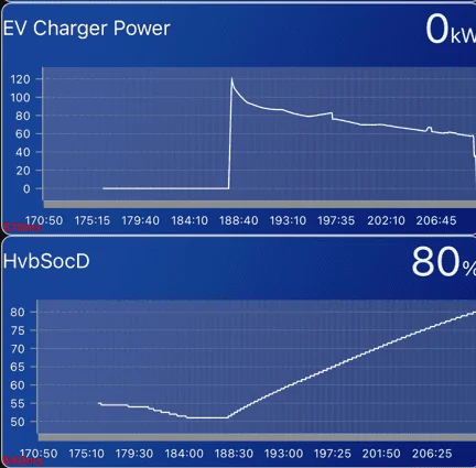

Actually I have found it to be more useful on my Lightning than my old truck. You don't need the old style plug-in/built-in screen ones. Simply get a cheap Bluetooth OBD dongle (I have this one) and use CarScanner or FORScan Lite on your phone. Search CarScanner on this forum and you will see all the different parameters you can use it for. It will also display DTC's.
DCFC session
Ford F-150 Lightning CSP-23B57 for High Voltage Battery Notice 1715120600401-o7
HVB health (not healthy :()

DTC for BECM - aka bad battery module

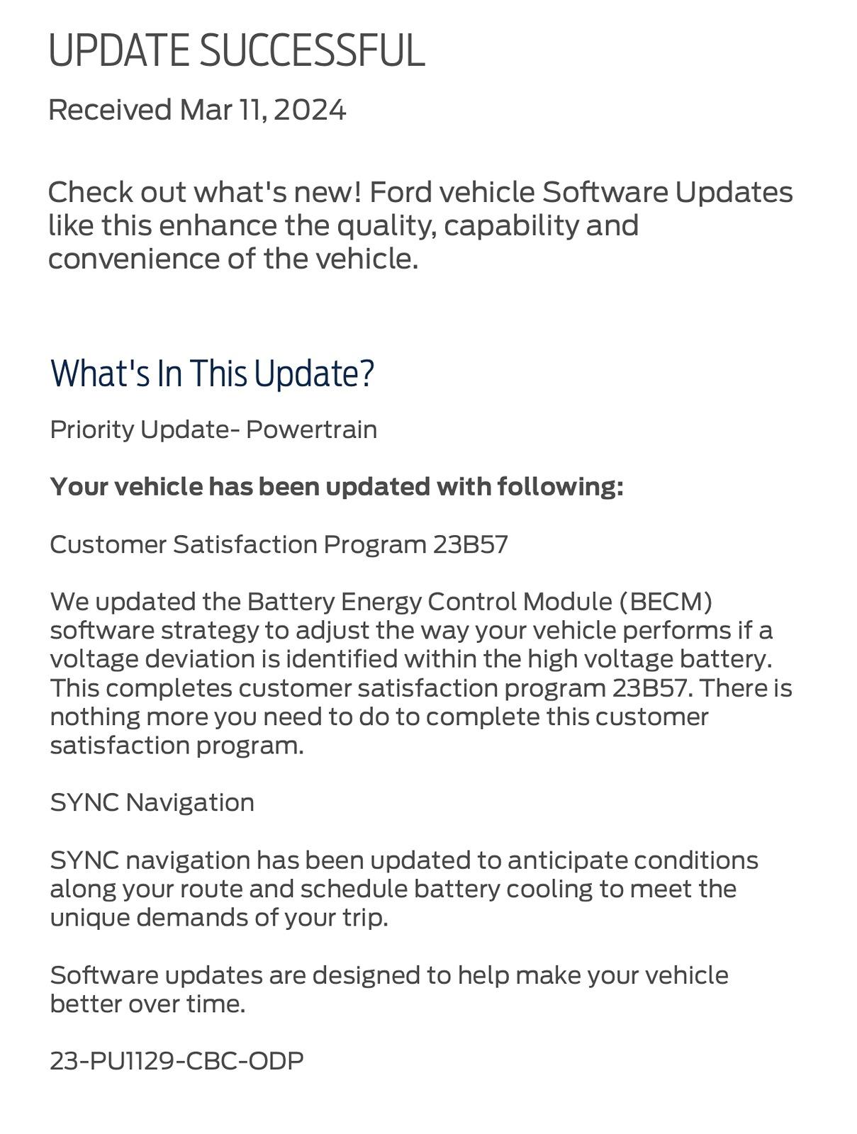

Message in OASIS this morning:
Interesting. I received the OTA update for the CSP on March 11 (see attachment). Not dealer forced, just the update Ford sent through. Are there issues with it?
