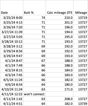

Something is very interesting when these modules go bad - or maybe someone can at least explain what is happening. Some say the've parked their trucks for a few weeks and not lost a bit of battery charge. However from the afternoon of 3/25 until 4/10 the day before my truck was torn down my ER battery dropped form 71 down to 63%. It lost 8 percent over 17 days and didn't move.

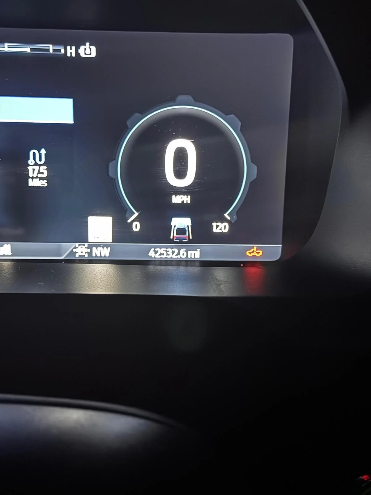

Hi, Im new to the club:
Ford F-150 Lightning CSP-23B57 for High Voltage Battery Notice IMG_1336 2
Ford F-150 Lightning CSP-23B57 for High Voltage Battery Notice IMG_1337
FML.... @rugedraw looks like your hunch was right about something not being right....
I drive my truck daily, only thing that was off this week was about two days ago it didn't charge at its scheduled time. The next morning when I unplugged it was still at 78% which is the percentage I plugged it in at. That night it charged as normal. Hopefully I get a decent Enterprise rental ?
