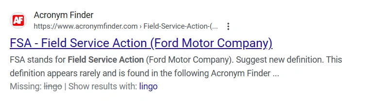

I know CSP but what is an FSA?
I wonder if this means they aren't to replace the battery modules now if the pinpoint cell test shows it out of spec?? (Mine has been scheduled for 3 weeks to be replaced "soon").
Field Service Action.
In this case it means don't do the current powertrain updates because we need to fix the powertrain software first.

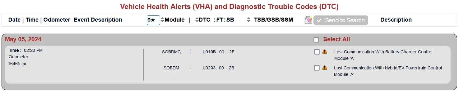

I can tell you that those of us who have done the most recent powertrain updates ourselves have been stuck with a daily DTC for the SOBDM and SOBDMC that won't clear. Truck is driveable, but obviously this condition is 'sub-optimal'.
Ford F-150 Lightning CSP-23B57 for High Voltage Battery Notice SOBDM_SOBDMC
