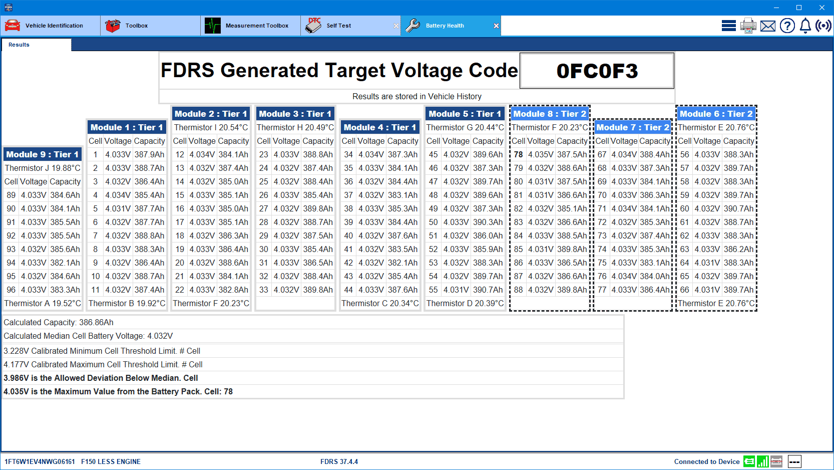

Was gonna do the ACM update this morning but the OTA process beat me to it (by literally minutes), so since I was there I thought I'd run a battery health check. This is what the result was:
Ford F-150 Lightning CSP-23B57 for High Voltage Battery Notice Lightning_Battery_Health_20-Sep-23
Ummm. Yeah! Looks good!.....🤷‍♂️ I guess?

So while I was re-reading the CSP it occurred to me that our vehicles may be reporting the battery health status to Ford and so they would know if we had a bad cell(s) or not. That would make sense.
That has got to be the case. I was called and emailed by the Ford BEV Team back on June 26 that I had a battery module "not performing as expected". As it turned out, two modules were replaced. I never received an error code at my truck or FordPass app.

Personally, I would be keeping an eye on module 8 to see if that deviation continues to grow at various SOCs. Keep in mind it is at the tail end of the modules in series, so it is likely to have greater deviation.
Are you sitting at 90% useable SOC right now?
I'm going to try and run my health check this weekend. Should I update the BECM module before I run it?
I always charge to 90%.
I did the powertrain updates that showed up recently and that included the BECM. I ran the health check with all available updates done.
